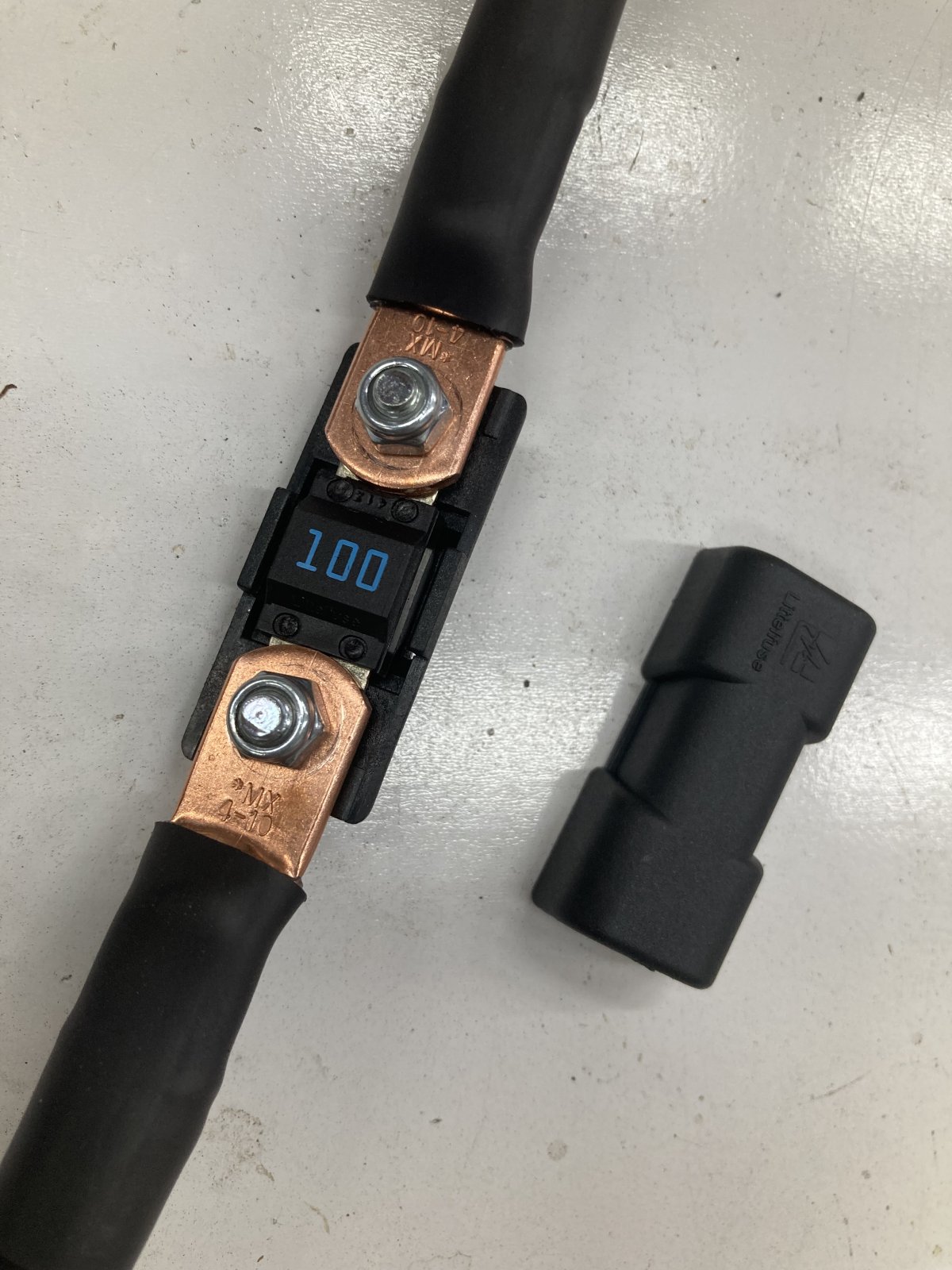

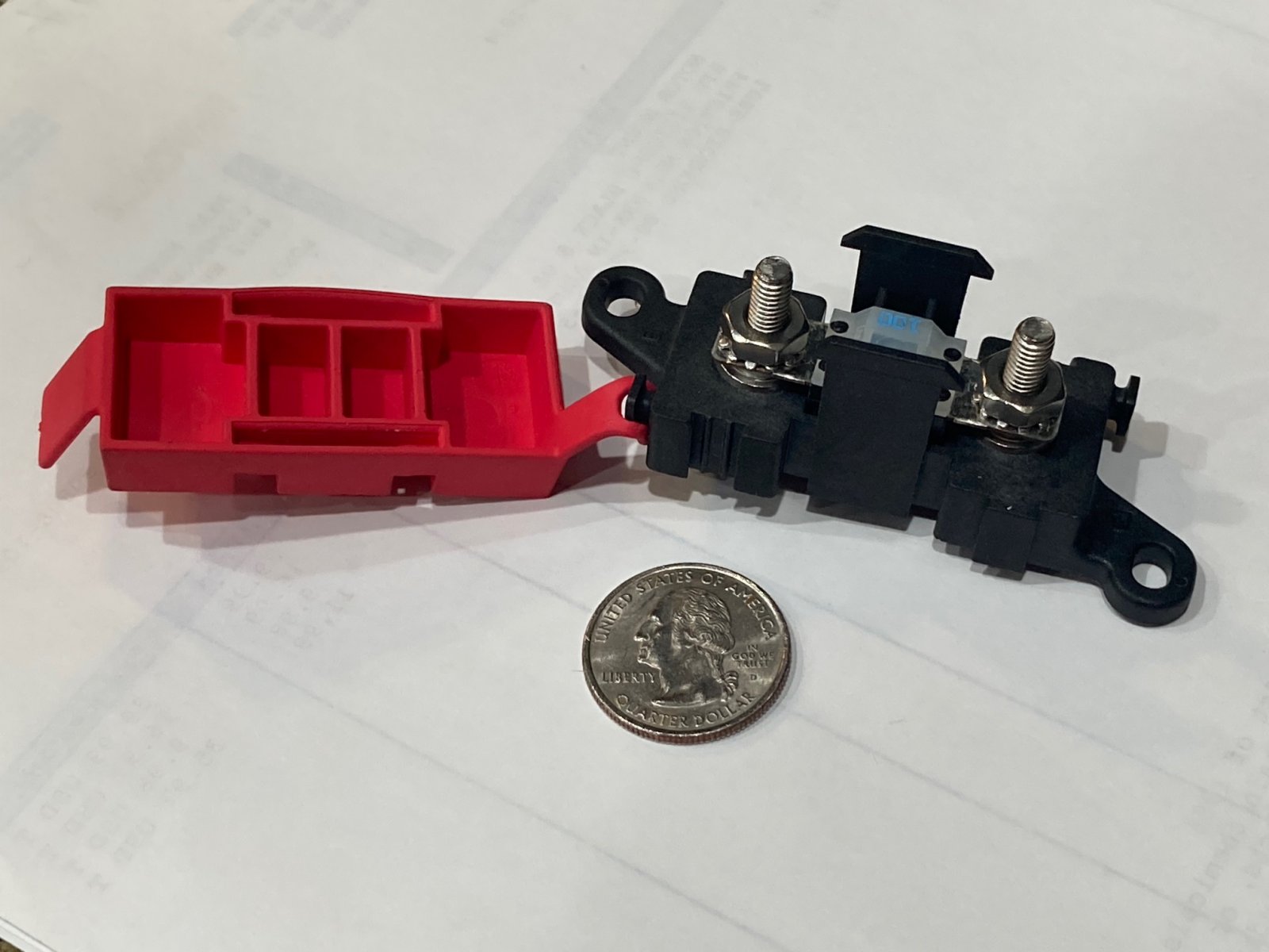

    This is how I would do it...
    Appropriately sized battery cable from battery to starter.
    #4 AWG wire from alternator to starter with 100 amp MIDI fuse mounted in between like so...
    and a 100 amp MIDI fuse like this...
    ...between battery or starter terminal and fuse panel with #8 AWG feeding the fuse and two #10 AWG from the fuse feeding the fuse panel (if it requires two feeders) or a single #8 AWG feeding the fuse panel.
    I can draw it up for you if that's too confusing and I also offer all the parts mentioned. Let me know if I can help!

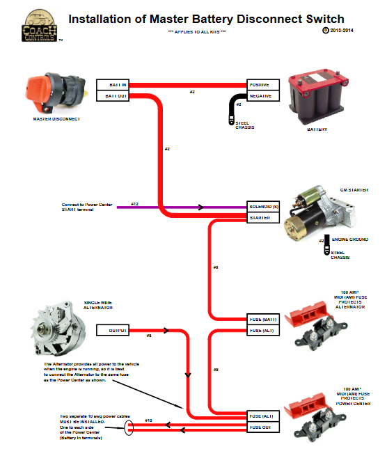

    Why fuse the wire between the alternator output and the starter terminal? What happens if that fuse blows/opens? Is the wire on either side of the fuse no longer hot? What happens with the alternator if that fuse blows?

    This kit has the same fault, the output from the alternator is fused. All this is doing is adding a potential problem, it is not protecting anything. With that kit you need to eliminate the first 100 amp fuse, and then you need to run the alternator output all the way to the starter solenoid terminal.

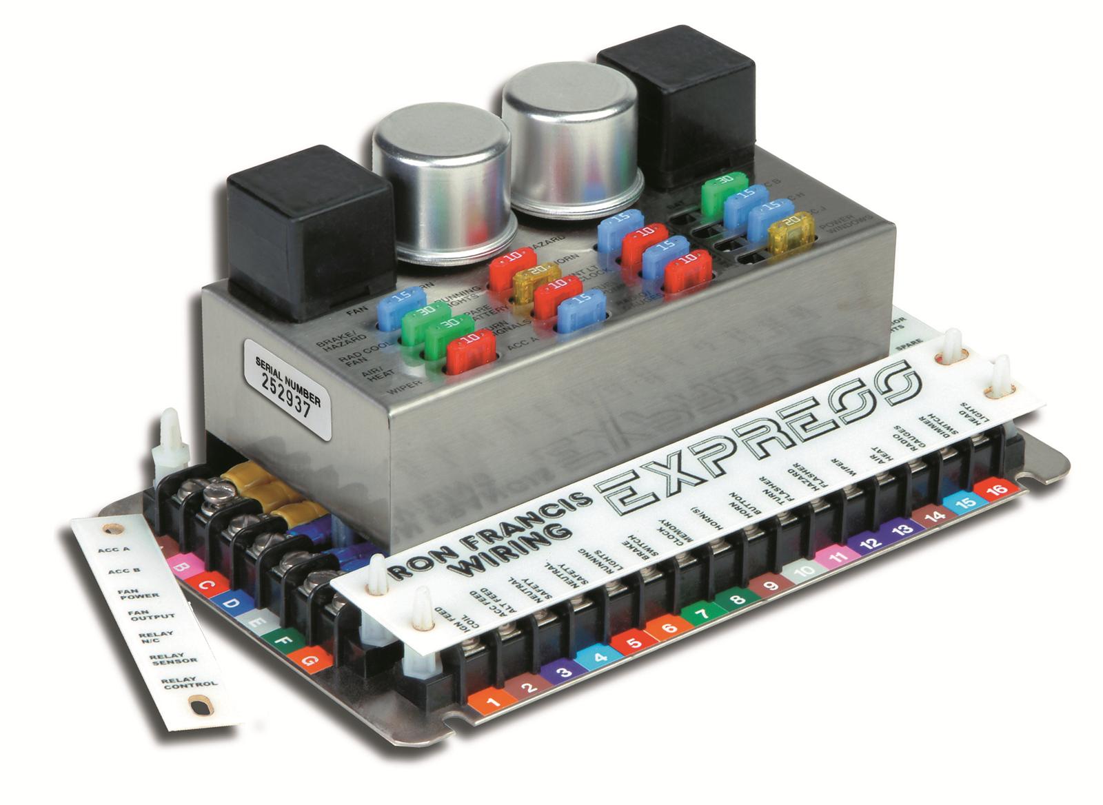

    I went though all those pages too and have too say that that I would far prefer that you could disconnect any unneeded wires at the fuse block.
    They are spendy in comparison to Painless but one thing I always liked about the Ron Francis fuse blocks is that you connect each wire to the fuse block yourself one at a time. A bit more work and for some a bit more clutter but you don't cut wires you just don't connect them in the first place. RF wiring.jpg

    The fuse blows before the wire is overloaded. Condition? Voltage regulator fails, ground short in the harness, etc.
    Both. The fuse in the alternator wire protects the entire system if the voltage regulator fails, etc. The fuse between the battery and the fuse panel protects the entire system.
    To protect the system if the voltage regulator fails. Consider modern alternators that can produce upwards of 200 amps. That's alot for a 10 AWG wire to handle if something goes awry. If the fuse blows, the rest of the system is protected. Yes. Nothing.
    That is not a fault. It protects the entire system from a potential amperage overload resulting from an alternator failure. A fuse in the alternator circuit is industry standard.

    This controversial harness [below] is in reality quite clever
    The battery draw while recharging is limited to 40a [480w] after cranking the engine because of the 8g wire
    And this is fuse protected both directions [shown as a maxi-fuse]
    But the Alt can supply 2 x 30a [720w] via the 960 and the 915/915 combined
    so if the battery is drawing 480w recharging there is a surplus supply of 240w to run the vehicle.
    If the draw of running the vehicle is ma**ed out at 720w [eg A/C , sub-amps stereo , headlights etc etc] it can be supplied via 915 and the 960/916 combo
    So the path of electricity on the 916 wire can change direction [depending on demand]
    If the car drawing 720w [max] off all the accessories, this leaves no surplus to recharge the battery.
    90% of the time the Alt is just keeping the battery "topped up" and also running the accessories at the same time.
    If you wanted to improve the max draw from the alt , then use the Hotrodder's "More's Law" approach by increasing the size of the 960 wire [which isn't needed]

    Yes, but there is a difference between using a fusible link at the starter terminal, and remote mounting a fuse. If the fusible link blows, the line is dead, period. If the inline fuse blows both sides of the wire remain hot. The inline fuse adds at least 3 potential failure points, both cable connections to the fuse and the fuse itself. And I do recall at least one post here on the HAMB of a member who had an inline fuse fail on him, at night, miles from home. He was able to troubleshoot it and byp*** it and make it home, but the point is, it does add a potential failure point.

    Wrong. If there is a failure in continuity between the alt output and the battery, such as a disconnection between either cable end at the fuse, or at the fuse itself, it is the equivalent of disconnecting the battery. If this happens when the engine is running it can cause a very high voltage spike that can damage any other components in the system; as well as damage the diodes in the alternator.
    Done using a fusible link at the starter terminal. Not the same thing as remotely mounting an inline fuse.

    Here are a couple ways it's being done in the industry...
    https://www.painlessperformance.com/wc/drawings/alternators/Battery Power - Midi Fuse Schematic.pdf
    https://www.americanautowire.com/media/productattachments/files/downloads/92972151 510475 IN 0.0.pdf
    American Autowire recently changed their kits over from using fusible links and now use the fused setup. When one fails (blows) the result is the same, but a fuse is easier to replace than a fusible link. That's after one diagnoses the issue.

    The fusible link doesn't have multiple potential sources of failure. The inline fuse does. Nuts holding the cables to the fuse vibrate loose; corrosion builds between the cable ends and the fuse terminals, the fuse itself can loose continuity to the holder. These things can and do happen, no matter how remote you might say it is. The point is, you're inserting a potential point of failure into the system, and I'm not sure the protection the fuse offers (in the case of a regulator failure that causes the alternator to go to full output) exceeds the potential for failure it introduces. Maybe a better solution is to size the output of the alternator and the wire between the alternator output and the starter terminal more appropriately to the needs of the installation.

    The fusible link itself is the failure. One little melted wire failure leaving you stranded if/when it fails/trips unless you carry wire strippers, crimpers, and an extra fusible link. And that's ***uming the fusible link, during its literal meltdown didn't damage anything else.
    What part of the 4AWG wire that I posted seem inappropriate to the application and how does increasing the size protect the circuit from failure? Using your logic, a 21 circuit fuse panel must have hundreds of points of failure. It's a wonder these cars even run at all! :confused:
    Johhny, what is your alternator rated at for peak amps? That's what you need to build to. And the fact that they can fail and "runaway" can lead to component damage. It's not the 30 amps that the system specs out at, it's the alternator's spec and the risk of damge if something fails and the output spikes.

    Any connection. Spliced. Soldered or clamped is a source for potential failure . Excluding battery main cables , every circuit needs a fuse/ fusible link .
