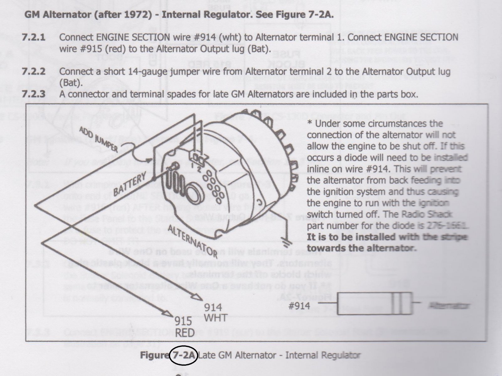

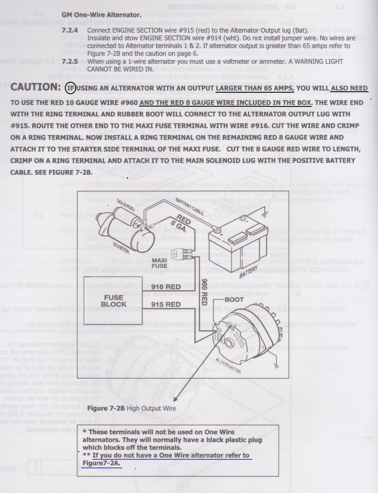

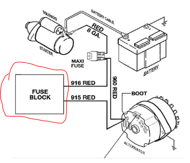

    Since the thread started with this diagram, and thats exactly the diagram in my installation manual, I'd like to see some discussion about this specific application. We have two distinctly opposing opinions about whether this circuit is ingenuious or disasterous.
    Here are some additional notes which are included in the installation manual.

    In that figure 7.2.2 that short jumper wire will make the alternator work, but it will sense voltage very close to the alternator and keep the battery just a little off full charge. I did many of these alternator up grades . I usually took that wire back to the accessories side of the ignition switch or direct to the battery. Just a minor thing, but it is a thing!

    If that fusible link blows, you have other problems, you're still going to be stranded. A competent mechanic can repair the blown link and get going, it's the regulator failure that caused it that's going to be the problem.
    I never said the 4 awg wire was inappropriate. In the OP of this thread it was mentioned that often these kits use under sized wires for this, my comment was just addressing that concern. My comment on your post is the installation of the fuse itself and the inherant potentail for failure it introduces. I don't understand why this is so complicated for you. And yes, problems occur in circuits all the time due to connections at a fuse box, or a fuse failure, corrosion between the fuse and the terminals, etc, etc, etc. Anyone dealing with old cars for any length of time has dealt with that at least once, most of us multiple times. :confused:
    Tell me, what happens if the regulator fails and the alternator goes to full output (how often does that happen anyway?)? Does that fuse stop the over voltage condition from hitting the rest of the circuits in the car? Not if the alterntor output is going straight to the fuse box it doesn't. And all of the kit schematics shown so far are designed that. So what is it protecting? The battery is the only thing left. Hopefully the car will have a voltmeter installed, and the driver will notice the over charge condition before the battery fails. I've seen batteries take an awful lot of abuse, even swell up, and not fail. I've seen batteries explode before too, but not from overcharging but from an ac***ulation of gas due to insufficient venting, and an ignition source ignites the gas.

    The Painless drawing definitely fails to protect the rest of the vehicle from the alternator, which is why I wouldn't do it that way. If you read my initial post, I stated the 4AWG wire with the fuse mates the alternator to the starter. The fuse panel is fed either off the same starter lug or the battery depending on install with another 100AMP fuse in between those two connections. The alternator is isolated from the rest of the harness via the fuse.

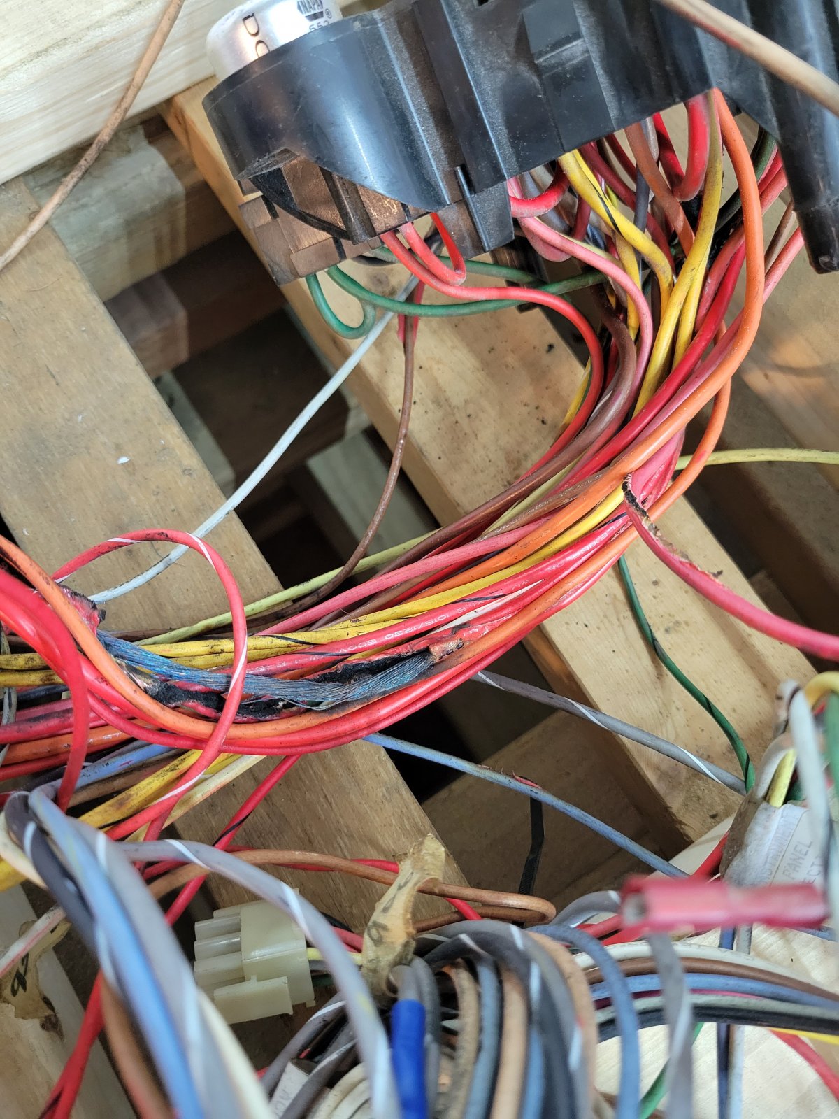

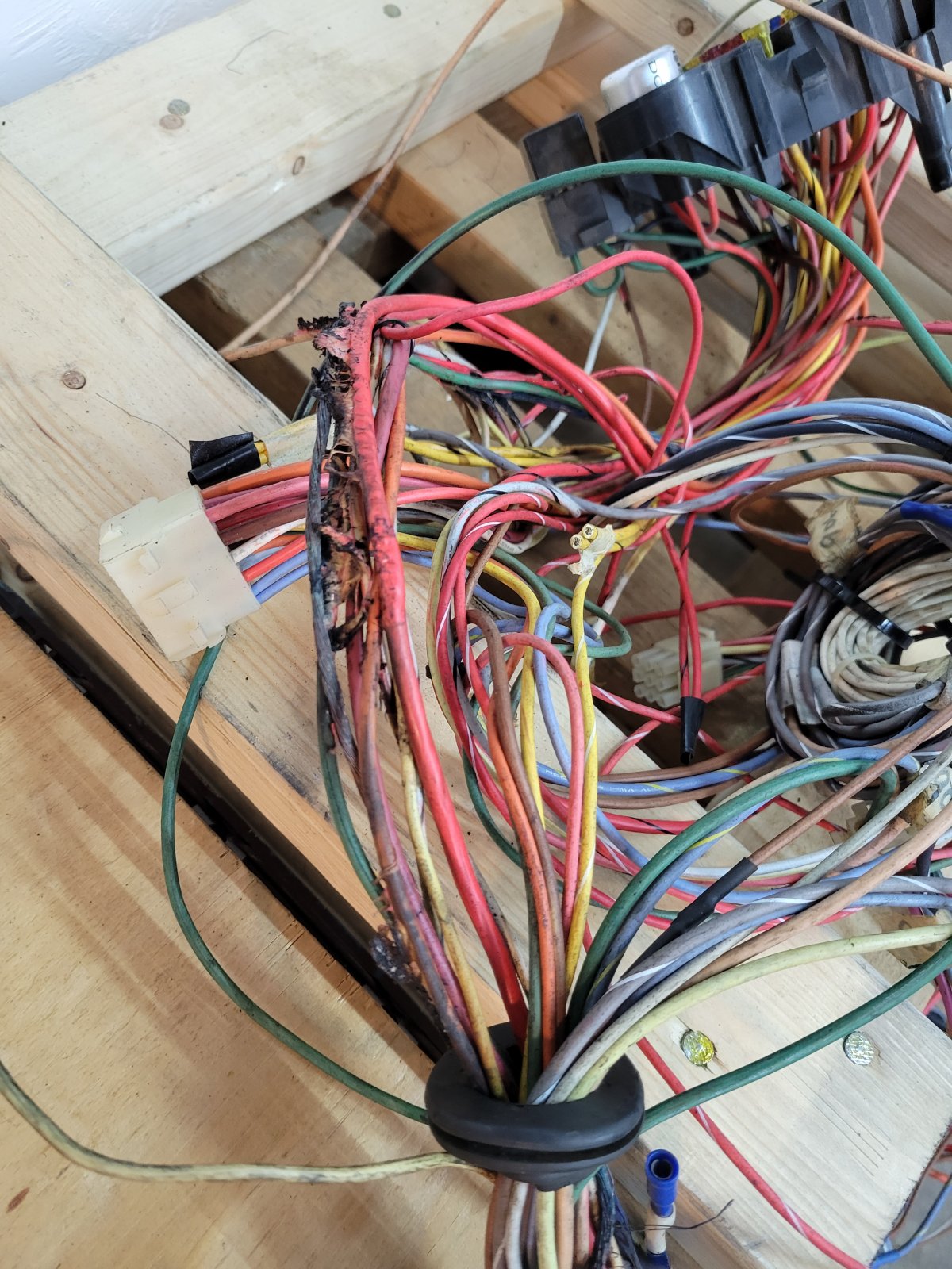

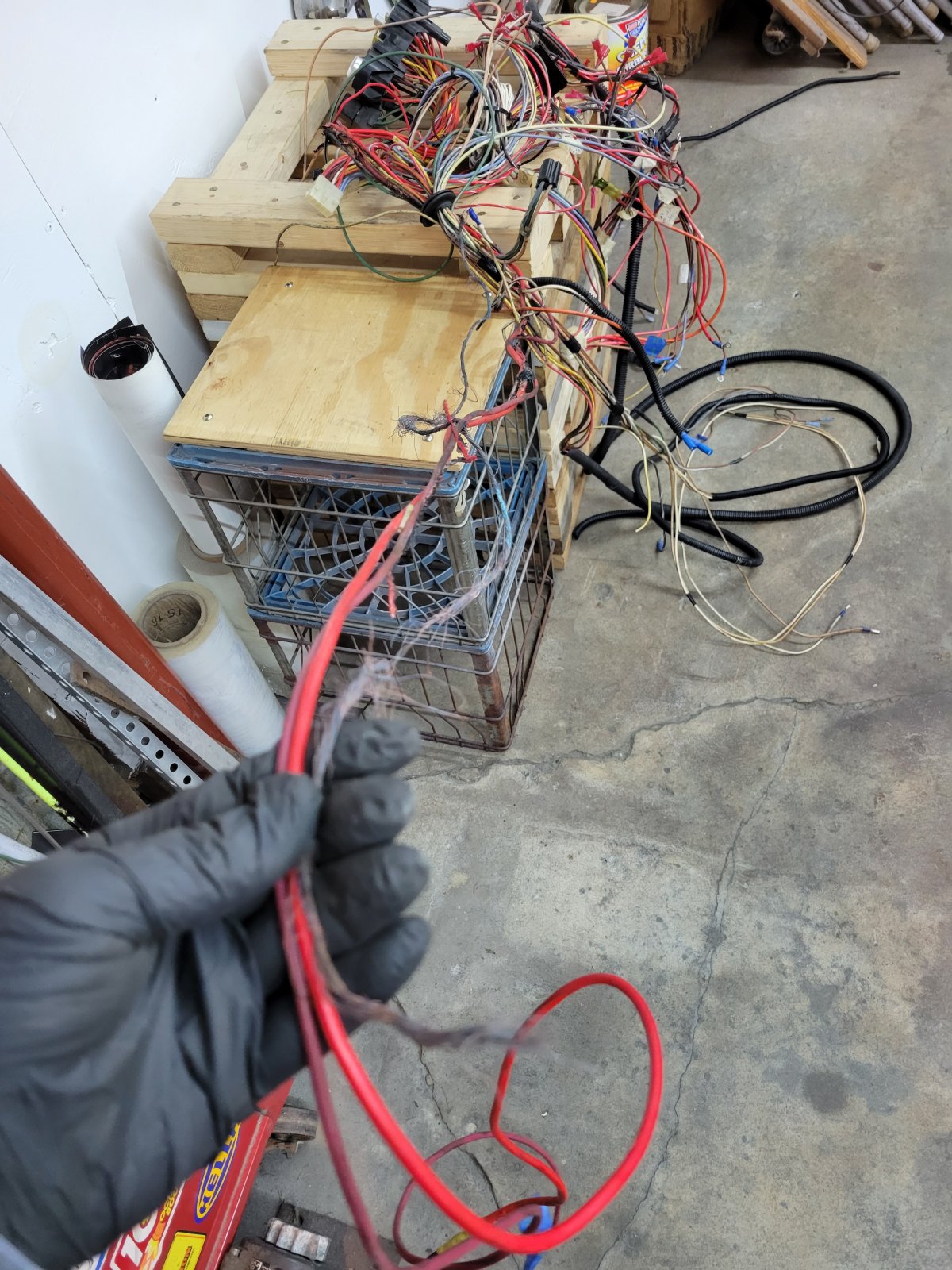

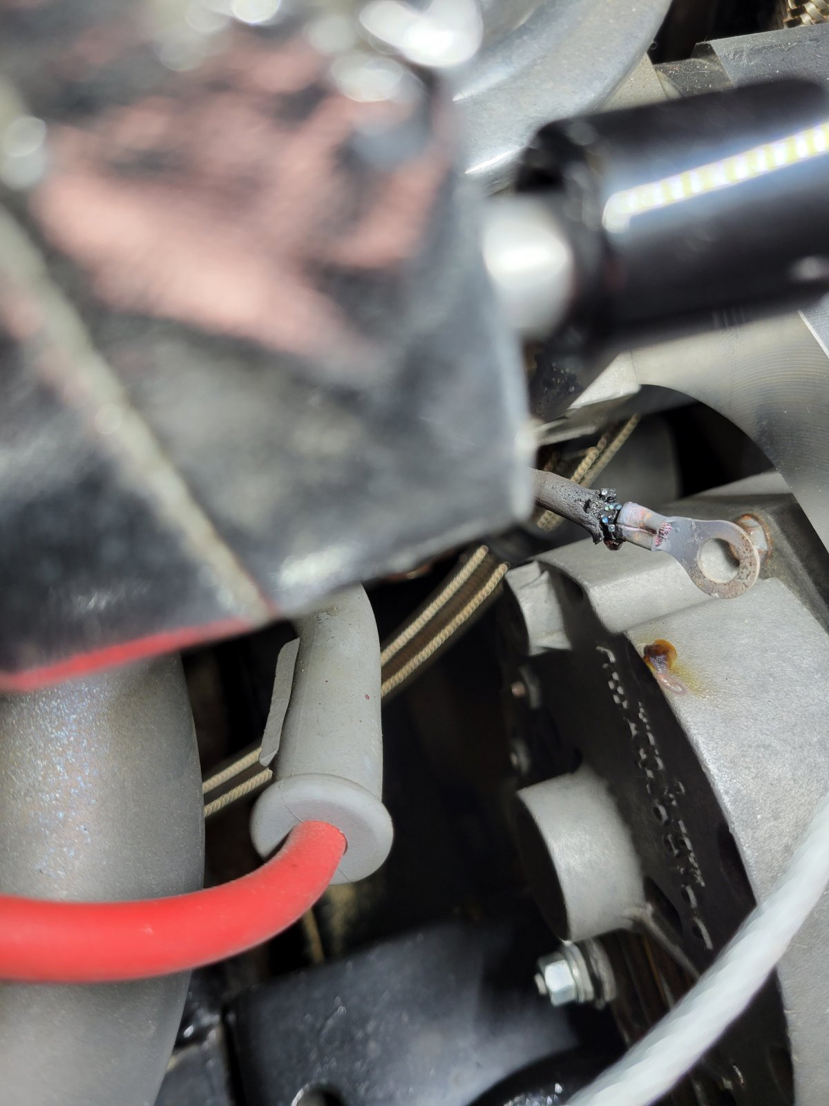

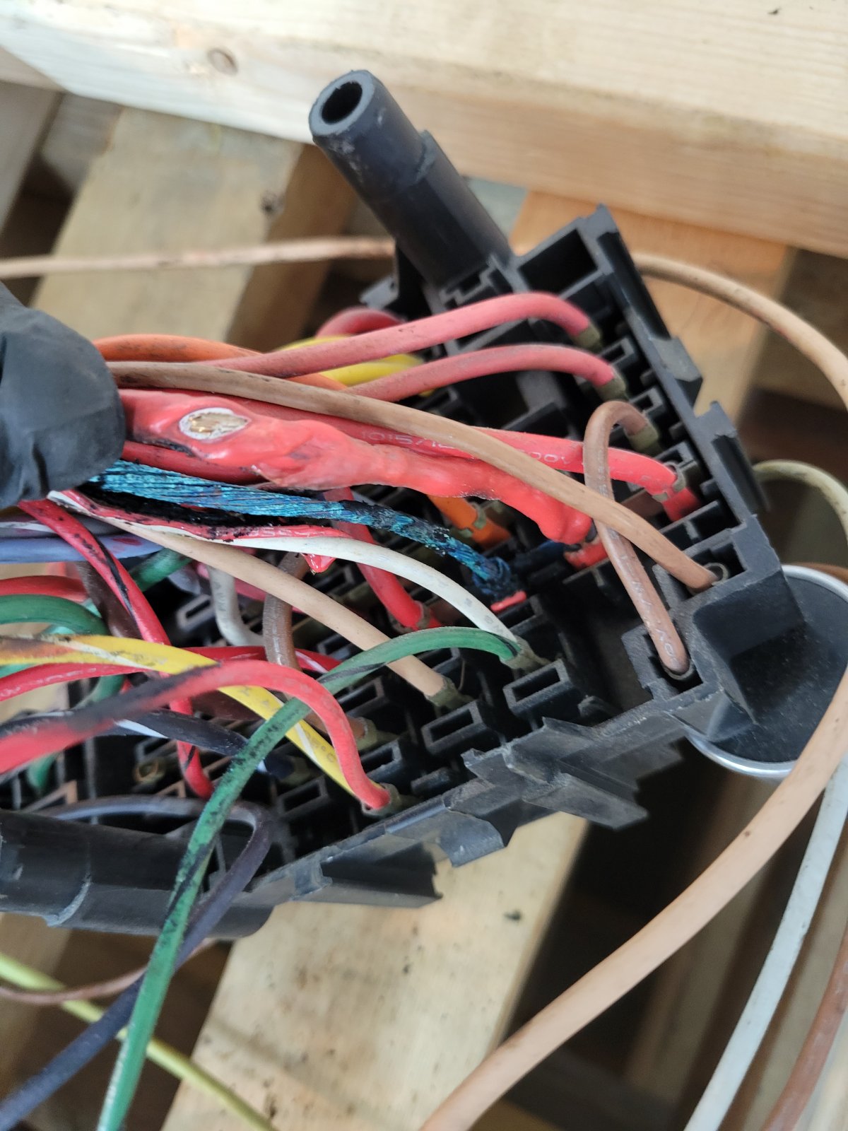

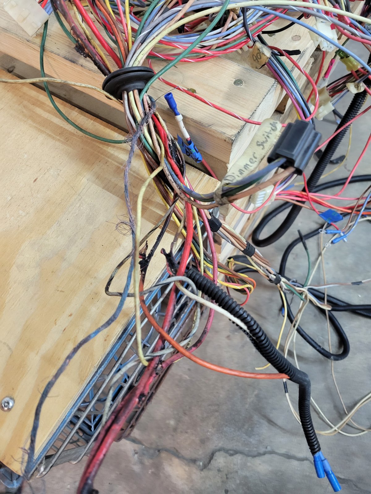

    I just yanked out my harness and still don't understand why the fuse didn't pop which would've stopped the power in the wire ???
    The wire from the alternator was disconnected and shorted itself on the alternator housing, this mess took all of 30 seconds total before I could get the battery disconnected.
    Started from here at the alternator, turned the wire glowing red hot and melted everything it touched all the way back into the fuse box.

  11. There is no fuse on that wire. That's one of the failings of these designs. And with however many cold cranking amps available at the battery, it doesn't take long for that to happen.

    Everything in the vehicle [after the Alternator /Battery] is routed via the fuse block
    As long as everything in the fuse block doesn't exceed 72ow when everything is switched on at the same time , the Alt harness should handle it.
    If you add up the values of everything from the fuse block ,and add 600w for the sound system
    If this total amount exceeds 720w then you will need to upgrade the 960 and 915/916 wires
    For example if the car normally draws 400w [without the stereo] and you add 600w sound system the total is now 1000w [1000w + 12v = 83.33a]
    Because there is 2 feeds to the fuse block you will need 41.66a rated wires for all these 3 wires [45a]
    and an Alt capable of feeding this and sending surplus to the battery [90a]
  13. You're ***uming those wires are fused at the panel... they're not... Look at Swade's post.

    Is there a fuse labeled "alternator" on your fuse panel. I highly doubt it and there's no fuse between the alternator and every thing else. This is a perfect example supporting the approach I mentioned earlier in the thread. Does that wire need a fuse in it? Not until it does...

    But his system does have the fuseable link, suppling the fuse panel. Maybe the fuseable link had a higher capacity than the wire! I have seen many OEM fuseable links burn out with no damage to the system on OEM uinits. Just my observation.

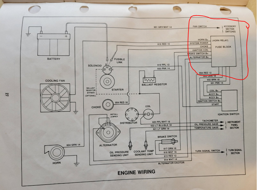

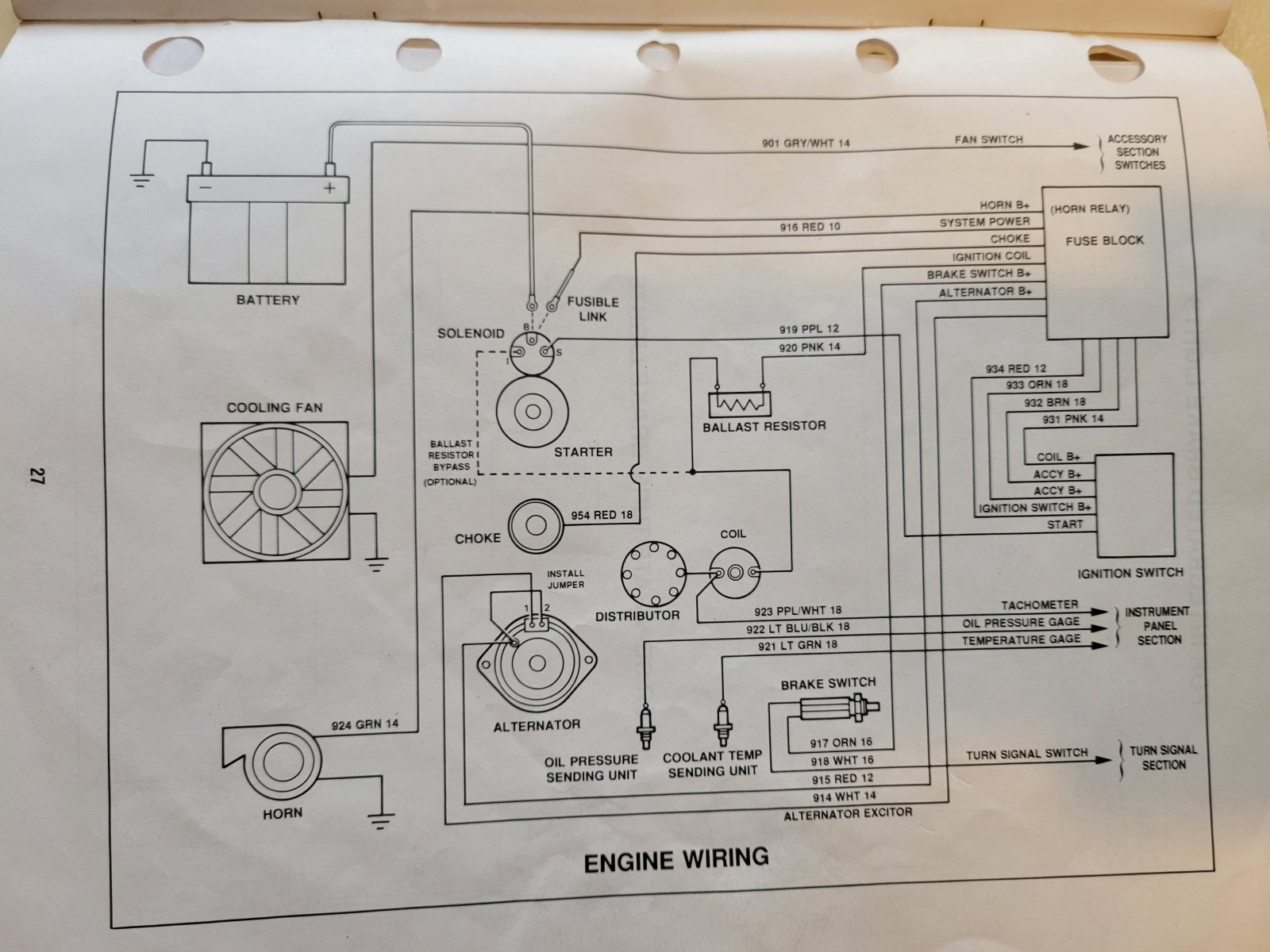

    Kerrynzl
    You're ***uming they're Not.
    This is the schematic from Swade's post [showing the same "lack of" detail that Painless have shown]
    Professional harness manufacturers are not F***en stupid with their specialized products.
    Why would they add a Fuse-Block then hang all the feeds off the unfused side? [they could simply save $$$ and use a Bus Bar]
    The original statement was the accessories were unfused between the Alt and the Accesories [not the Battery and the accessories] which would be true.
    But this is also ***uming that Painless Wiring is a bunch of idiots connecting all the accessories to the unfused side of the Fuse Block.
  18. Think it through... The wire that burned up was the output from the alternator. It went to the panel, not directly to the battery like it should. In order for it to charge, there has to be an internal connection and wire going to the battery in the panel.
    And yes, it appears they can be that effing stupid....

    SO......where does someone add a Fuse or Breaker that will protect the rest of the system from the alternator?
    I plan to have a basic system with additions of A/C, electric fuel pump, and possibly electric fans. Also may opt for electric windows. No radio, so no big useless sound system. Probably some electric cut outs as well....like those sounds a lot better. I figure I'll want more than 60 amps even if a 60 amp alternator can handle it. Probably looking at an 80-100 amp alternator.
    From what I have been able to grasp is that the problem is not having an alternator disconnect of some kind in the basic engine starting circuit..........but can also be problematic after starting if the alternator generates uncontrolled current.
    IF (and that's a big if) I got that anywhere near close to right...........where and how can I insert a breaker (or a fuze) that protects everything from the alternator? If I got it wrong......well I admit to being electrically challenged:confused:

    It could be an over 65a Alt trying to charge a flat battery via the over-rated Maxi Fuse
    Add to that the load from the accessories [on the output side of the fuse block]
    any one of the above wires would get hot and lose it's efficiency [then the weakest link will Chernobyl itself]
    A short circuit in the Alternator can also cause this.
    The problem is the maxi fuse [and maybe a mismatched Alternator if there is too much charge]
