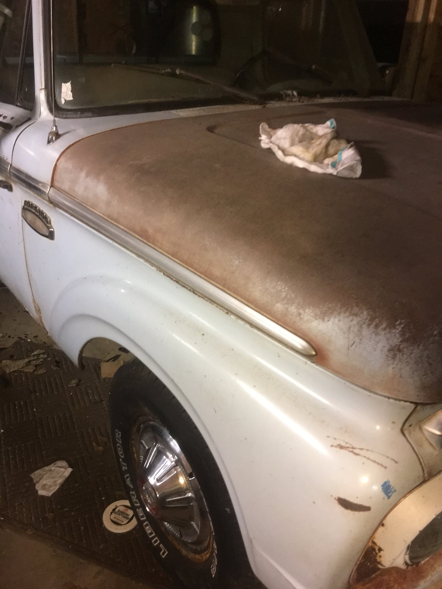

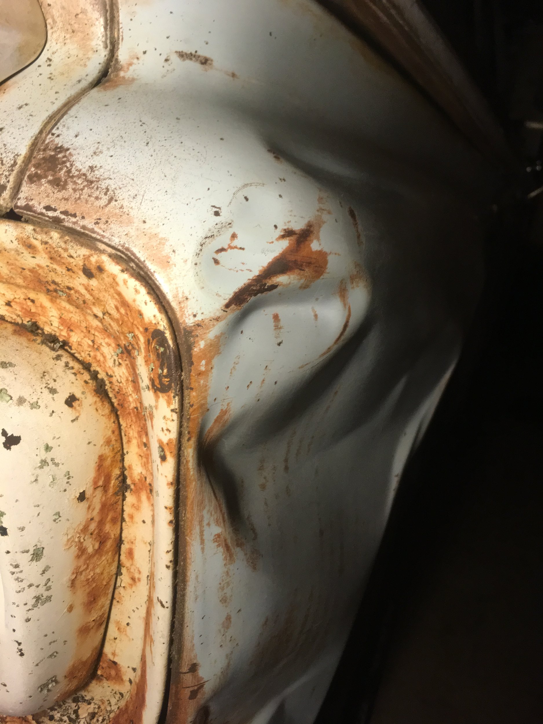

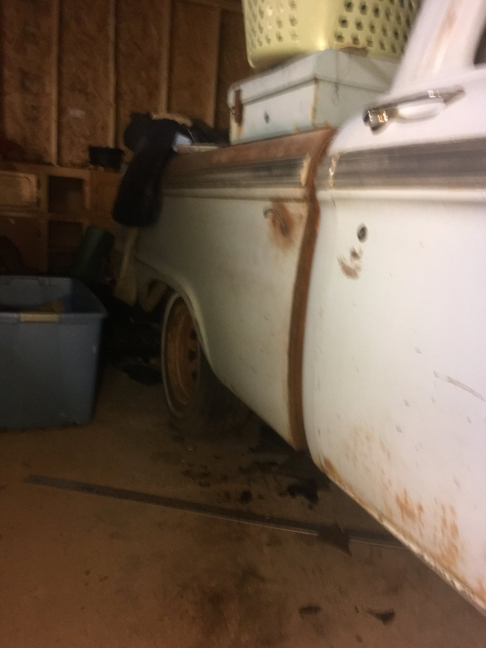

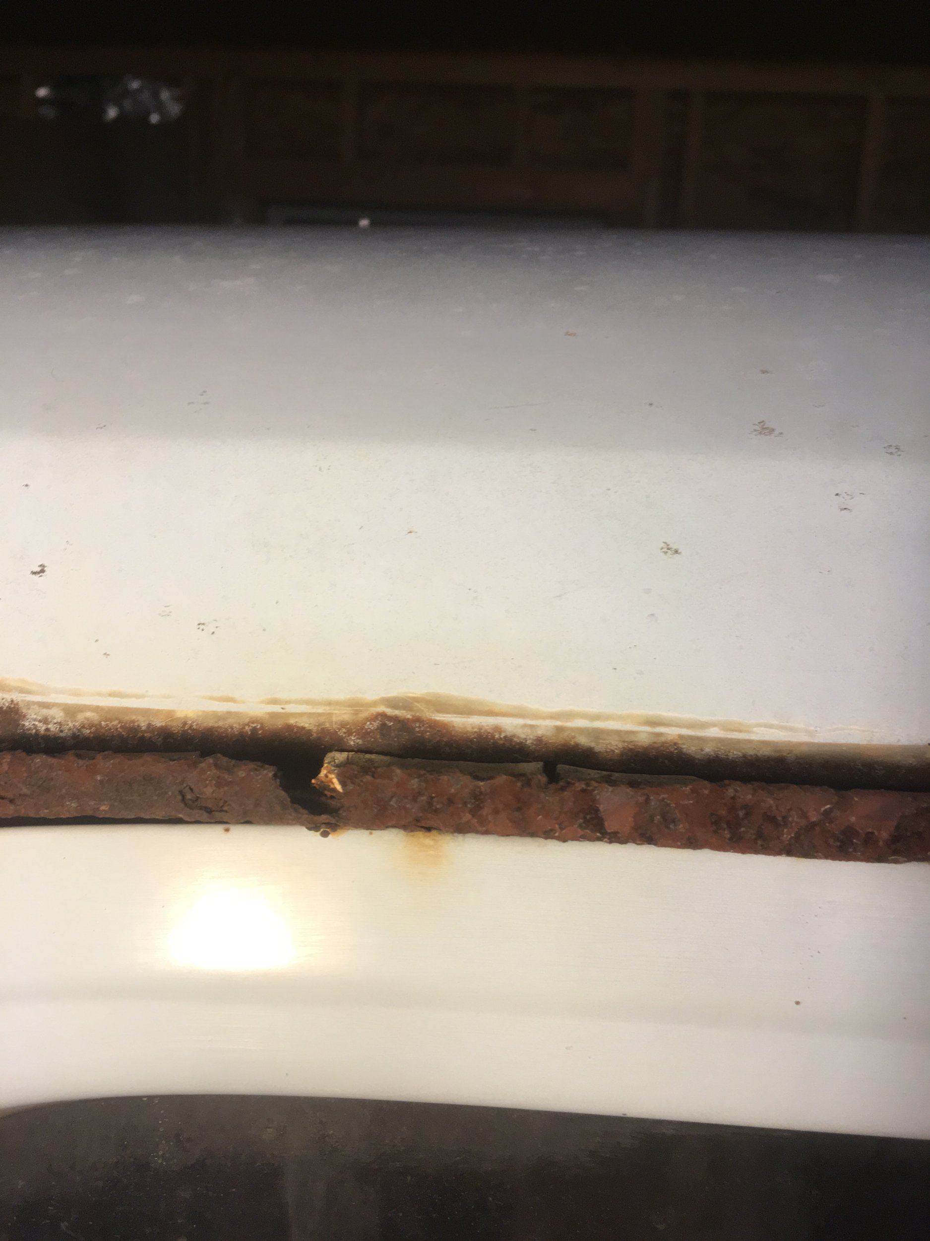

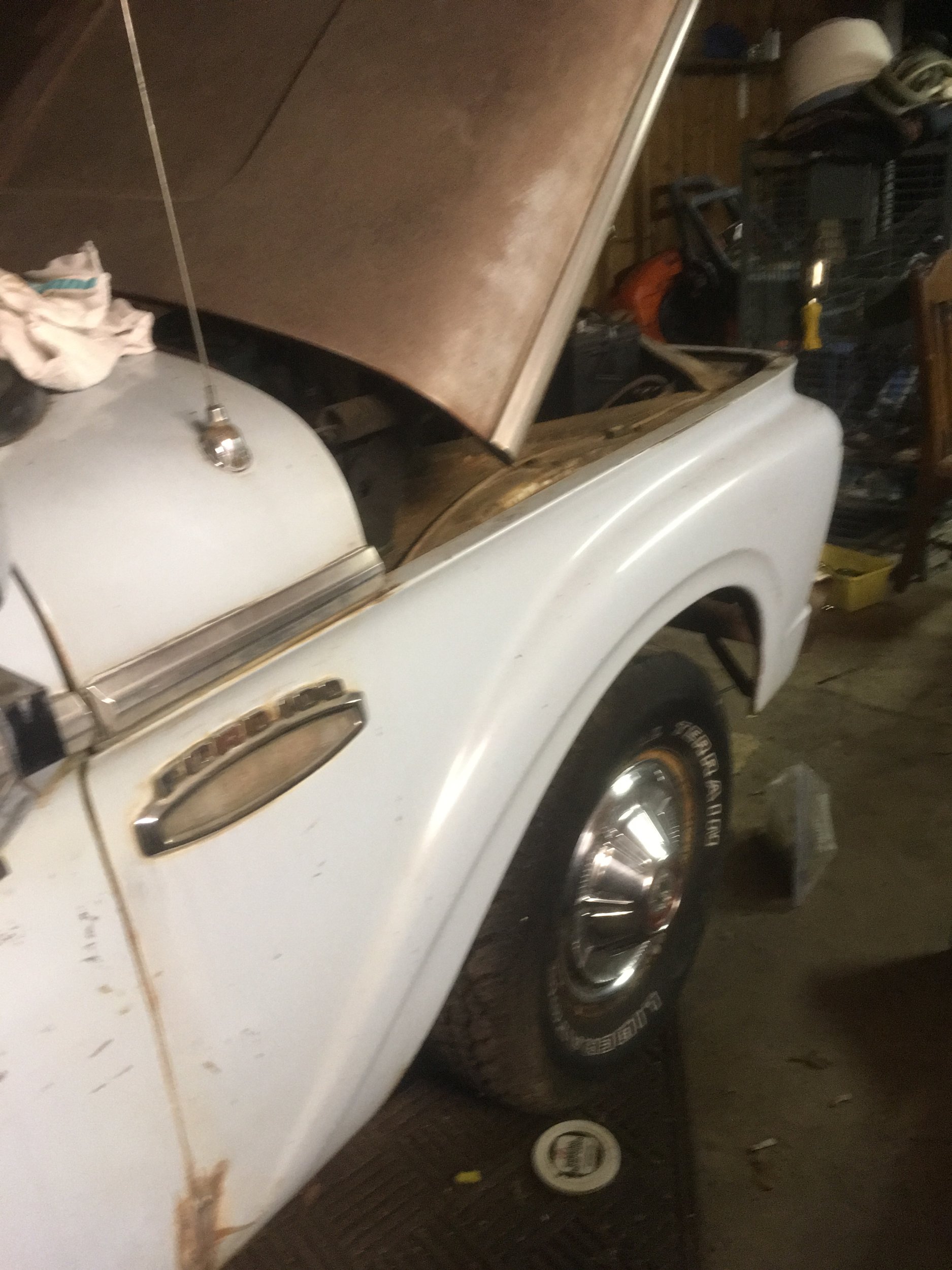

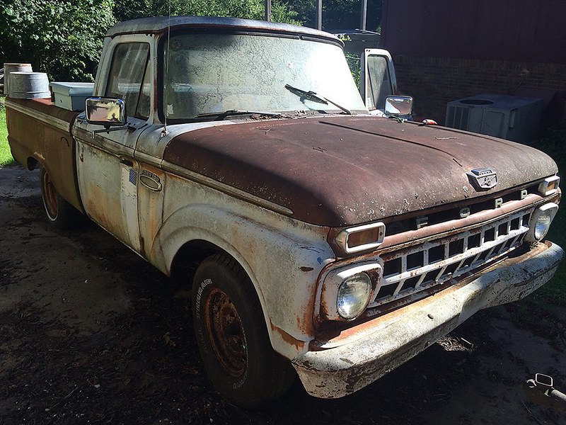

    OK these photos may give you an idea of what I have to work with.
    Please this is not a debate about patina vs paint. This about trying to preserve and enhance what’s there with limitations.
    My daughter’s first vehicle was a very nice early 90s truck. Honestly I would have loved to have it. It was a red SWB standard cab Z71.
    As you know red fades badly. Early 90s GM paint was not the best.
    On a very close inspection the roof top and hood were resprayed.
    It looked wonderful.
    A full restoration is out of the question for this old truck. It’s not going to happen and honestly, I like it like it is, but with just a little more durability as far as the finish.
    Again, it’s not restoration it’s preservation.
    I’m not talking about cleared pickled rust either.
    I like to eat pickles, not drive them.
    The only major body work I’m planning on is welding in a new drip rail above the p***enger door. I’m not worried about crumpled fender on the driver side.
    It also needs some metal work on the bed top.
    The hood and the top of the bedsides need repainting.
    The 90s truck I mentioned, it looked like it had a very thin mix.
    I was thinking, repainted hood, and bed tops with maybe a very thin mix on the sides.
    Do you see what I’m going for?
    Any ideas or recommendations?
    Thanks.

    Bang out the bigger dents and do an ok repair to them. Not a perfect repair. Don't worry about the little dents. Clean off the rust, prime and paint the truck with some single stage budget paint. (Not cheap paint!) Something mid priced. Don't take apart anything you do not have to. Think about 2 weekends worth of time. You should have less than $1000 in it. TCP gallon acrylic enamel paint kits are less than $200 each
    That would be a typical 1980's used truck repaint. Before we got so fussy about things.
    You will have a truck that will look nice going down the street. It will also be acceptable at a cruise night at the local ice cream stand.

    It wouldn't hurt it to just repaint the roof, hood and box above the trim line, but it probably will be obvious those panels were redone. Less so if you scrub the rust stains off the sides and buff it out, and touch up chips.
    Repaint the worst spots, clean up the rest and keep it waxed. Don't add more paint to the sides unless you're going to strip and straighten them.

    Also know that you can't just paint over surface rust. you have to get the rust out of every pit in the metal. If you don't it will just rust away and push the paint off and look worse than it does now

  11. The entire truck needs to be repainted .
    and that’s that.
    you can leave the dents , pound them out and smooth the body to a point your satisfied .
    looking at the pics , I think most of that rust would wipe off with CLR . Really does not look as bad as it looks .
    repaint it white with rustoleum ( tremclad) up here . I’ve painted a few winter beaters with tremclad and added reducer and hardner to the paint and had great results that lasted through harsh Ontario winters with ( in all honesty ****ty body work and prep )
    get the car oil sprayed once the paint work is done to slow down any future rust and it should look good for years to come .

    Give it a CLR wash and re evaluate the situation.

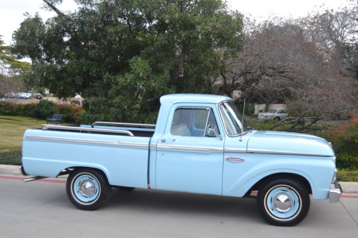

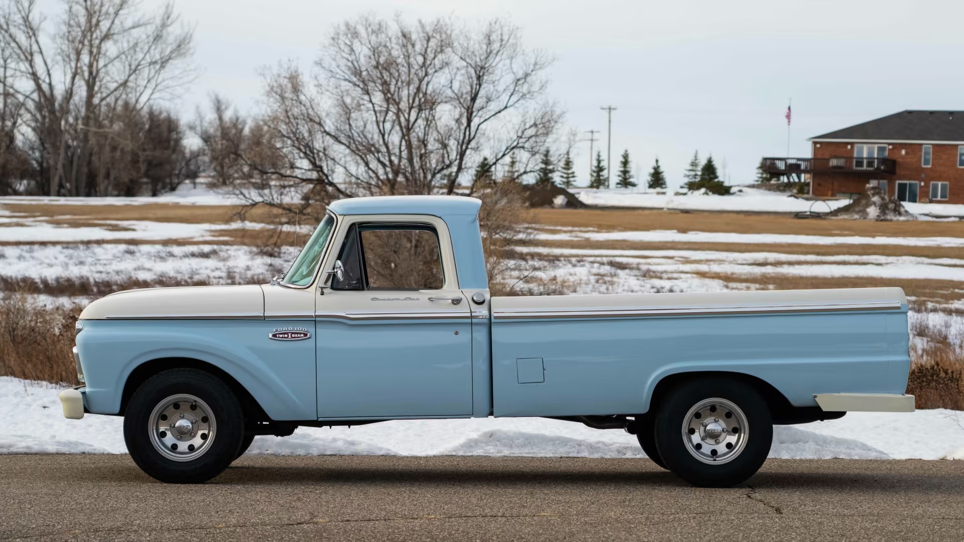

    This is how the truck looked when I got it.
    The bed was stained from the bed tops above the chrome trim. I’m sure there’s some micro cracking in the factory finish and it would have to be waxed really cared for.
    I thought the truck was white but it’s actually blue, Arcadian Blue. Arcadian Blue is a very pale blue.
    As far as any kind of paintwork other than a full re-paint, the only viable option is to repaint the hood cowl, door tops, cab stripe on the back of the cab, and the bed tops at the trim line for a two tone or trying to match the faded blue.
    The blue is so faded, making it 2 tone, Arcadian Blue and Wimbledon White would be very subtle.

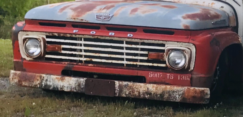

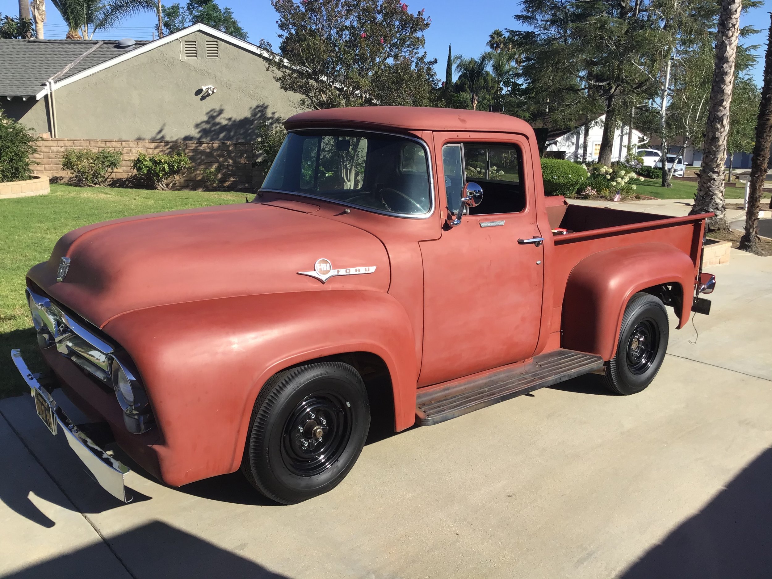

    looking at the photos posted I would suggest this. clean with CLR as was suggested, it will remove all the "brown". I would then make any repairs and prime the body work. I would then use Benjamin Moore's Satin Impervo alkyd enamel or the equivalent in the brand you prefer. Thinned and sprayed out in one smooth coat will give you the look you are after, won't cost that much and is user friendly.
    Before the "body experts" chime in. yes, the paint is not meant for automotive use, yes it is not the proper way to restore a truck, yes there are way better products out there.
