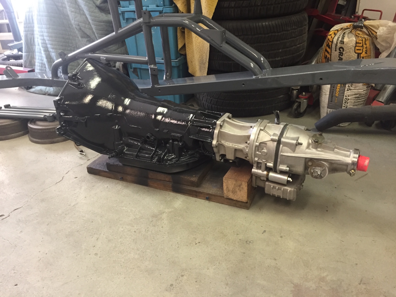

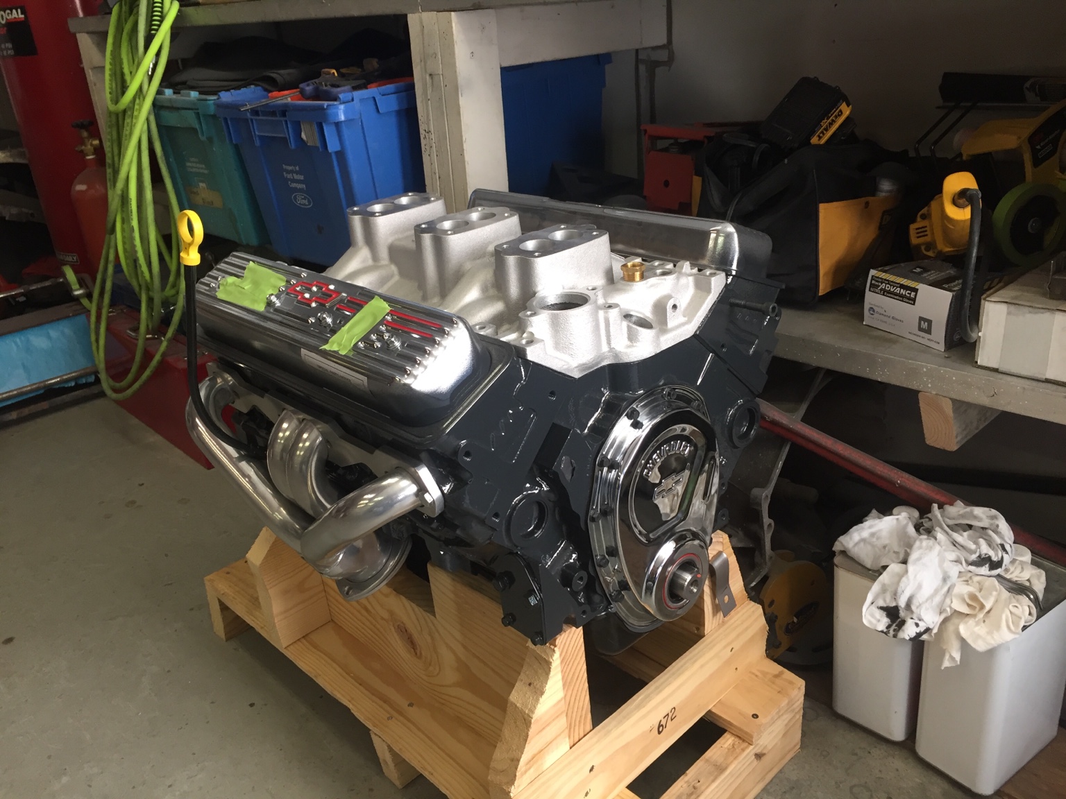

    CAN YOU POST SOME PICS OF YOUR ENGINE
    phantompjcoupe likes this.

    Definitely! I hope these post alright. Forgive the ugly valve covers, dipstick, etc. she needs to be dressed up a bit. I'll hit that this weekend.
    [​IMG][​IMG]
    tb33anda3rd likes this.

  20. That engine stand is a work of art as engine stands go. I'm used to a couple of old tires and a 2X4.:cool:
    phantompjcoupe and tb33anda3rd like this.

  22. phantompjcoupe
    Joined: Feb 15, 2012
    Posts: 48
    phantompjcoupe
    from chicago
    Haha
    It works great to be honest!
    I have 2 engine stands(real ones) being used as a rotisserie right now for the frame so I could paint it.
    The frame will be back on its wheels this weekend, and the engine will go on one stand so I can put all my goodies on it
