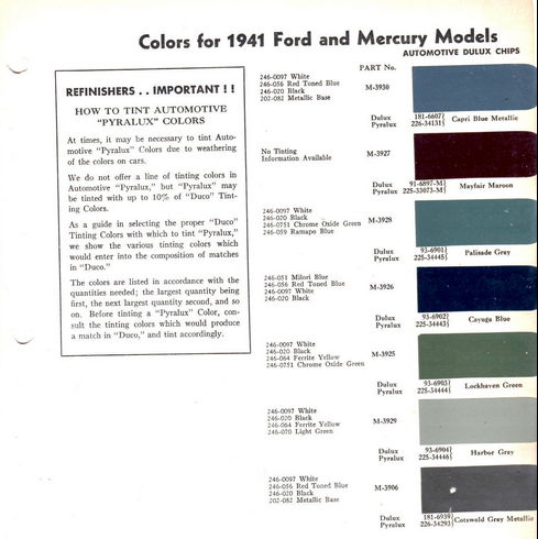

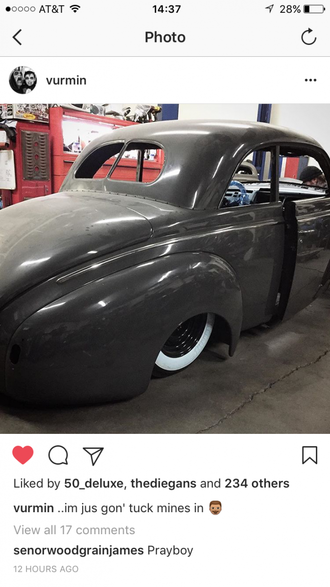

    Im trying to match a color called cotswold gray. Ford and mercury used the color in 40-41. Ive seen a solid and a poly version listed. Went to my local ppg dealer and she couldnt find it with all the codes i had pulled from paintref.com. She ended up calling ppg and they sent her a formula that was supposed to be close. I took it home and sprayed a test panel. Its way too brown. Not even close. Any ideas of who might be able to match this color? What about tcpglobal? Id have to buy a whole quart. Hate to do that if they cant come close to the color.
    Paint ref website
    Sample color
  2. TCP Global has a color library that covers thousands of makes way back .go to there web site and click on color library . You should find a formula there.. Good Luck

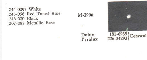

    This is formula, any good paint shop should

    You would think. I went to two local paint shops. With the correct codes.. One was a matrix dealer, the other a ppg dealer. Neither one could do it. I didnt have that formula though. Thanks! Ill try that
  6. the old formulas don't really work with the new tints.
    you can use the quart if it is wrong as a base or for any spot that doesn't show, so it won't be a waste if it is wrong.

    Is that the original paint on your Merc or a older repaint? What ppg gave you was a computer generated closest possible match matching their old toner formula to current epa friendly toner files . A total shot in the dark and if your car has been repainted , your chances of matching a factory formula to it are a million to 1 !! The formula mgtstumpy posted cannot be mixed because the toners are no longer available. Your going to need to find someone who is very good at tint and blending and mixing custom colors. Of course finding a person with this skill level is going to be very hard because most current painters do not tint and blend and most paint jobbers do not want to get envolved because it is time consuming and most customers do not want to cover the cost . good luck Larry

    Larry, the merc in the pic isnt mine. Im trying to pick a color to paint my roadster. I like this gray and another gray called tunis gray. Another early ford color. I spent hours at the ppg store trying to get a sample matching either of these colors. They are all either too light or too brown.
