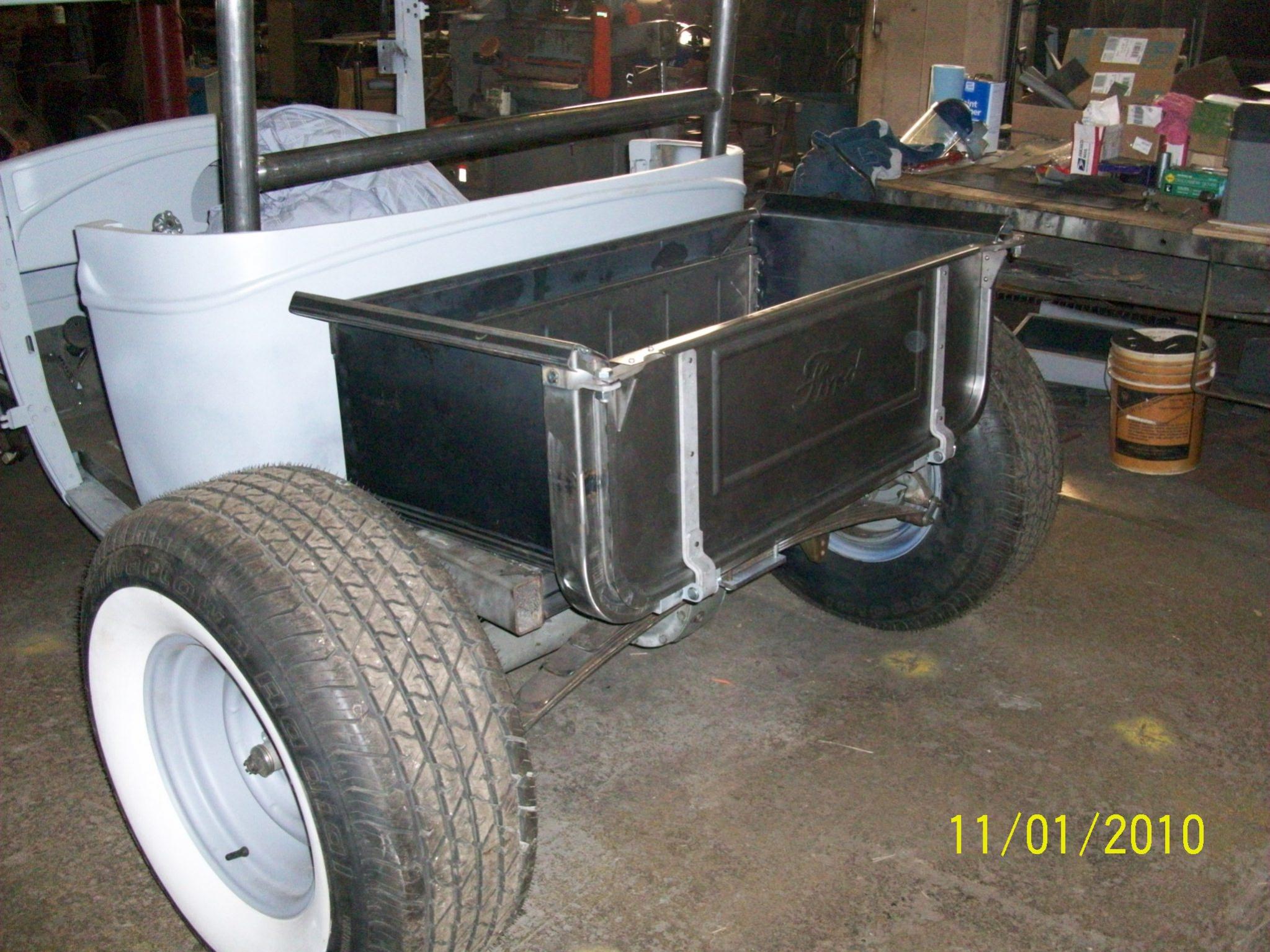

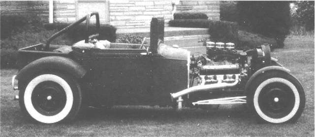

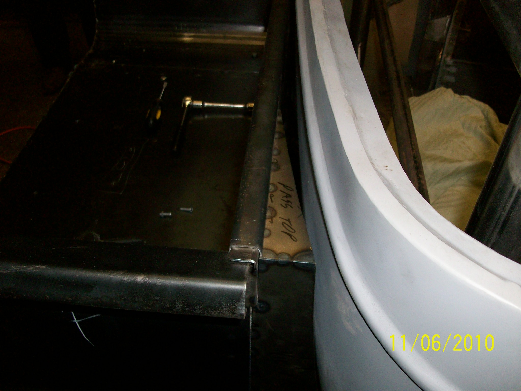

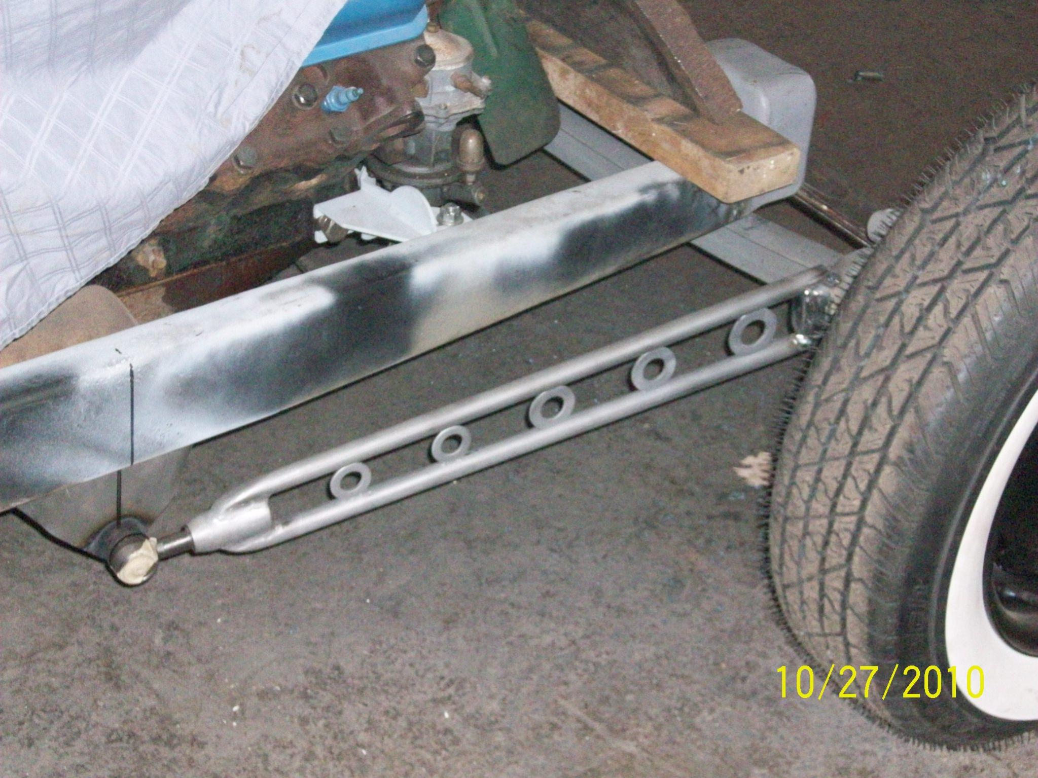

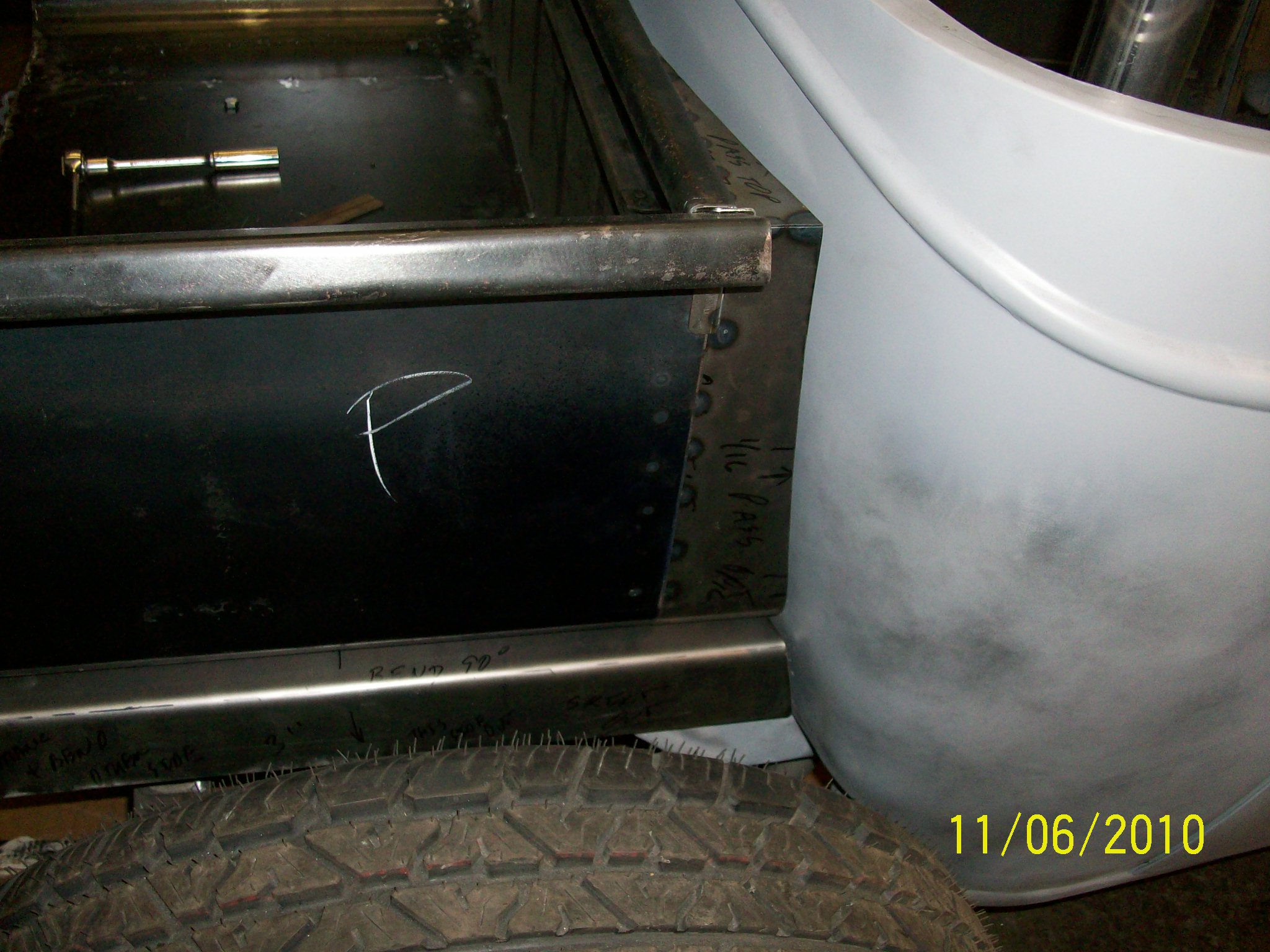

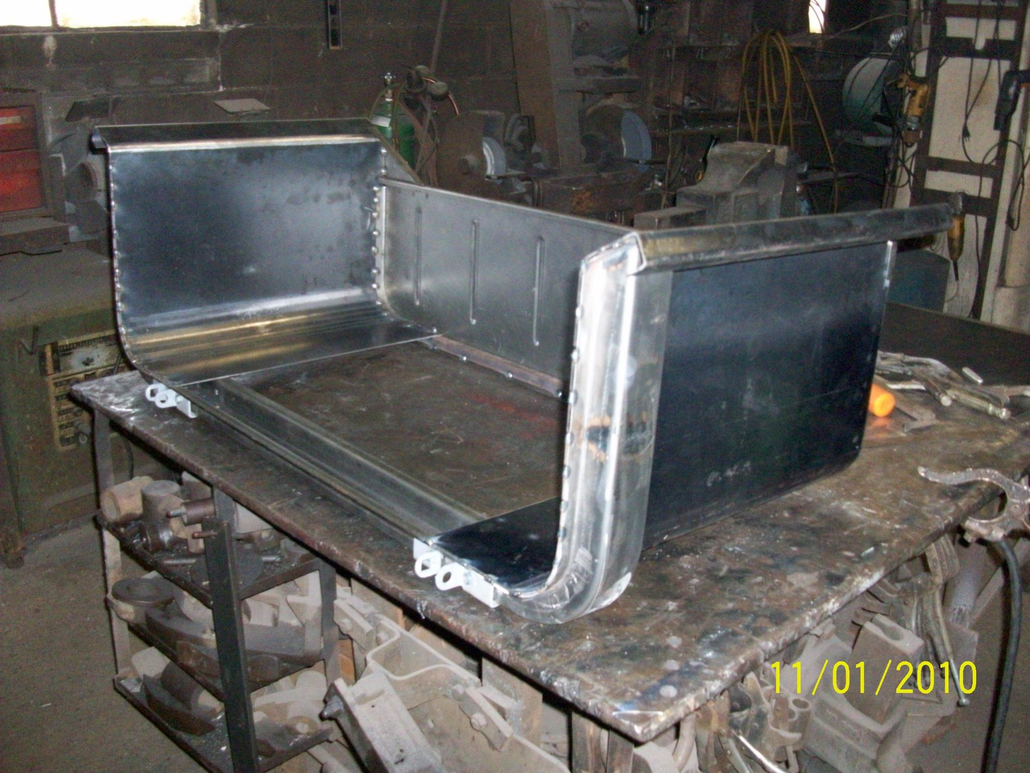

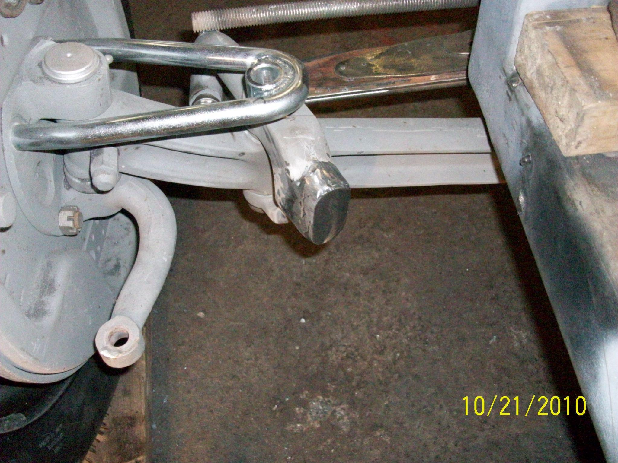

    Started with a '29 Ford 4 door sedan leather back. Now a 2 seater. In July it was a bare frame, today, I should be finished with mock up by Thanksgiving. My cousin and I have been working almost everyday on this project. This last photo is his car that I used to borrow back in the mid '60's when I was just 16. Of course he sold it and wishes he had not. I wanted to buy it at the time but was building a street rod I had hopped to get in Hot Rod Magazine. I did, actually twice Aug. '89 Page 40 and Jan. '90 double page spread pages 86 & 87....and yes I'm proud. So at 61 and him at 71, I decided to build a car very similar to his old car with his help. Much more refined as his would be considered rough by todays standards. Nothing on this car will be billet, modern, electric fans, alternator, etc. Trying my best to remain pure as possible......except tires...can't handle those skinney rear tires. I will run a generator, '51 Olds, 3x2 Holleys on a (New..yes New) Edelbrock manifold, lakes headers from '35 Ford drive shaft, Schiefer aluminum flywheel, approx. a 3/4 solid lifter cam not yet purchased, adjustable rockers, Mallory dual point conversion, old style Mallory coil, '39 Ford trans, '39 peddles, '40 Ford front and rear, home made radius bars, origional boxed '29 Ford frame, glass fuses, cloth wire, vintage Sun tach, '49 Olds speedo/gauge cluster and F-1 steering. Home made bed and skirts except bought new tailgate and header plate for '29 Model A, (all I could find at swap meets were junk) '40 Ford gas filler neck on home made tank, home made s.s. battery box. Body is channeled 4" over the frame and windshield is chopped 1 1/2", will run the origional vaccum wiper (mostly for looks) in Ohio I may need it more than I think. No plans for a top at this time. The roll bar will have a back bar brace mounted into the bed. I plan a cover over the bed to match the interior to cover the gas tank and battery. That's about it.
    After reading this thread, and thanks again to all, I plan to use a '29 Ford creme color, with a dark grey rolled and pleat interior.

    By the way, my cousin still runs the shop in the photo (done this for 55 years here) my uncle opened it in the early '50s. Shop is open everyday, and customers come first....then we work on the car. Without him this car would not exist.
