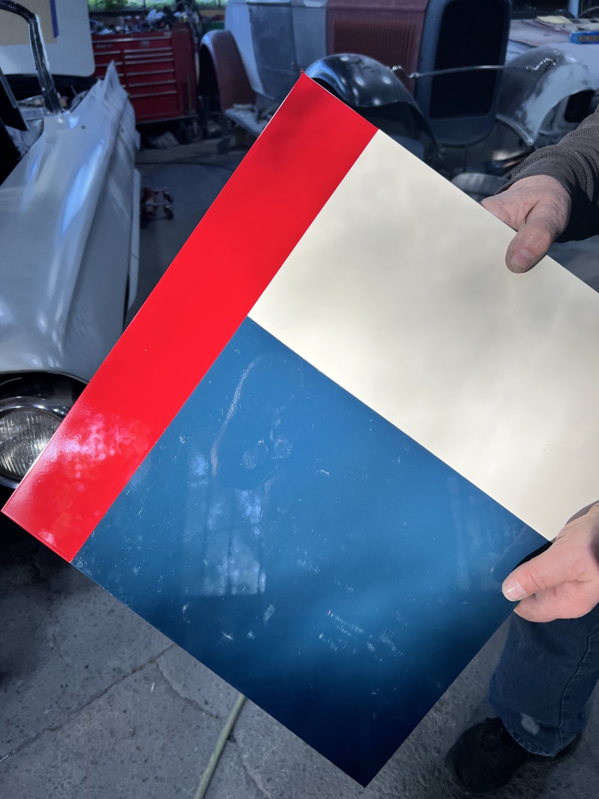

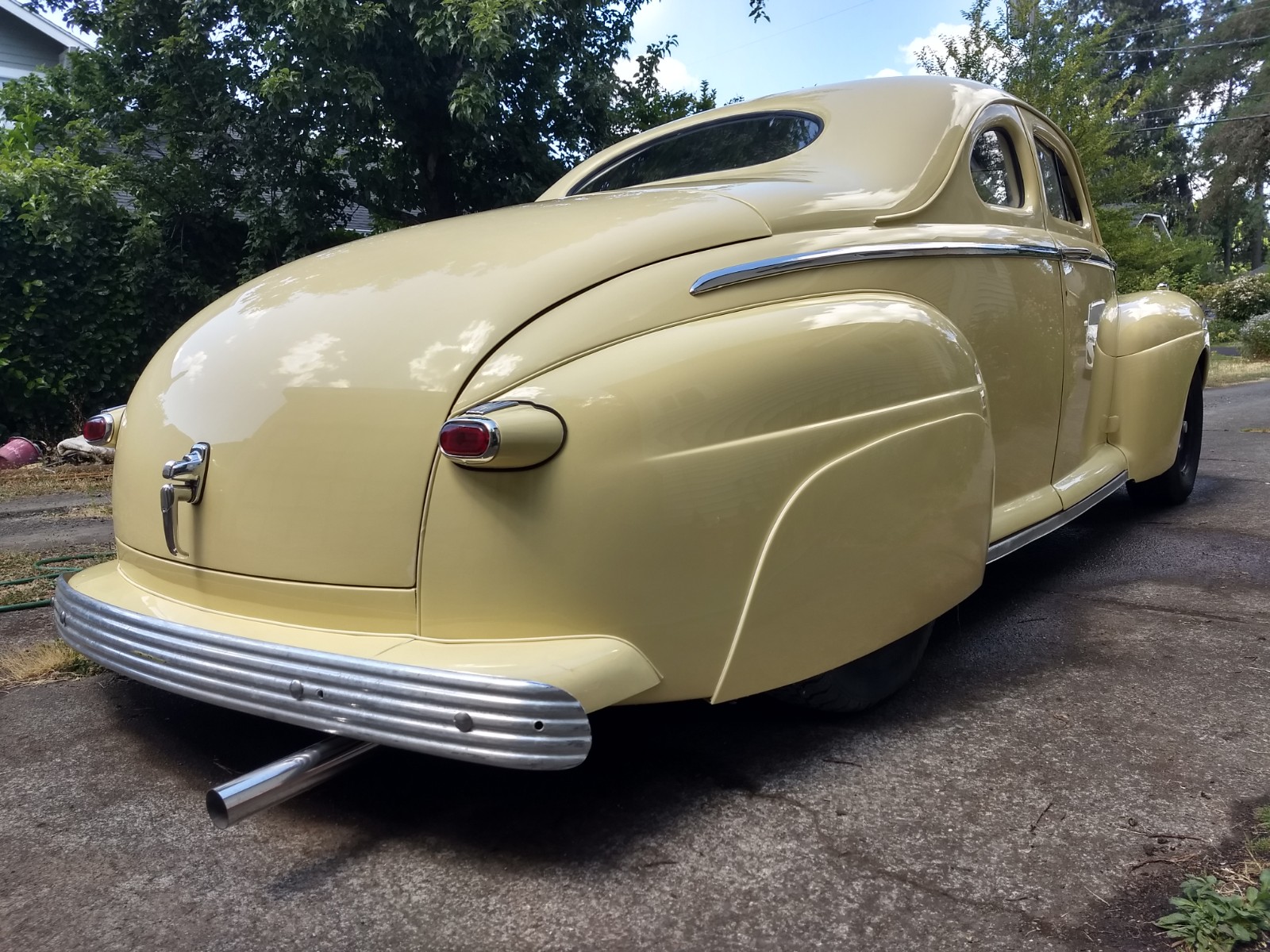

    I am also a fan of TCP global paints. This was shot with their single stage urethane and was only $250/gallon. Recently found an awesome polyester primer from House of Kolor (SP1600) which can be bought on Amazon for less than half the price of Evercoat products. I think decent affordable products are out there if you are a careful shopper.

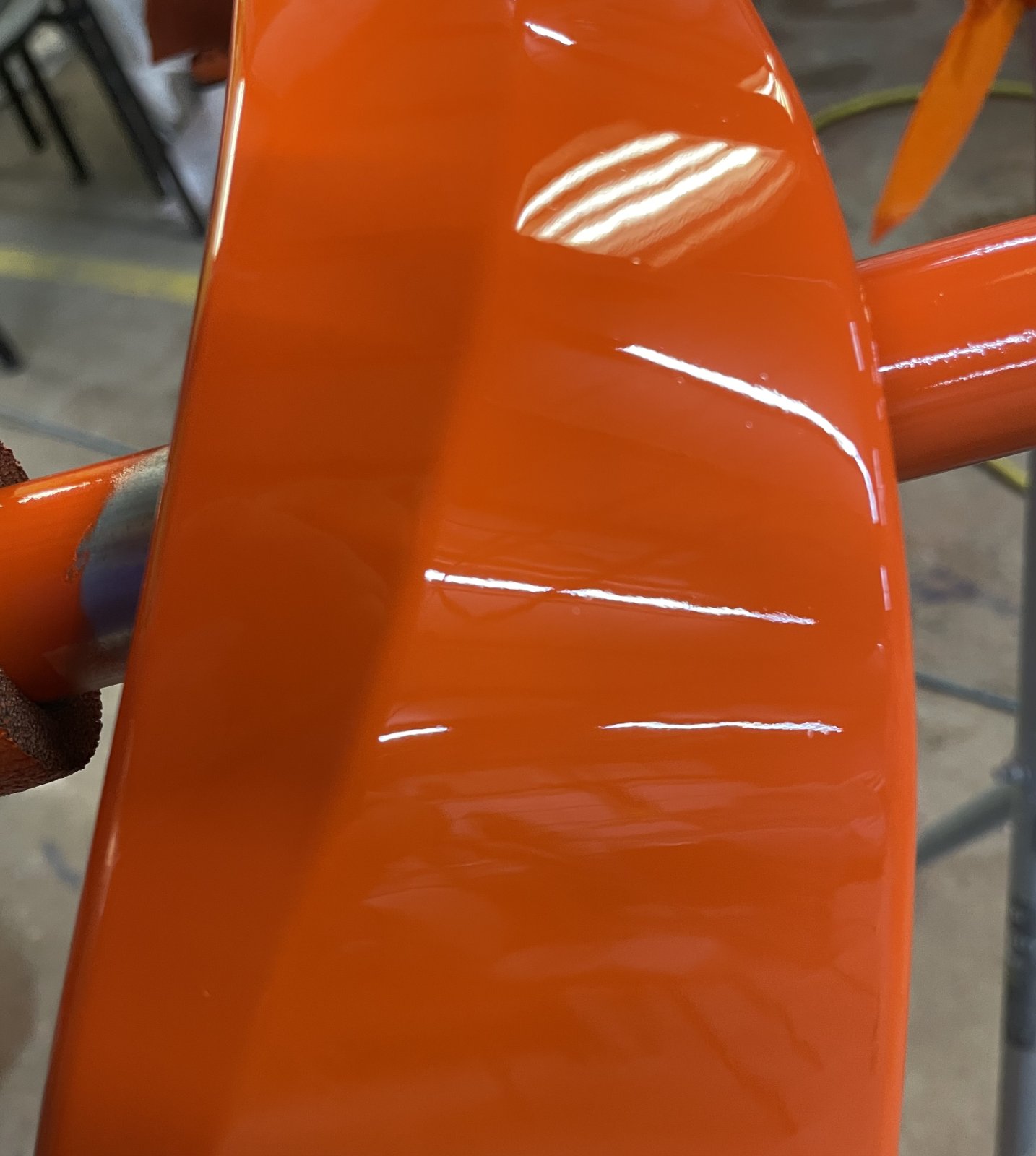

    Unless Anthony told everyone it was Rustoleum, you'd be hard pressed to know the difference.
    Sand - prep - primer - sand - prep- spray - multi- fine sand - prep - clear - final buff.
    Looks good Anthony.

  14. It’s all prep. The funny part is this particular piece was just cleaned and sanded with 400.
    Ive buffed oil based enamel and it looked great.
    I guess the biggest difference is durability.
    This will fade quickly if left in the sun and chip easily.
    But it’s just a tractor part. I wouldn’t be afraid to use the cheaper Alkyd enamels from our local ppg store. Not much more $$$ than rustoleum. Tons more “factory pack” colors and can be custom mixed.
    When used with the hardener it’s fairly durable and I have feather edged damage. Meaning it’s repairable.
    Using top shelf paint/clear seems odd for building a daily cruiser. Especially in the jambs and ch***is.
    The latest and greatest pigment technology isn’t needed for our all over paint jobs.

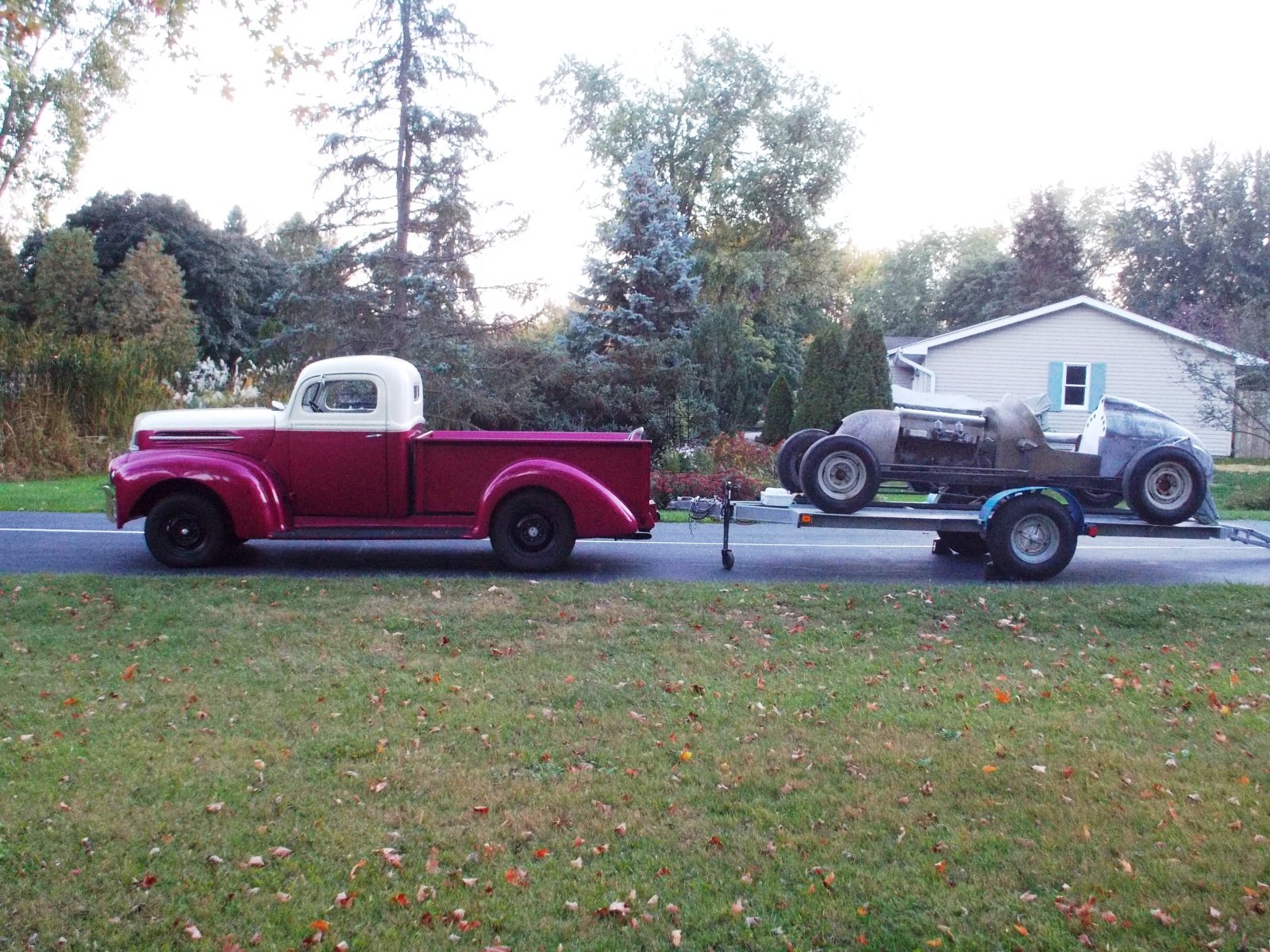

    Priceless.... and a enough money left over for a Hamburger, fries and Coke.
