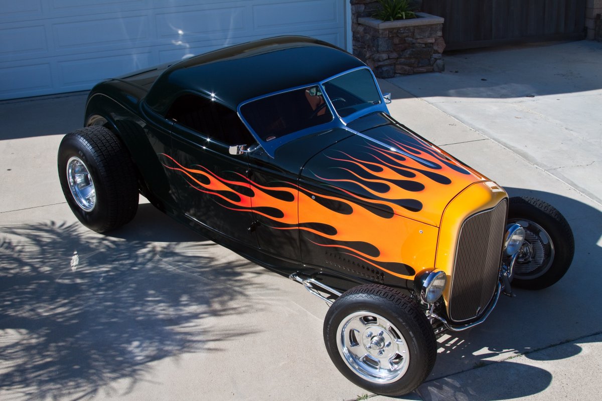

  5. clean cut creations
    Joined: Feb 8, 2005
    Posts: 1,352
    clean cut creations

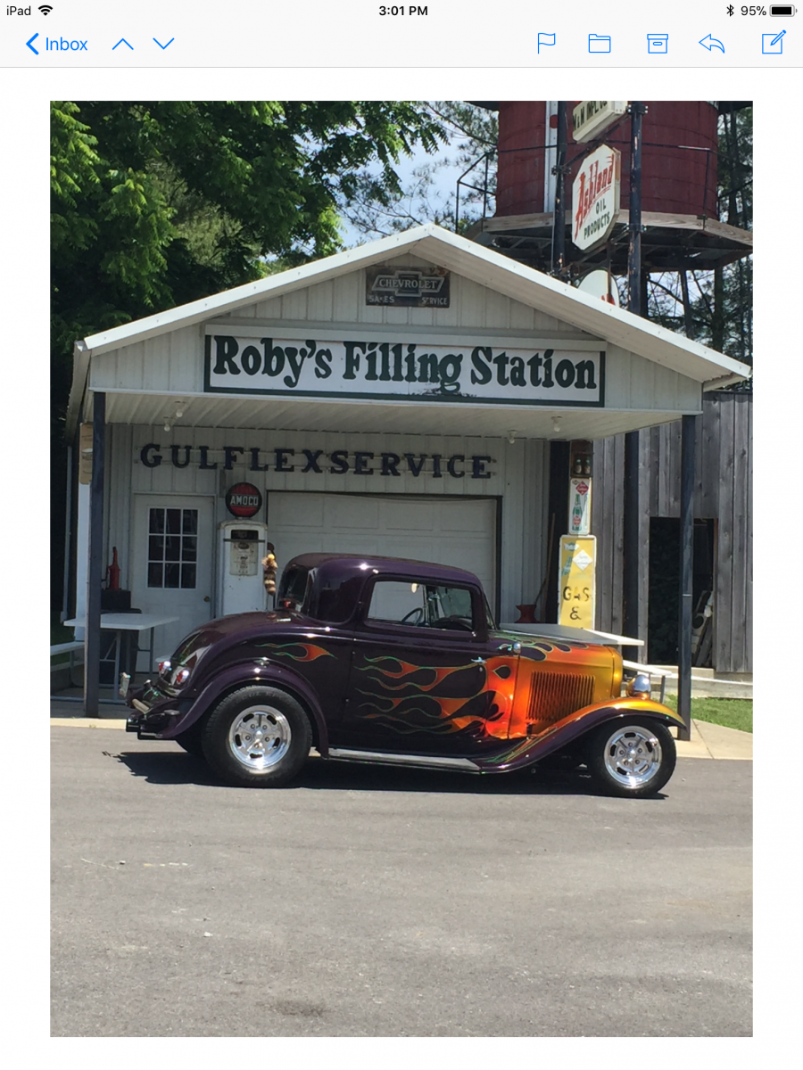

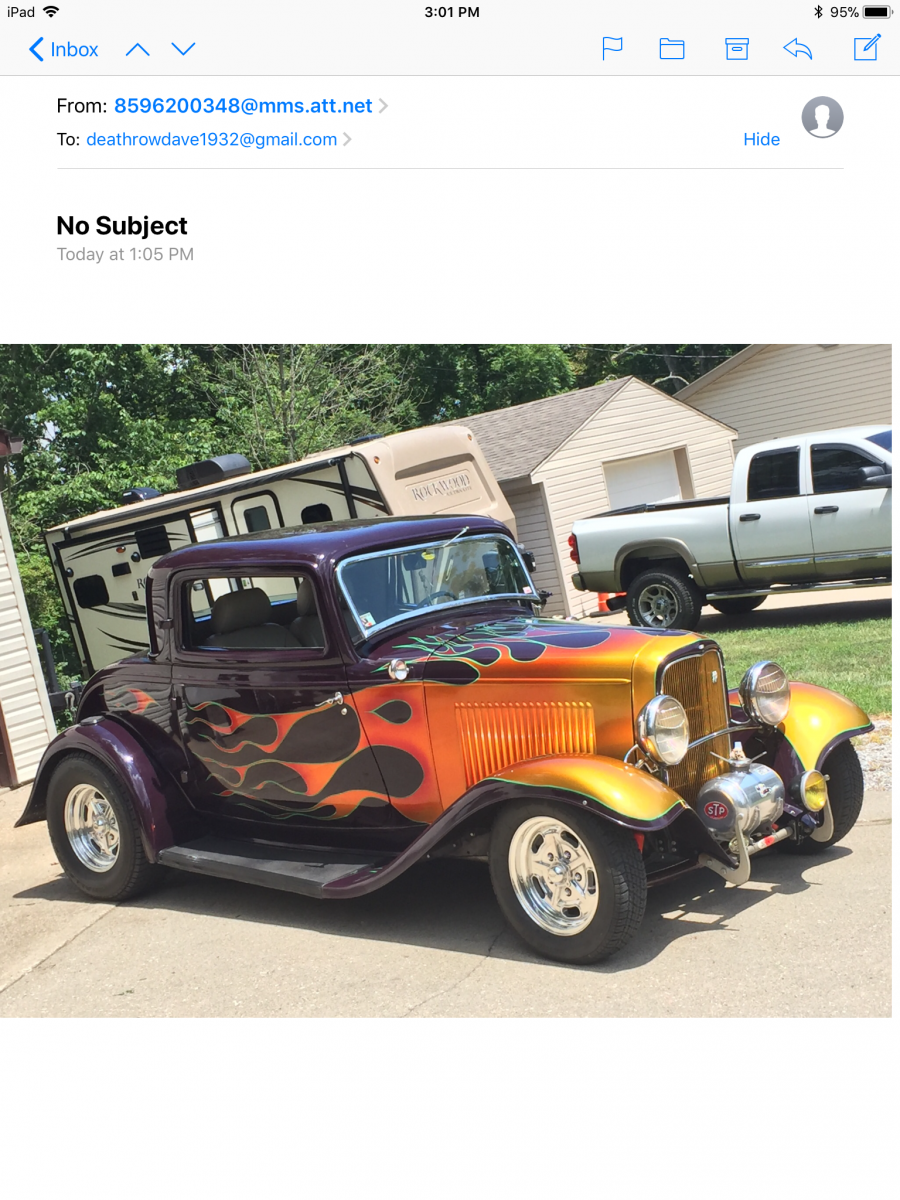

  15. deathrowdave
    Joined: May 27, 2014
    Posts: 5,522
    deathrowdave
    from NKy
    These are done in my driveway , gold base candy yellow , candy orange , candy red , green outline . May not be the best layout , but I did it , no funds for pro to do it , babies needed shoes .

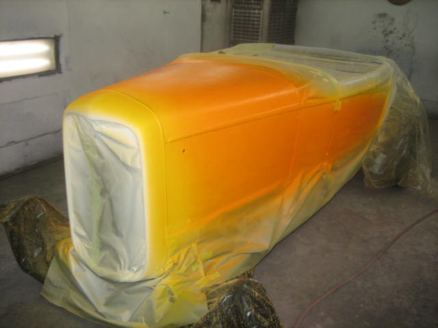

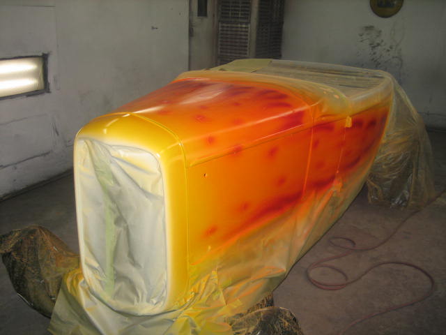

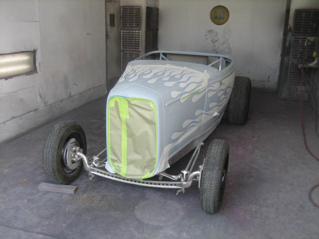

  28. philly the greek
    Joined: Feb 15, 2009
    Posts: 1,863
    philly the greek
    from so . cal.

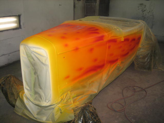

    Full color-3.jpg Here's a photo sequence that might help . When I did these I first painted a white base as the color yellow is quite transparent and it helps with color coverage . Next I start the fade process from light colors to darker , starting with the orange which I blended into the yellow followed by the red color . IMO it helps to use the slowest reducer possible for the temperature when doing the fades as it helps to blend from getting to much like stucco . Follow this with the clearcoat of your choice , color sand , rubout , pinstripe the edges and your done . Good luck with your project . IMG_2799.JPG IMG_2800.JPG IMG_2801.JPG IMG_2802.JPG IMG_2803.JPG IMG_2804.JPG

    Thanks that really helps great looking car
