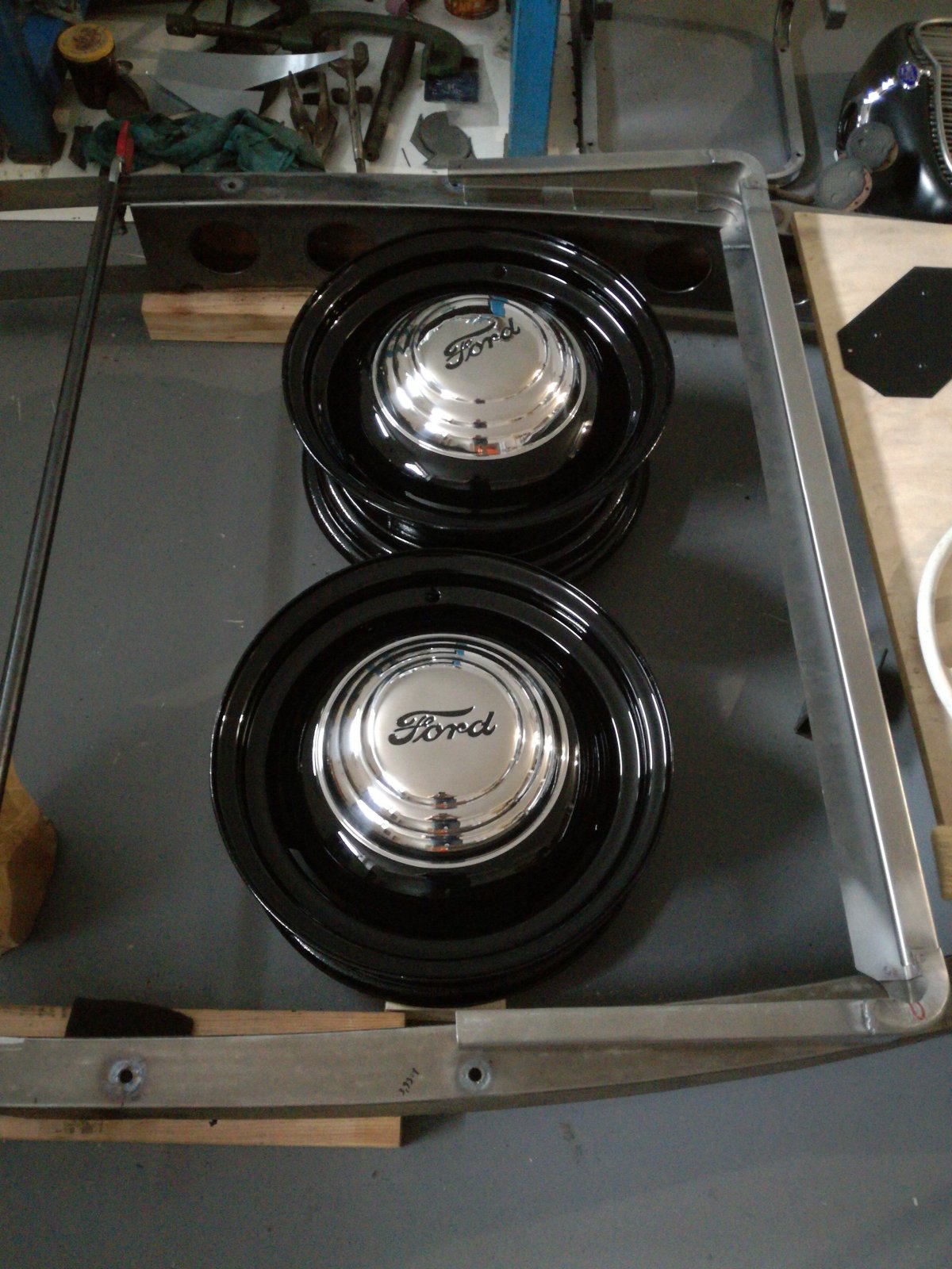

    I am hoping to fit these jeep rims to my '30 model A, they are new from MD Juan.
    They have arrived with a powder coat, can anyone advise on the best plan for painting these?
    I would like to get them to match the original black paint of the fenders of my car if possible.

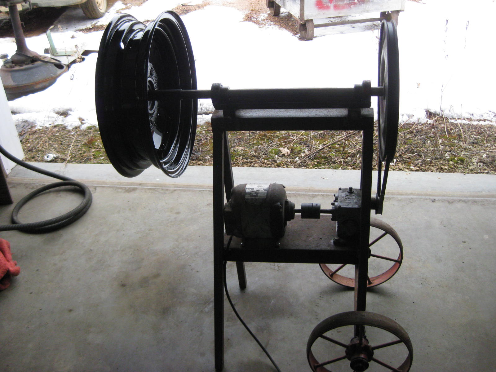

    Nice. Merc always loved those! I'm glad that works ,I've heard of cooking powder coating in an old oven . But New England is tough. And your right it does depends on the shop doing the work. But pop spent about 175 bucks a rim to do his wheels and they had alot of Orange peel . I was not impressed and I went to high school for auto body and love to paint . I like my base coat clear coat.

    Pores in the metal? No. There are not pores in the metal to fill. Powdercoat is a polymer that melts and adheres to the metal through mechanical adhesion, to the surface profile of the metal. That's the reason for blasting prior to powder coat, to get rid of anything on the surface and to leave a slight surface profile for the powder coat to adhere to.
    To paint a powder coated surface, you need to create a surface profile by sanding/scuffing it. Then your best bet is to prime it for that mechanical adhesion, so that when you apply the paint it also has something to chemically adhere to as well as mechanically.
    My truck has had powdercoated wheels for 12 years. I've been in wild rain storms and all kinds of weather, no issue. If your powdercoated part has orange peel and is rusting, it wasn't powder coated well. I spent around $250 Canadian for a set of four wheels on my truck.
