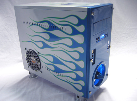

    Hello all you crazy mofos over here:D! I was looking for some advice on a paint gun and couldn't keep myself from reading through this whole thread because it was uffin' hilarious! So much love in the air! This is the place for me! ;)
    Anyway, real brief introduction - was heavily into custom rides for years with a concentration on computer systems installations (my specialty) inside the rides. I am now focused on creating my own custom computers mods, basically customizing them in similar ways that you would a car. Here's an example of something that I'm involved with (this was done by a great modder, a buddy of mine - Bill O.):
    THE DEUCE
    After modding and customizing the case, we paint them with automotive color (in this case HOK). I am just starting to paint my cases with spray guns, used to use Plastikote spray cans before.
