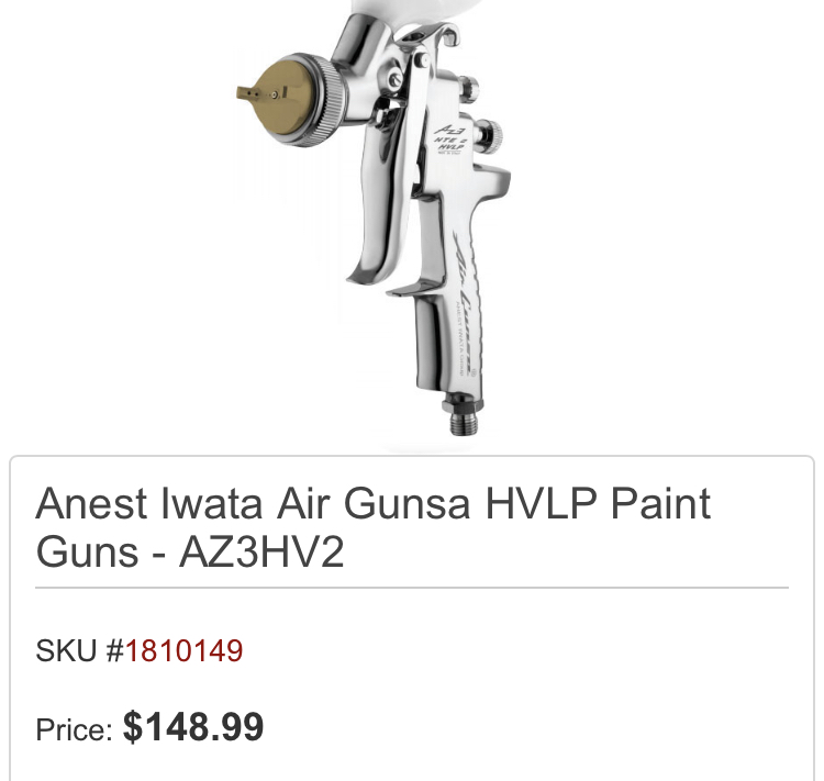

    best “lower priced” gun I have used.
    1.3-1.5 and 1.8 tips available
