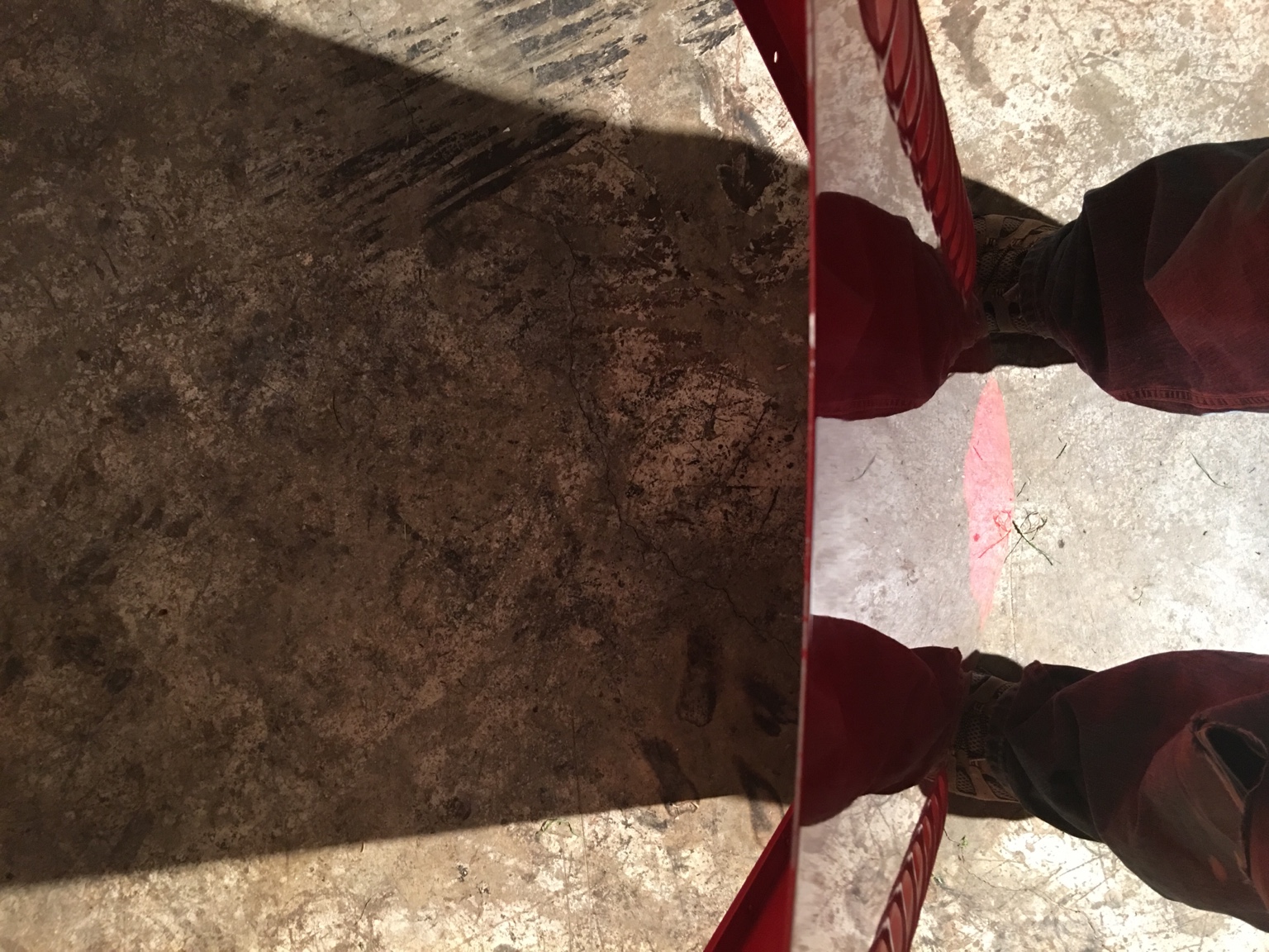

    Going rounds with a painter. First paint job had bugs, runs, fisheyes, etc. The doors and rumble seat you could see black dots all over. Almost like he reduced it down too much to spread the paint out more.
    Well, now I got my aluminum parts back, after round 2. Meaning hood, louvered sides and rear roll pan. I rubbed my finger down the edge and the pain just came off. This was painted 2 weeks ago and has been sitting. Any ideas why this paint just falls off the edges when pressure is applied?
    [​IMG][​IMG]

    Aluminum needs a special etching primer. It's usually green in color.

    Improper prep on the alum parts. We sand all surfaces, clean and apply epoxy primer on all alum parts. Never had an adhesion problem doing it this way.
    Based on your photos I would find another painter.
  6. Paint fell off because it wasnt prepped properly or the guy has serious amounts of contamenents in his airlines.

    On aluminum I would clean it well, spray etch first, and epoxy over it. You have an adhesion problem....and holy orange peel...gun set up and spray technique will help that. I would say color sand it, but I'm afraid the paint will cone off in sheets.
    Runs....lack of skill
    Fisheyes...something in the air, improper cleaning of surface, contaminants in the lines
    Bugs..happens in a garage job
    Black dots? Maybe solvent pop?
    Sounds like his guy is learning to paint on your ride.

    Zinc phosphate primer.RM USED TO make one. Called "ZIP". WOrked great on aluminium. You need a new 0painter.

    Just talked to the guy. Last night he said he etch primed it. Today he told me that he acid washed it and that the paint should stick really good and how the old red paint that he painted over must be peeling. Old paint never had these issues.
    I'm scared that even if he "fixed" the edges, if he doesn't sand all the way down and etch prime it, is there a good chance paint chips off of the flat surface later? Even though it half decent now?
  29. Yep you need to use a good zinc primer first on alum. It should be green. If you don't use zinc it won't last as long some of the primers out now will work with alum but nothing beats zinc primer. That's why NASA still uses it....
