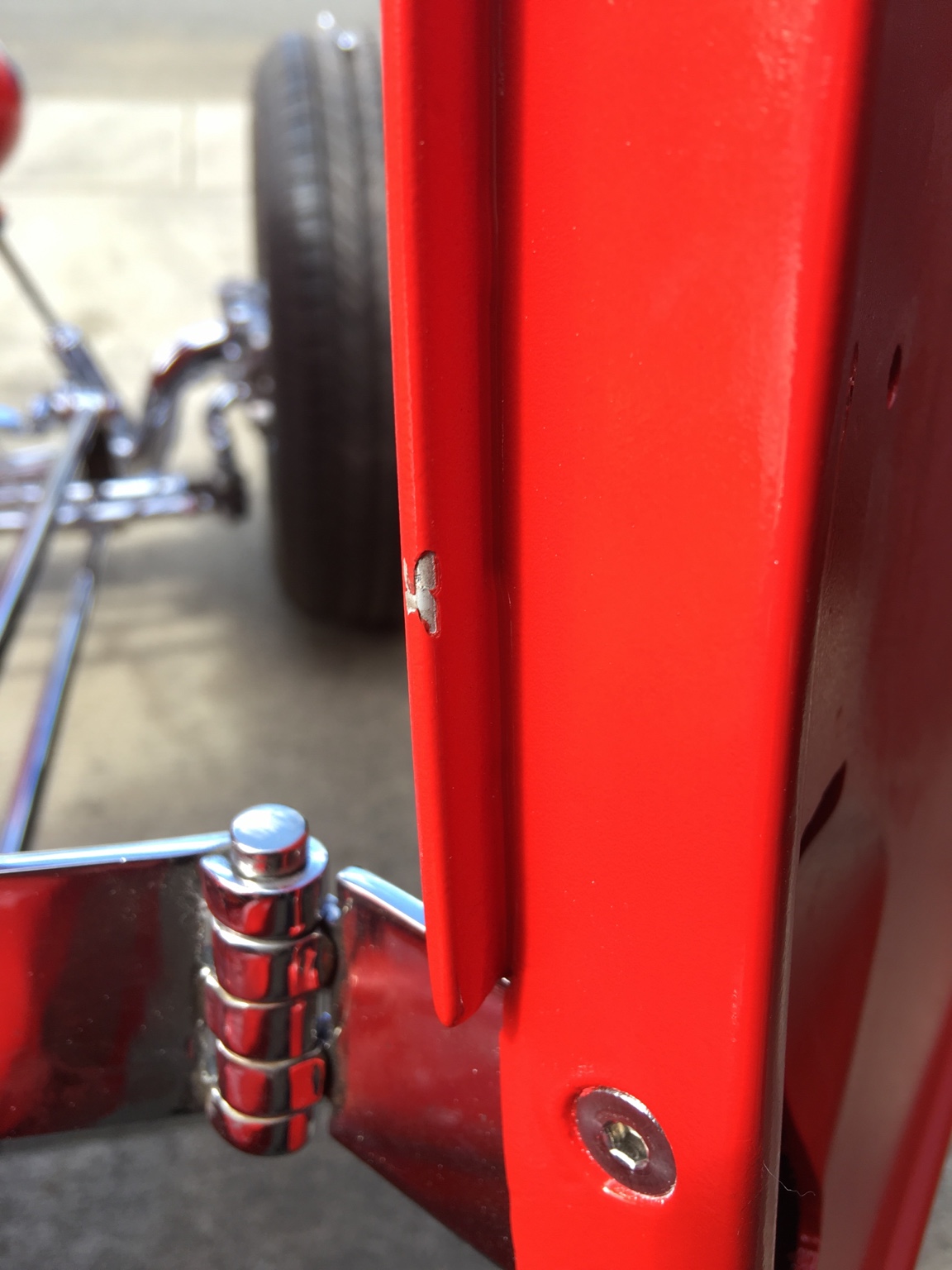

    Putting fibergl*** door on. More paint chips off. Is it supposed to chip this easy?! F#*%[​IMG]

    Good grief. You have had your answer yet you continue to share your pain.
    Take it as a lesson. I'll tell you step by step as you seem to need it.
    1) Go to get your car. You own it and should drive it home.
    Explain to him that he has not provided quality work and that you are terminating the agreement.
    2) Pay for the materials not the substandard labor.
    3) Find another painter based on referrals from previous customers.

  12. That paint looks pretty thick.

    Hate to sound like an ***, but if you keep on fooling with this clown after the mess he's made so far, then the mess you'll end up with is your own fault. And you can bet it will be a mess.
    The real problem with this guy is that he doesn't even know the basics of painting a car. For example......
    You never use etching primer or any sort of acid wash back onto old paint. It will cause problems. Maybe in a week.... a month...... or 6 months, but its just a matter of time.
    As others have mentioned, you prime aluminum with either zinc iron phosphate or with epoxy. Other primers won't bond to aluminum sufficiently to make for a good job. Period.
    The chipped door edge you show is proof that he doesn't know better than to pile up the paint on edges. What he's glommed on in that pic is guaranteed to chip at the first minor contact that wouldn't even phase paint of the proper thickness.
    The panel in your first set of pics proves he doesn't know how to adjust a gun. Its easy enough for a rank amateur to lay down 10X better work with a $10 Harbor Freight gun and hardware store enamel than the mess he's blown onto that panel. All it takes is about half an hour of reading about how to adjust a gun and practicing on cardboard or masking paper until the adjustments are right. Obviously he's never learned that basic skill.
    "Works hard and tries" is fine when some hack is cobbling up his own **** out in the barn, but its worth nothing when you're paying good money for results. Most people who are "in a hurry" are in fact just too lazy or too incompetent to ever be capable of producing decent work because they'll never put forth the effort to learn. You have to have a certain level of knowledge in any trade before you realize what you don't know. By all appearances he's still in the know nothing stage and a long way from having any idea about what he needs to learn to be able to do halfway competent work.
    Your planned attempt to supervise him into doing a good job is nothing but a further waste of time and money. He doesn't know the basics, and you can't supervise him into doing a good paint job any more than you can supervise the next guy you p*** on the street into doing successful heart surgery.

    It looks way too thick.

    Put a piece of 2" tape on the hood side and let it sit a few minutes then rip it off with no mercy. Got paint? Complete strip and refinish. Do it in a lot of other places you're having trouble with. I shudder to think what you may find, and in fact you may not. Still, with it chipping as easy as it does (too much film build) what about the occasional highway stone? Have you tried using the area where things attach to the finish (door handles, trunk latch, etc)?
