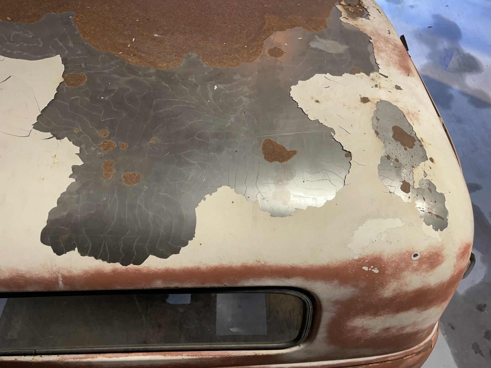

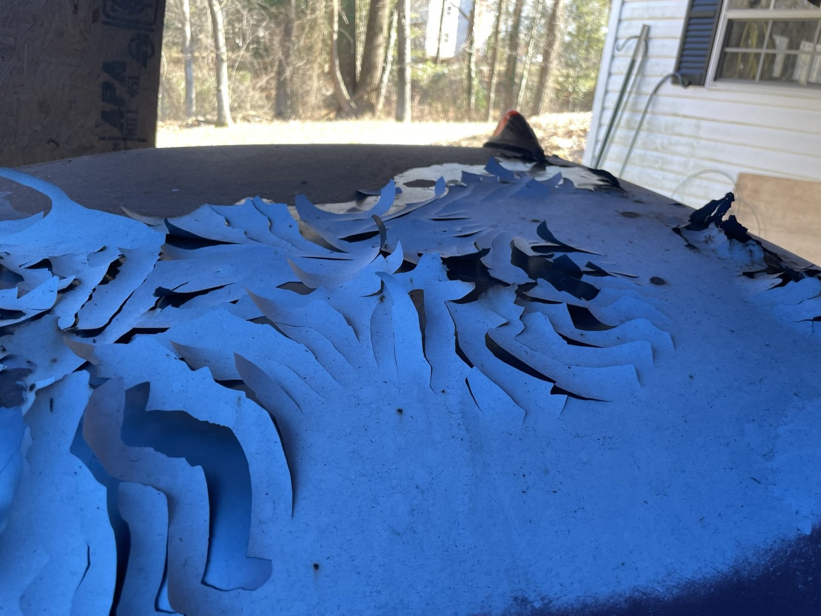

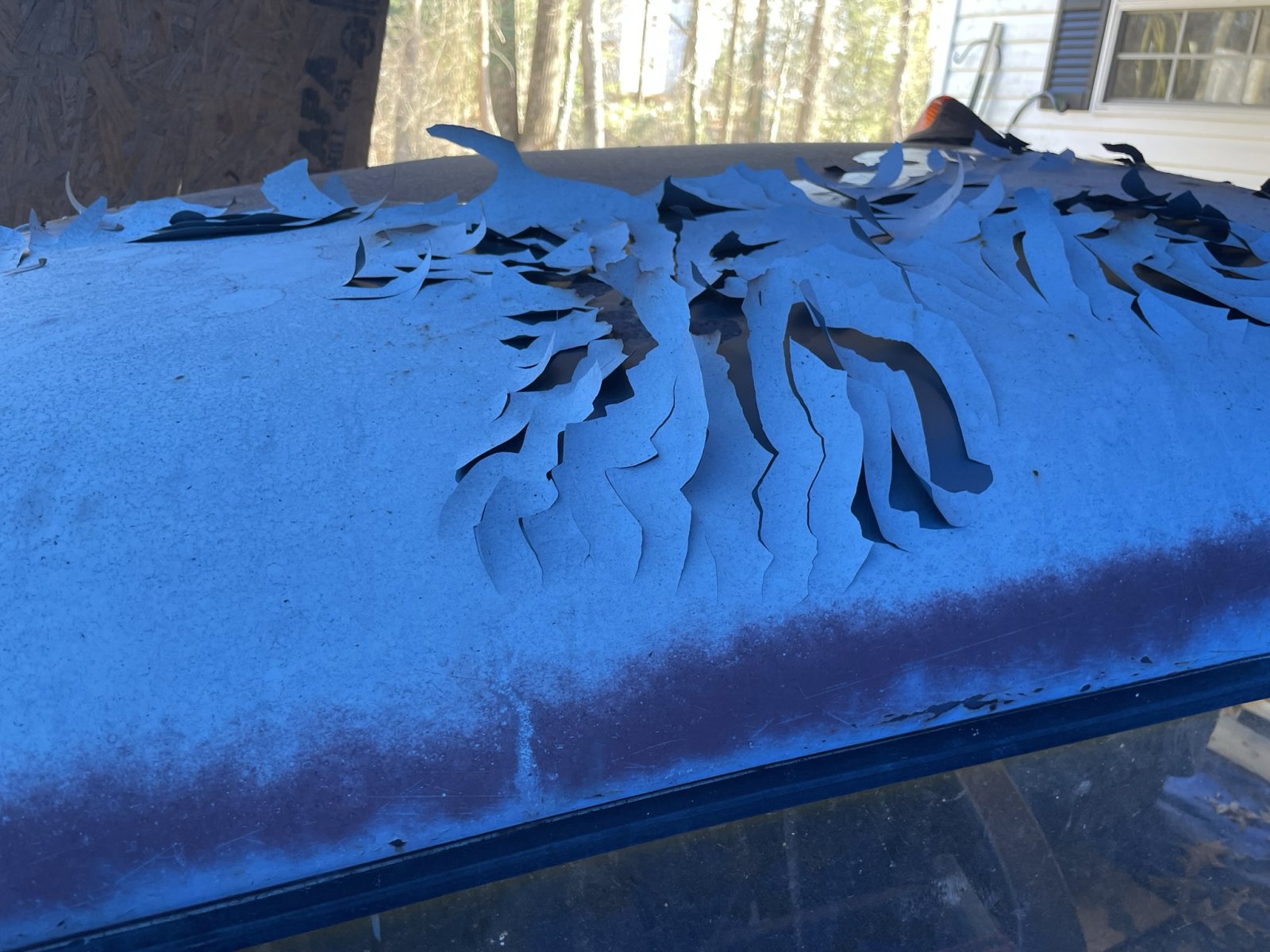

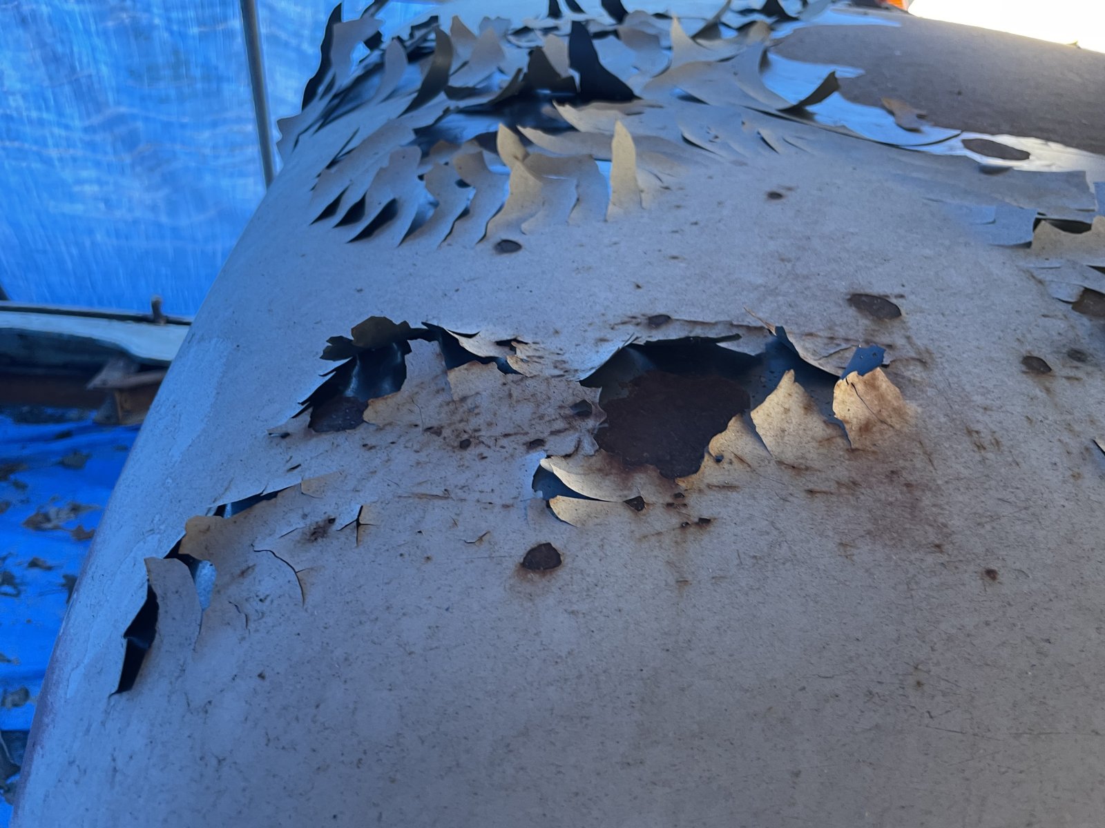

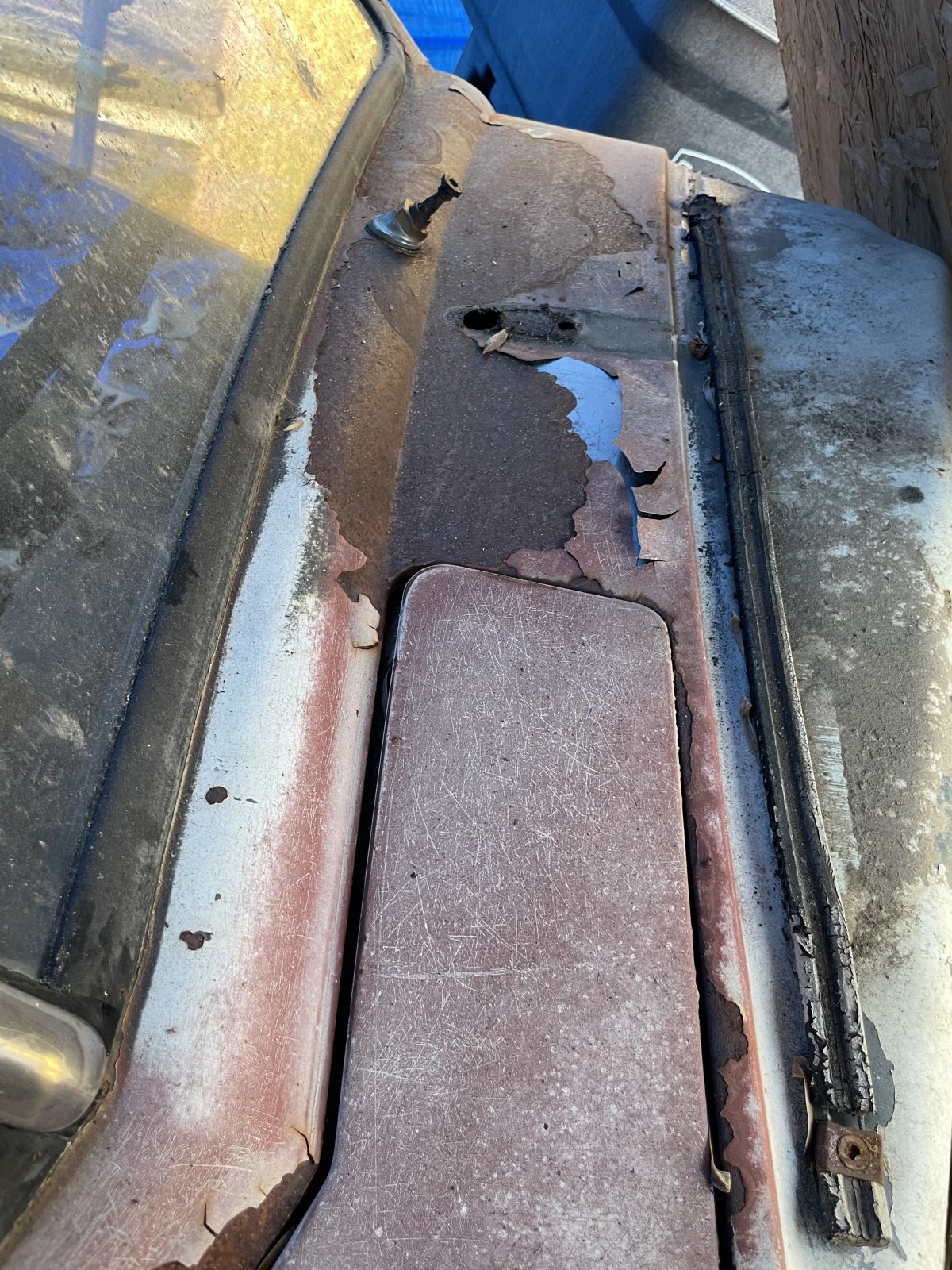

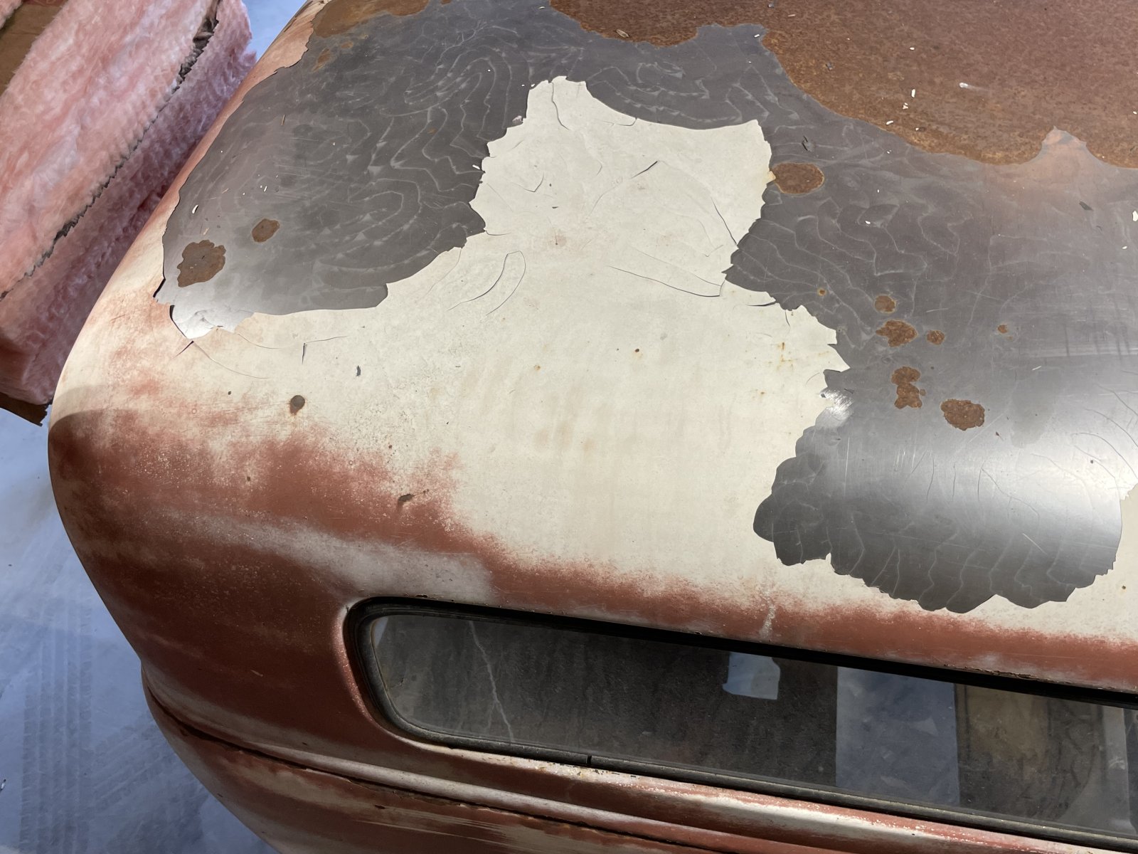

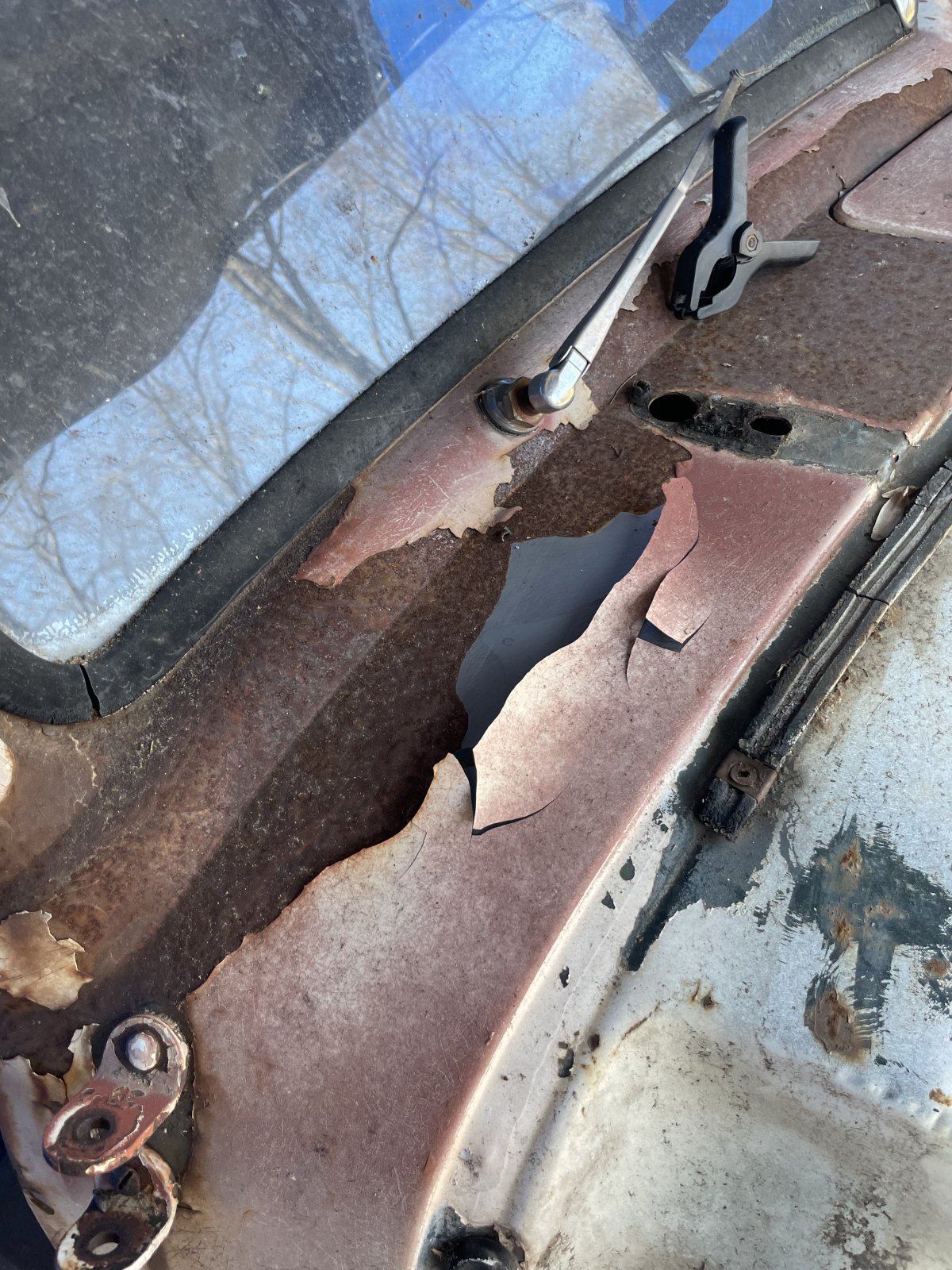

    Hey guys
    I bought a ‘49 Chevy cab over and had it sitting outside under a covered lean-to. After a cold spell, I noticed the paint on the roof flaking. So I moved it into my garage. But today I noticed the roof, cowl and lower cab corners flaking again. Now my garage isn’t heated yet, but I’ve had cars sit outside through winters and nothing happened to the paint.
    The spots where the paint is flaking off is pretty smooth, no real sand grooves. But if it’s factory paint, I wouldn’t think it would be grooved from sanding. The backs of the paint flakes are grey, leading me to believe it’s primer, since the paint of the cab is white. I’m thinking of feathering out the flaking areas and clearing it to keep it from continuing, not sure if it’ll help.
    Any suggestions would be great.
    Thanks
  2. indyjps
    Joined: Feb 21, 2007
    Posts: 5,396
    indyjps
    Get all of that random paint off and shoot it with epoxy.
    Anyway to tell what kind of paint it is? Kinda looks like latex.
    https://www.southernpolyurethanes.com/
    This is good stuff, has UV additive if you don't top coat it in near future
    Plenty of other brands to choose from

    Chevy didn't use gray primer....and their paint stuck pretty well. Although it would wear away over the decades, from sun etc.
  4. Glenn Thoreson
    Joined: Aug 13, 2010
    Posts: 1,017
    Glenn Thoreson
    from SW Wyoming
    Piss poor paint job. I would get out the paint stripper and, with a lot of work, would re-do it right. Covering a car with a tarp in a humid winter climate can cause this, too. A move from a dry climate to a humid one and a change in temperature variations can do funny things to mis-applied incorrect paint also.

  6. squirrel
    Joined: Sep 23, 2004
    Posts: 59,940
    squirrel
  7. 57JoeFoMoPar
    Joined: Sep 14, 2004
    Posts: 6,503
    57JoeFoMoPar
    There is no other option except to strip it all off and repaint. There is no adhesion between the paint and the metal. Any paint that goes over it is going to come off in the same fashion. Strip it bare, remove all hints of rust, DA everything to 80 grit, and epoxy over that.
    X-cpe and Tow Truck Tom like this.
  8. Clear doesn’t like bare metal.
    There are some adhesion promoters that claim to help.
    I like old rusty ****.
    But I think I’d DA and epoxy.
    A red oxide epoxy would probably look better if ya like an old look.

    If they were prepped in the same manner they will fail at some point as well.

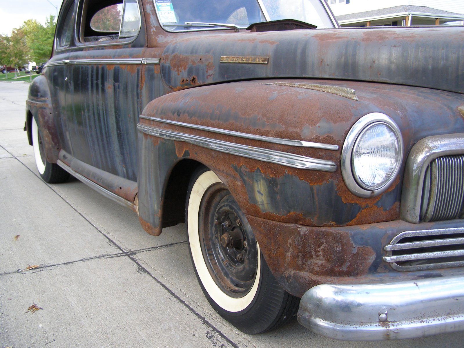

  12. corncobcoupe
    Joined: May 26, 2001
    Posts: 8,727
    corncobcoupe
    SUPER MODERATOR
    There is original untouched patina - and then there is fabricated patina.
    2 TOTALLY separate things. You can't fabricate or match or recreate original patina.
    It will be just that if you try - fake patina and it is not the same.
    Power wash it to blast off the heavy flake junk and just let it be, rust on.....
    But to each their own. Enjoy.
    Maybe my old Merc Coupe will be a little patina inspiration for you....

    Looks to me like a skim coat of Bondo failing, seems to thick for paint. Ralphie

    Think your patina option went away with the sheets of paint falling off. As others have said, that remaining paint isn't any good. Unless you want it to rust away, your choices are limited. Do it the right way is my suggestion.

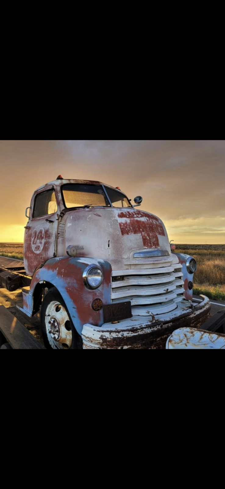

  19. w2w
    Joined: Oct 17, 2008
    Posts: 213
    w2w
    from East Coast
    Thanks guys. I’m going to try and sand the edges and spray something to lock it in. If it gets time to finish the interior and the thing is still flaking, I’ll attempt to match the patina after stripping.
    need it to stay like the attached picture.

    That looks like my first paint job. I used some kind of red oxide primer, like rustoleum, then put good automotive enamel on it. It looked great….about 3 months. Then it started peeling off in sheets like that. The primer and paint weren’t compatible, the paint never adhered to the primer. Only cure was to peel it off with a razor blade or sand of what did adhere. I’ve since learned to use products from the same manufacturer to get the best results.

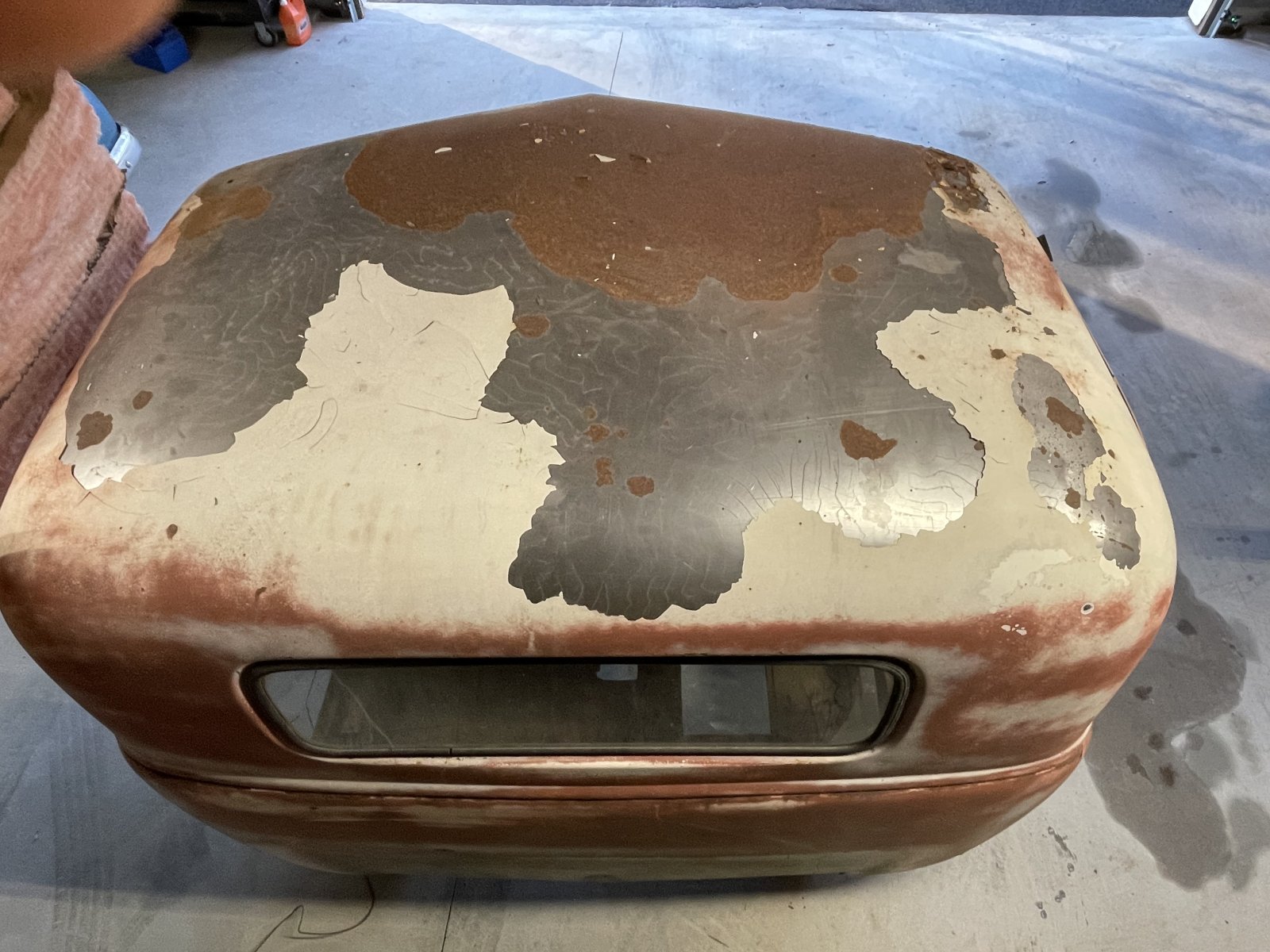

    The paint looks like a poor attempt at patina as if the white was applied and dusted with red primer then feathered out. The paint peeling off the roof is white while the back of the cab is made to look like the primer is wearing through. Why would the top stay white when it gets the most sun while the back of the cab is made to look like the back cab is weathering. It may be peeling off the roof being wrong paint that can't take the weather. There is no point to saving the paint as it is in full failure mode.

    That may be original color but I'd bet dollars to donuts that it isn't original paint It looks like it is pealing like some of the layers of paint/primer on my 48 wih way too many layers of paint an way too little prep work. Scuff and shoot another couple of coats just before Vintiques every year so it looked fresh and go again thinking that I would take it all the way down and do it right some day. I can't find the photos but it's possible that it looked so bad I deleted them. I'll take some in the morning weather agreeable. Screenshot (1030).png
  27. My bet is that's house paint that didn't adhere to the original paint. Blow, s****e, power wash and sand that **** of and start over. On the other hand, if you are building a tribute r%# r*d, feather it out and keep on truckin'

    Far as I can tell, there’s been a few suggestions. Mostly, sand/strip/ restart. But unless I’m mistaking, a few people suggested to spray something over the roof in an attempt to lock it in.
    however, I think there is some truth (maybe a lot more than some) to this issue of improper paint. Whether it’s house paint or just not correct for the primer.
    I have a lot of work to do on the inside and frame, so I’m just gonna let the paint go for now and see what happens. Worst case, I’ll sand it all down and figure out what I wanna paint it next year.
    I was really hoping to save it, but fear everyone is right about it just popping off down the road regardless.
