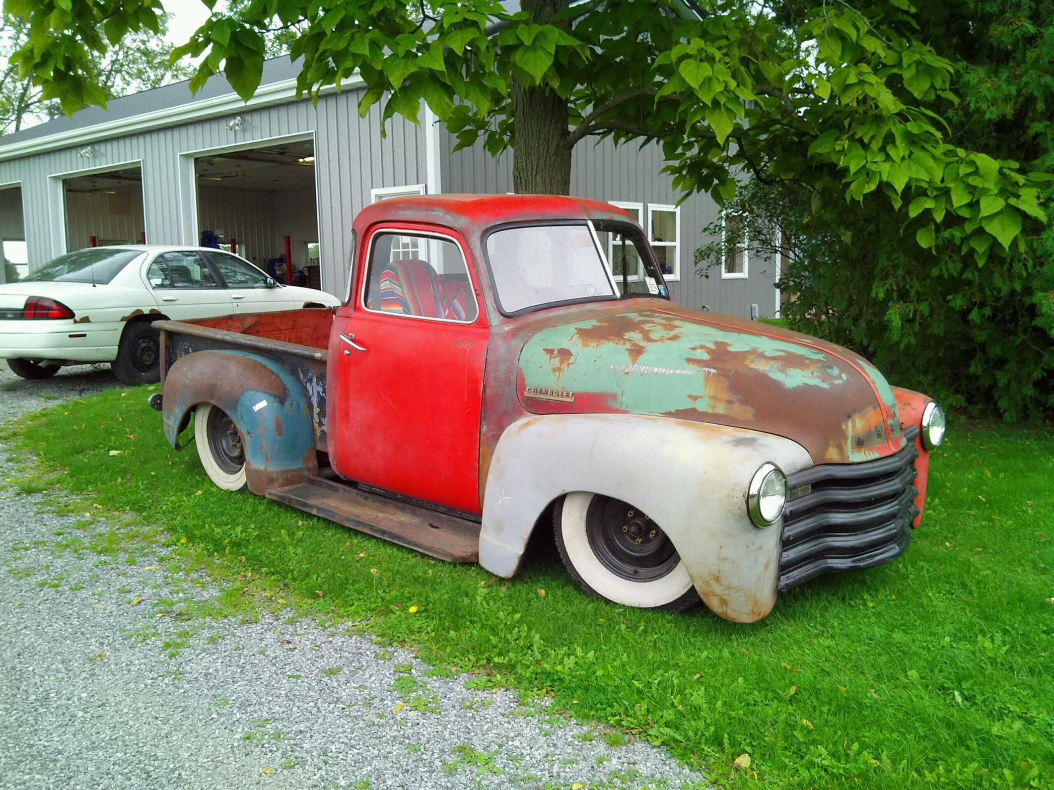

  21. 53inSD
    Joined: Aug 18, 2011
    Posts: 191
    53inSD
    Check my Thread in my signature for painting your whitewall....I was really happy how they turned out, The paint cracks, but still looks good, especially for the price.....
    ....My truck needs new tires, so I bit the bullet, and I am just under a G into them with tubes and shipping.
  22. Is this truck on S-10 frame?
