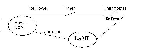

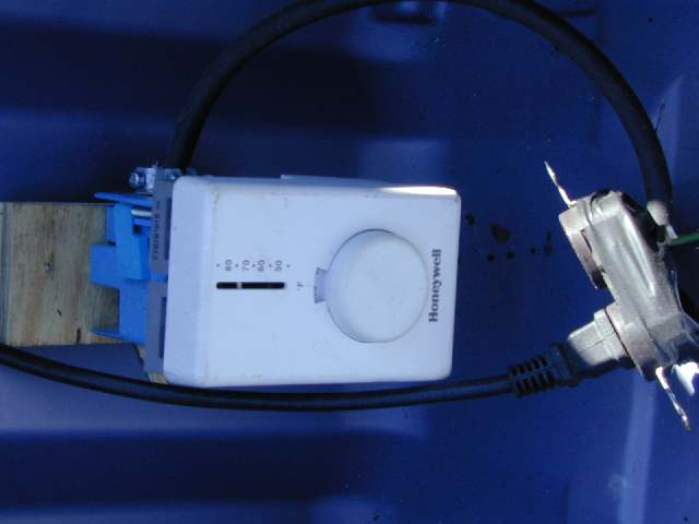

    -Wire the lamp, an electric baseboard heater thermostat, and a 12 hour timer switch in series.

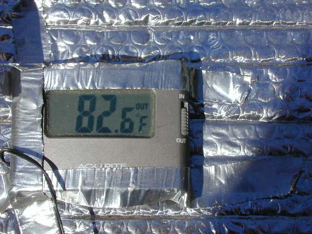

    -As an option, get one of those digital thermometers, and drop it into the bin so you can get an inside reading. The one I had reads inside and outside temps, but the probe it the "outside", so It's set to outside temp to read oven temp.

    -When the shop's at 45 degrees, the heat lamp gets the oven to 80 degrees in less than 10 minutes. The thermostat keeps the temps from getting out of control, and lets me set whatever temp I wanna run. The timer will run for 12 hours, so I can paint something, and go to bed. It'll be ready in the morning. I usually turn it on with the bare part in there, as well as the paint I plan to use, and let them warm up. I take it out, shoot the paint, and put it back in to dry.

    It does get warm, but even after at least 100 hours of curing time, not even any plastic creep. The lid has some structural ribs, and what you can't see is that I have a piece of plywood cut out to sandwich the lamp to the lid. That surely is helping.
    Also, the thermostat helps keep the temps in check, which is why I put it in the circuit.
    Here's the circuit
