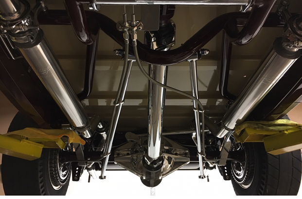

    I came up with my own formula when I was restoring bandit T/As a few years ago. Looks like the factory stuff but this is epoxy primer. Lasts and looks great!

    I used base/clear on my roadster's underside, just sayin :cool:
