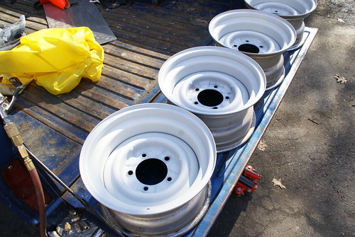

    Okay so today I dived right in and painted them rattle can glossy black.
    Here's basically what I did:
    - Spent the morning prepping the wheels. This included sanding any and all of the chrome's shininess off. First the emery cloth, then the finer sandpaper. Some rusty spots called for the wirebrush; no problem.
    - I went over to the hardware store and bought some XIM #400 white primer as suggested by HRP and someone else in another thread. It came in a rattlecan and cost twice as much as a regular brand.
    - Also picked up a can of Rustoleum glossy black protective enamel and Rustoleum crystal clear enamel.
    - I mounted each wheel one after another on the rear axle, then let the engine idle in first gear (safely jacked up of course), and proceeded to lay down some paint on the spinning wheels.
    - A couple misty coats of XIM primer, followed by several coats of Rustoleum black, followed by one coat of Rustoleum clear seemed to do the trick.
    Tomorrow we'll see how well its drying and whether I did good today or wasted a bunch of time (and money). So far so good though!
    I'll post some pics in a bit.
  22. HOTRODPRIMER
    Joined: Jan 3, 2003
    Posts: 64,859
    HOTRODPRIMER
    XIM is the best bonding primer on the market. HRP
  23. Mattilac
    Joined: Oct 27, 2007
    Posts: 1,156
    Mattilac
    Yeah I actually decided to go with it after reading your input! Thanks HRP.
    Anyways, here's some pics of today's escapade. Unfortunately, I forgot to take pics of the wheels after I scuffed off the chrome shininess, but if you can think of brushed aluminum, that's basically what they looked like.
    The wheels to begin with:
    Good stuff:
    All primered up:
    My paint station. It wasn't spinning as fast as it looks!
    Not bad, good enough for me:
    Sitting to dry overnight:
    What do you guys think?
