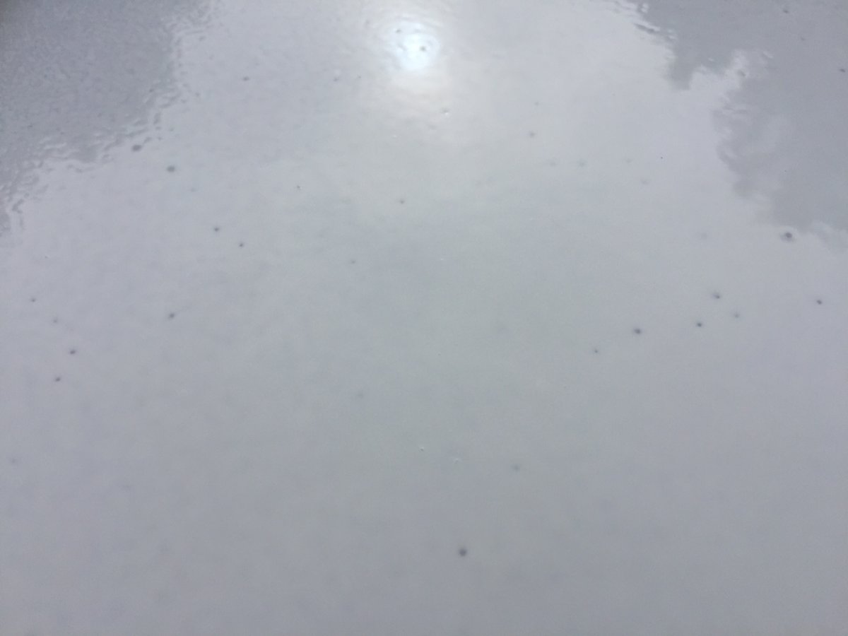

    image.jpeg Getting these little voids when painting. Summit single stage low voc, medium reducer. Plenty of copper pipe before water separator, second one at the gun. Tried more and less air pressure. Wiped down good with wax and grease remover followed by tack rag. Tried doing a light mist as well as wet coat. Driving me crazy, these little spots appear as soon as the paint hits the panel. Shooting onto poly primer. I'm outdoors and could understand some dust here and there. Any thoughts? Got a batch all mixed but looks like I'm screwed for today.
  2. Still looks like oily residue on the surface to me!!!
    stoneyzoni likes this.

    That looks like water in you CA line. Hows the humidity today??

  5. Looks like you may have gotten some sort of oil on it before you painted it. Degreaser will take most oil off but if someone happened to get some mist of WD-40 or other penetrating oil it will not come clean for you.
    When I was still in the body shop with Linn (my close friend and business associate for years)my side of the shop and my tools were always kept separate from his. There was no aerosol oil ever sprayed anywhere near the shop just for that reason. no oil ever touched his tools.

  7. You either have something in your line or something on the surface.

    Could be : water in the air line, oil in the air line, oil, or silicone contamination on the car's surface. Clean it well, sand it, clean it again, use Pre-Paint cleaner. Some wax and grease removers are petrol based, and leave a film. use a "last chance" filter at the gun itself. Last ditch efforts, buy some Fish Eye Eliminator and put it in the paint.

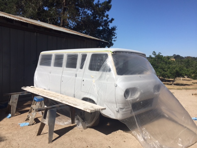

    image.jpeg Here's what I'm working on. Shooting the roof on my econoline. Winds up now anyways so hopefully I can figure this out today and try again

    Yep, you've got fisheyes. All of the above suggestions ( oil spray on the panel, oil or water in the lines... hope you didn't have a dirty stir stick or it could be right in your paint) plus it could be wax. Some of the expensive super waxes are almost impossible to get off, especially the renewers that promise to make your faded old paint look good again. I had one car that I washed down 3 times with water, 2 times with wax and tar remover, then wet sanded by hand and washed it down again with synthetic enamel reducer. I still added fish eye eliminator to the paint. If that's under your primer it will continue to come up in the top coats no matter what you try. Even fish eye eliminator isn't bullet proof, and test it for compatibility with your paint before you mix too much. I would wet sand it all off and start over before you throw any more money at it.

  17. Some of the waxes have the modern equivalent of Teflon in them. Nothing in the world will make paint stick to teflon.

    All good suggestions. I see tree's in the vicinity, another air-borne contaminant possibility. How about dust or pollen from that tin roof. Dirt parking lot. Slightest breeze &......
    Might wanna rethink your spray area altogether and give yourself a fighting chance.

    Here's where I'm at. Got a new oil/water filter plumbed right after my old main one, new hose and fittings, new oil/water filter at the gun. I would say there's a 75% improvement with those things done. It's not the car surface because I started shooting tests on plastic panels when I was making changes. I've got some fish eye eliminator showing up tomorrow to my local auto parts. Does it only need to be added to the first coat of paint?

    Even people that have a clean environment or paint booths still are challenged to achieve the perfect paint job, shootin outside is a crap shoot at best but it has been done many times with success.

    After all those precautions and cleaning you're still outdoors. I see a lot of sand on the ground, which over time equates to fine silica dust that's easy to get airborne. The temp change from the compressor to the end of the spray gun, sun beating down on the hose with cool air running through it, makes water that's short of impossible to remove or abate. The material you're using is no help either. No doubt really sensitive and solvent rich to keep it at a low price point. Knife in a gun fight...
    Ok, you can win if you turn that buck knife into a machete. The gun filter is a good choice and they help a little bit. The longer you pull the trigger the worse it gets so adjust a little, maybe smaller sections (it is the roof of a van). The other weapon required, you need to also clean with water based surface prep. Solvent base (wax n grease remover) will not remove select water based contamination. Start there with either some really clean water or an old school form of window cleaner with ammonia followed by water. Don't use alcohol because it'll soften the base finish. Even if you can't see it there's probably some left in there and it's slightly sealed in by the 1st coats. Only a good sanding will get it to where you can clean it. Follow up with the solvent and then the tack rag, when the breeze is gone, you could be good to go. Fisheye preventer is a good last resort, but know this, use it on all coats, make a note of it in case it will need a repair because it'll have be used every time. USE VERY LITTLE. It's not a "...some's good more is better..." thing. The best advice? Spend the time and take it indoors. Sorry, had to say it...
