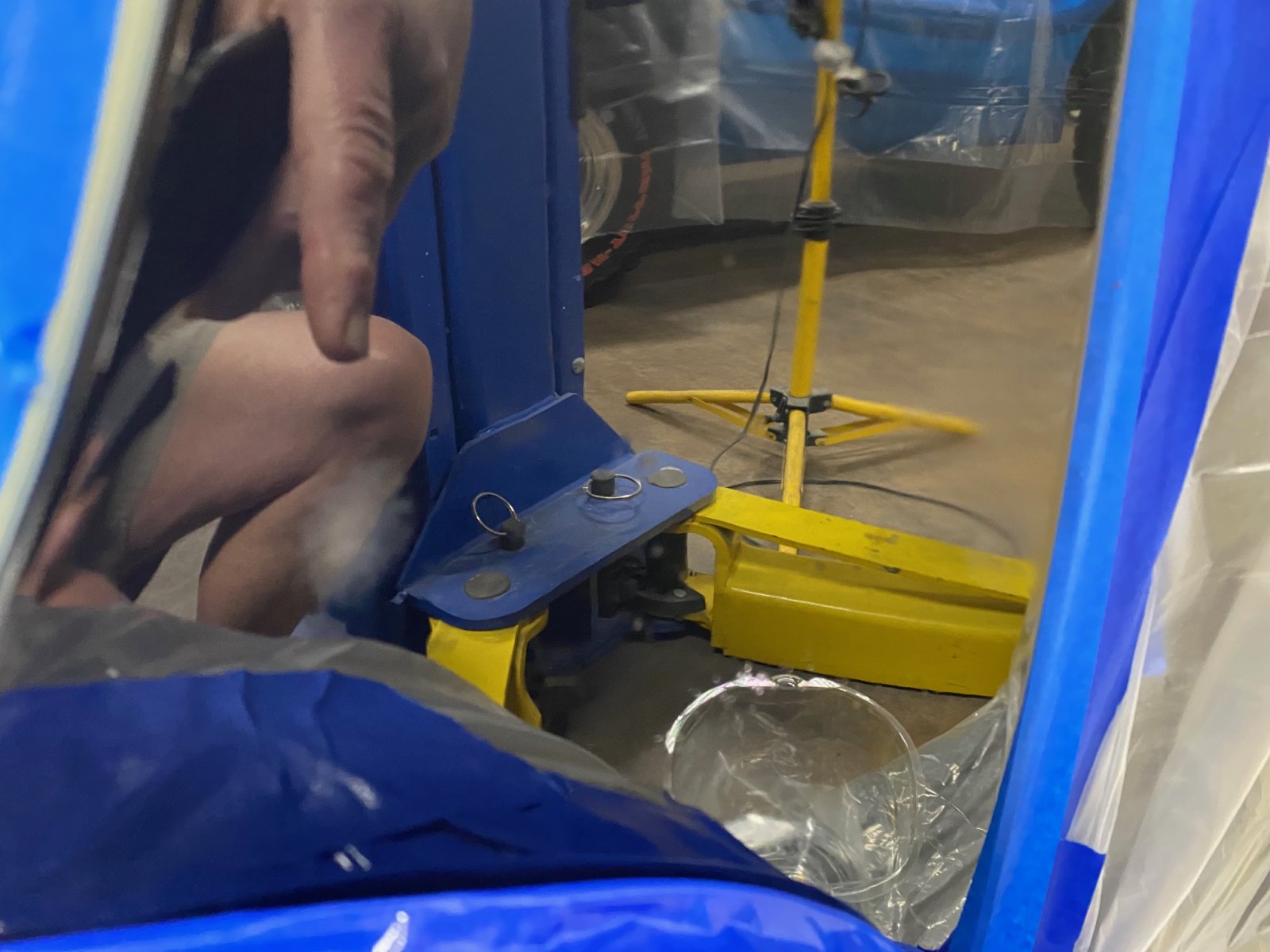

    I referred to the sheets but they talk about re-coating clear, not putting color back over it.
    I am sanded. I didn't take the tape off. I will go back out and do so ASAP.
    This is the spot with the fresh clear over it this morning. I am pointing to it in the reflection.

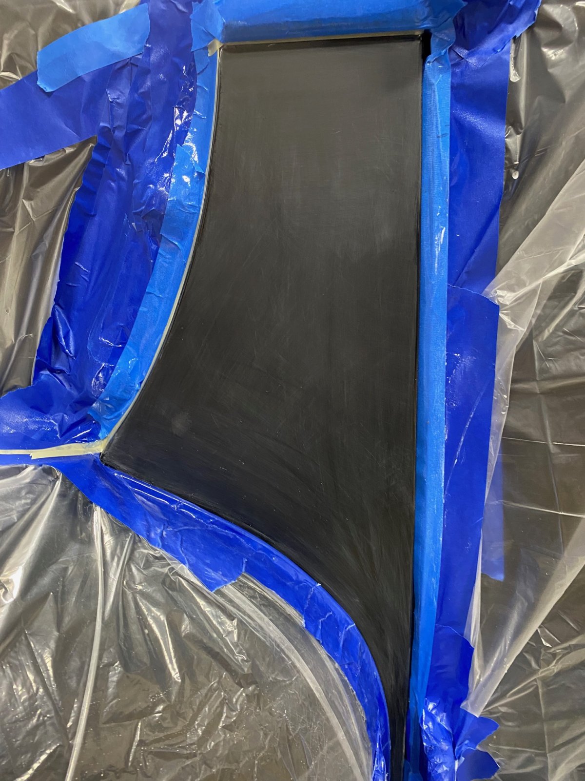

    This is it after sanding with 600 and 800.
    The materials are Lumabase base coat and Lumabase 2:1 clear with 8080 reducer. I sanded down to 3000 and then buffed with wool bonnet on the highspeed, then carbon fibre bonnet on a smaller buffer. I have more base color and will reapply in the morning after bring my garage temp up. Then clear coat. I am using my jamb gun due to the small area.
    I didn't wait to buff, I screwed this spot up a year ago and put a magnet over it so no one would know what a dumb**** I am. I knew it would take some re-shooting but I waited too far into winter and it has been too cold here to think about painting. Pin striping appointment is in 30 days and we are supposed to get back into the 20's next week.
    I chose today to get after the repair as it was 62 out and that means I can get nearly 80 in the shop. Perfect for my mid temp reducer. I am air drying and not force drying.

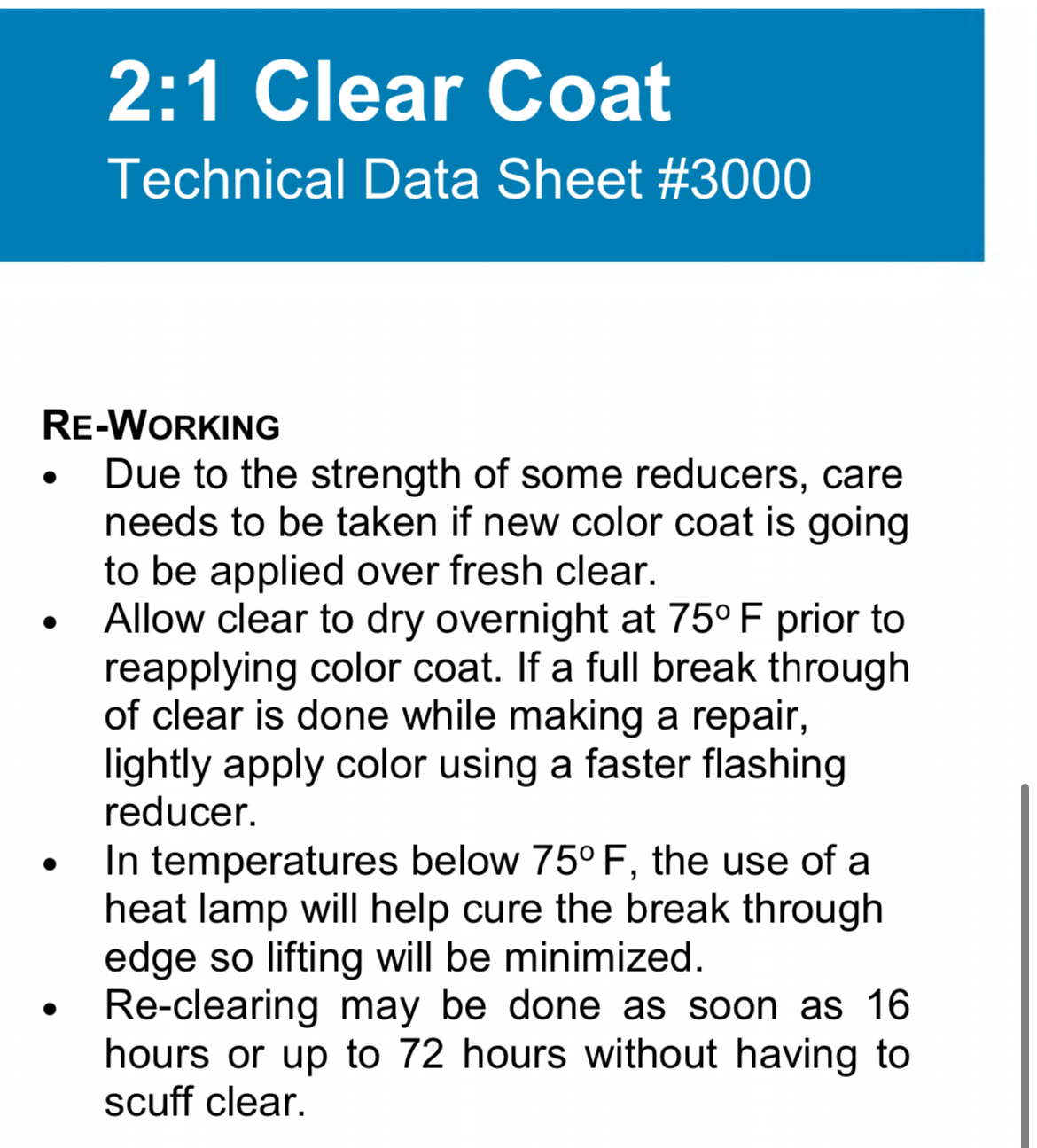

  14. Bandit Billy
    Joined: Sep 16, 2014
    Posts: 16,174
    Bandit Billy
    @anthony myrick I am confused on that last bullet point. Is it saying that I have to wait 16 hours to clear over the base I am spraying in the morning. I planned on clearing it an hour or so after color coat. Or it referring to clearing over clear?
  15. The 16 to 72 hours is the “open” time for the clear.
    No scuffing needed if applying clear over clear.
    I’d ignore that
    The important part is the reapplying color time.
    Suggests a faster reducer if the clear is sanded through.
    We had lifting issues for some clears years ago if you cut through it.
    My experience would be to choke the gun down a bit and do very light coats of color.
    Wetting it up could cause a lift on the edge. If that happens, let the lift area flash then wet sand it. Then lightly apply the base

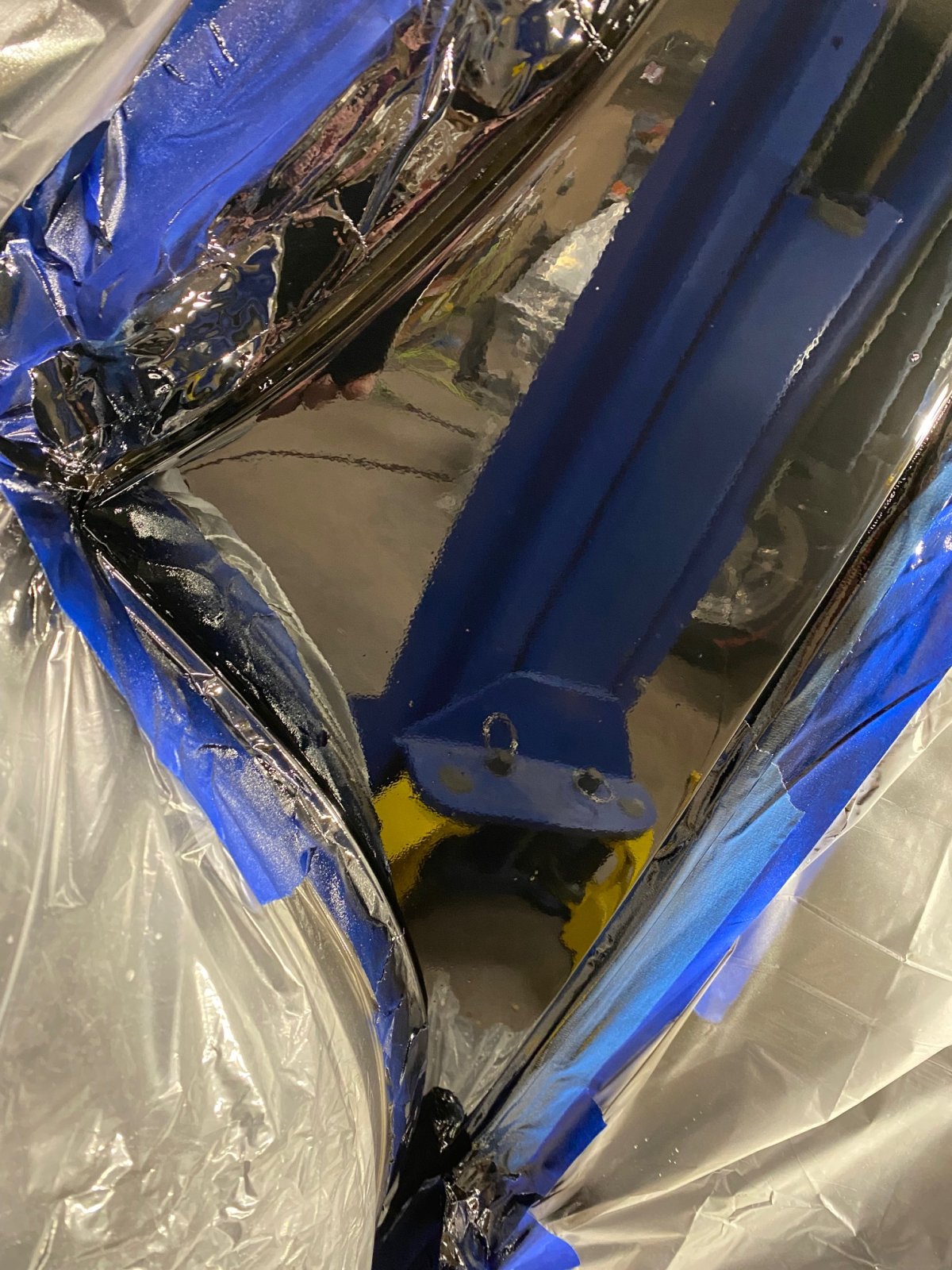

  25. Bandit Billy
    Posts: 16,174
    Bandit Billy
    Ok, base reapplied without issues, clear back on 3 heavy coats.
    Color is consistent now.
    Still flowing out a bit in the warm shop. Little sand and polish and it should look just fine
    I don't do much spot work, how long do you leave it taped? I suppose an hour or so? I never thought about it before.
