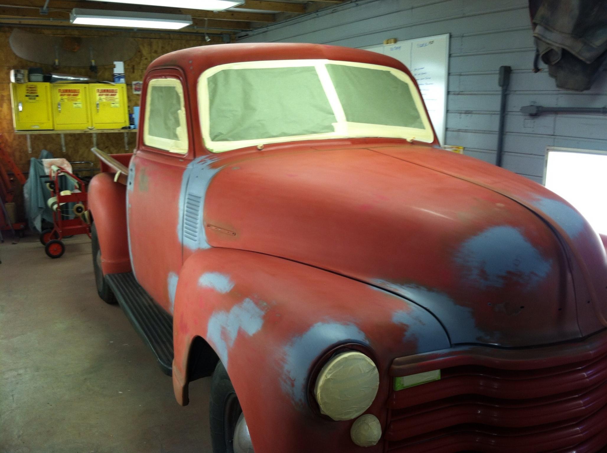

    I sprayed this Chevy back in the Spring with Kirker Ultra Glo Single stage Urethane. It was a quick scuff and shoot over a Kirker enamel one stage sealer. I added some Urethane Clear into the last coat and a splash of slow urethane reducer. Sprayed it in my booth at home. I will be using Kirker again. Looks great for a driver. Materials were a couple hundred bucks.

    In the booth.
