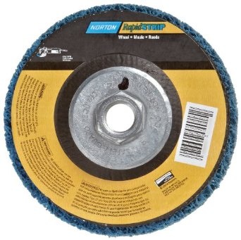

  3. image.jpg I use these...

  5. jazz1
    Joined: Apr 30, 2011
    Posts: 1,601
    jazz1
    I am using those and they will lift all the primer. Using them on my 48 chev. Got some 7" discs for .99 last week! I sandblasted my last project because I was unaware of these stripping discs and sanding discs just melted the 70 year old primer into the metal. Now I only sandblast the hard to reach areas

  7. chopolds
    Joined: Oct 22, 2001
    Posts: 6,404
    chopolds
    from howell, nj
    There isn't any easy, or fast way to do this. except sending the car off to a blaster!
    The reason it didn't work on your primer, is probably because the primer is lacquer paint. Stripper will bubble off enamels, though it takes a lot longer on catalyzed urethanes, but it just softens lacquer.
    S****e as much as you can off, then either wait until it dries, and sand it, or use those "strip discs", or scrub it with steel wool and lacquer thinner while it is still wet with the stripper.

  8. AxlButcher
    Joined: Mar 31, 2008
    Posts: 2
    AxlButcher
    from Jersey
    If you're set on using the stripper, like someone said before - try giving it a scratch with some 80 grit, and find a two foot square piece of plastic car cover. Put the stripper on after scuffing up the primer, and cover it with the plastic to keep it from drying out quickly. After it sits for about 20 minutes, if you can't s****e it off with a razor blade, you need to cut bait. It's not gonna work. The norton or 3M clean and strip discs are magnificent if you've got a compressor that can handle running the tools required. I personally prefer to strip the 'flat' body panels myself, and have the nooks and crannies sandblasted.
