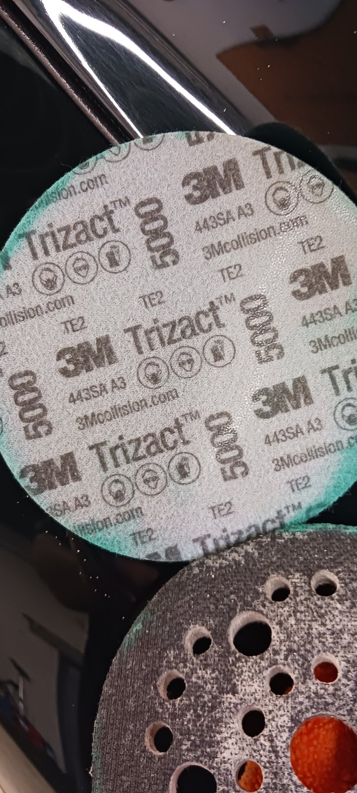

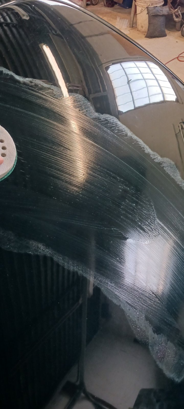

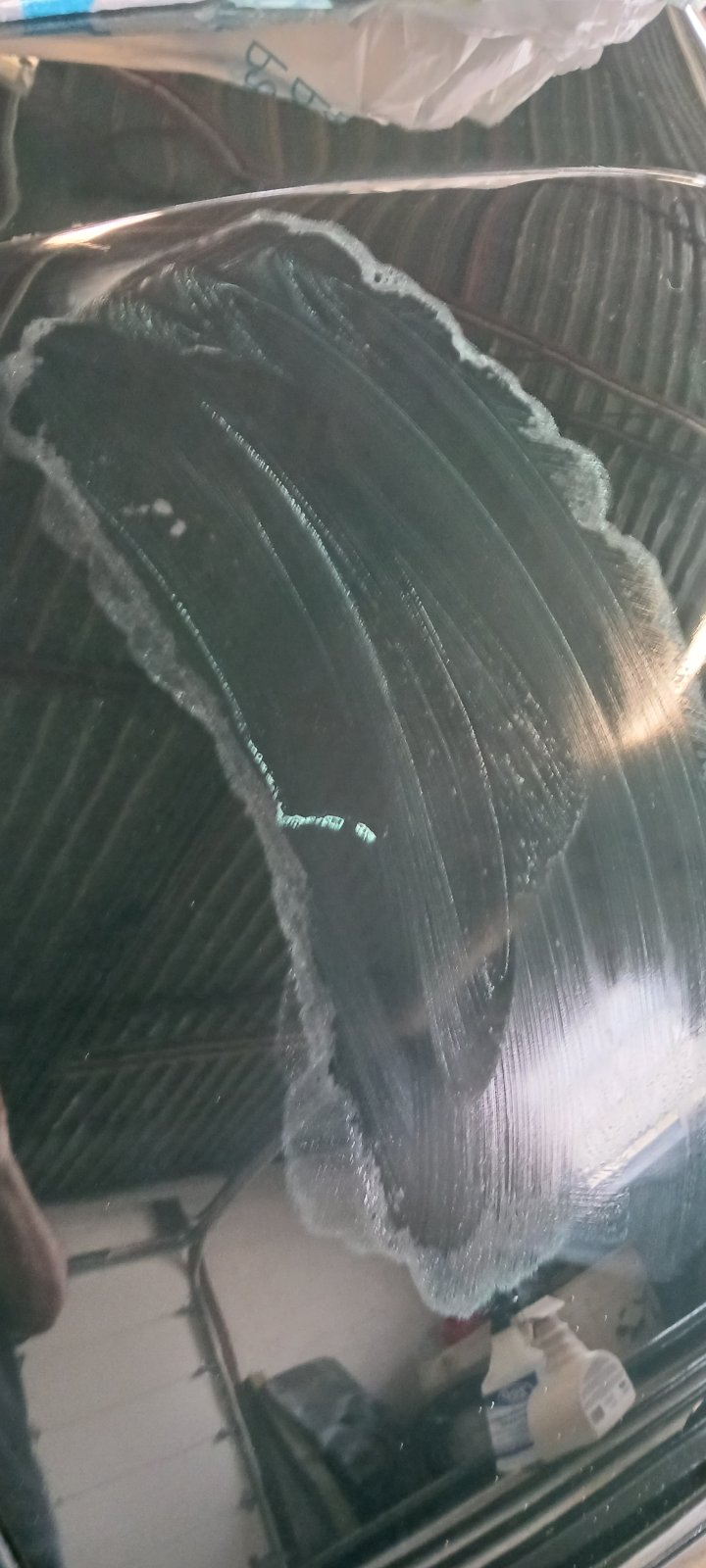

    Seems like short of a strip and refinish it's there to stay. But all is not lost. Can't make it disappear but we can make it far less obtrusive. My weapons of choice were some 1500 and 5000 grit sanding pads, some Dawn dishsoap in water (about a teas**** to a qt), a 5" grinder with a cut down buffing pad and an orbital foam pad. Here's the 5000 pad and the sanded surface:

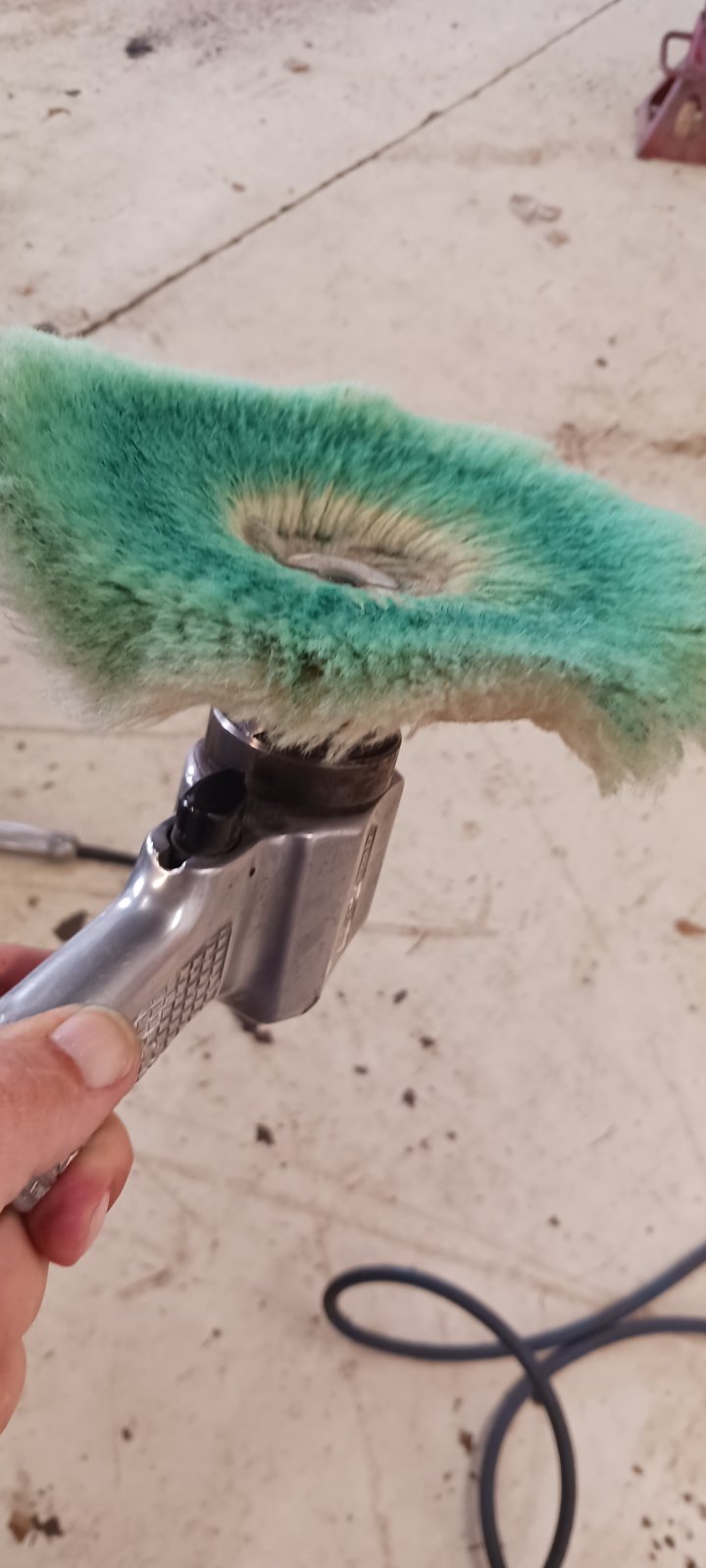

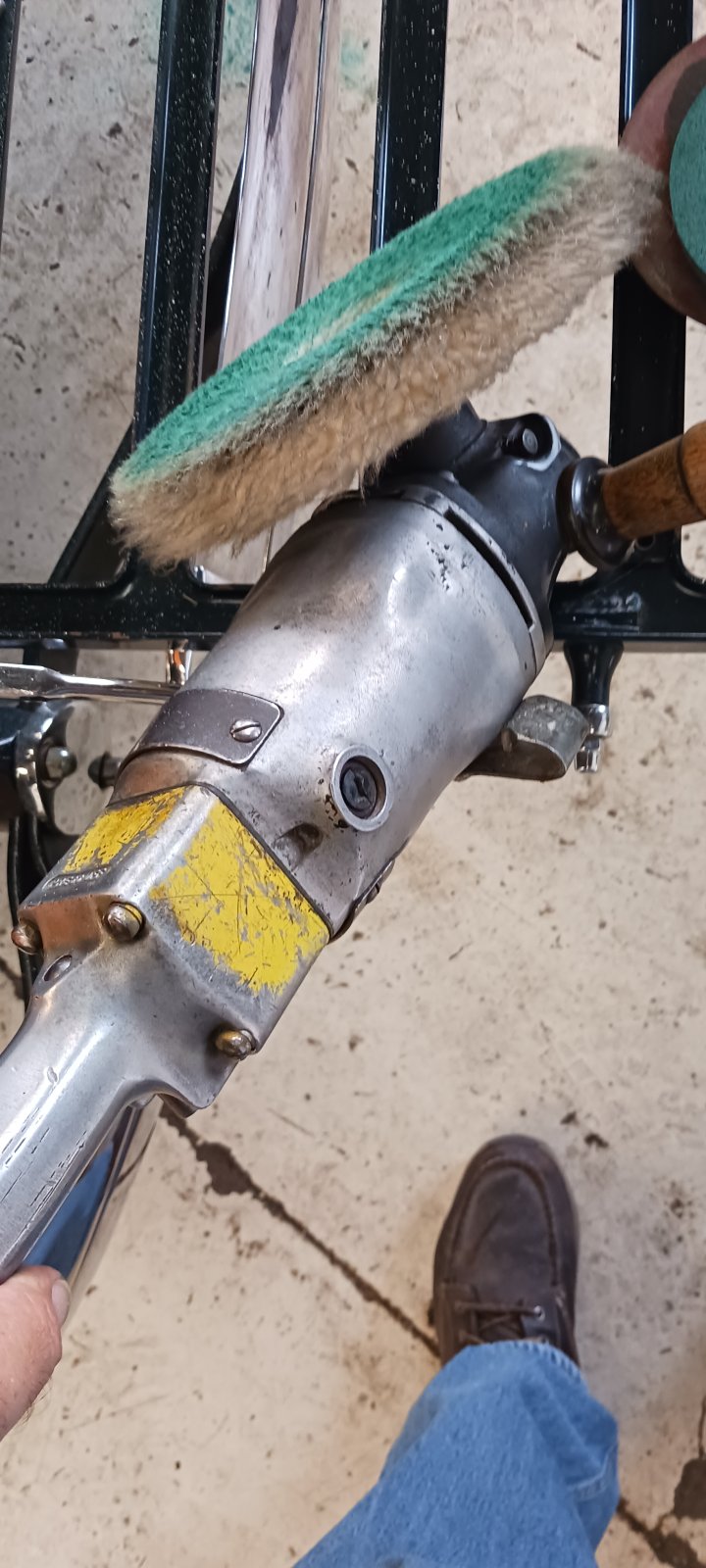

    You have to be thorough with the fine sanding so you dont have to machine polish too much. I also have an old Black n Decker professional polisher that I've used since I was 17yrs old, and it was old then (!) and yes the kind of tool most wouldn't use on a bet. Heavy and powerful:
    The 5" grinder has the speed for getting a high luster but it's not for the faint of heart. I can't share the touch and feel, but it's safe to say it comes in handy for the right job. The big one has the nuts for the 1st cut. For compound I use a mix of Maguires 3 and fine cut 3M, for the final and foam I use only the Maguires 3. With old lacquers it sort of "melts" some of the scars away. With a careful polish and good hard orbital foam pad we get this:

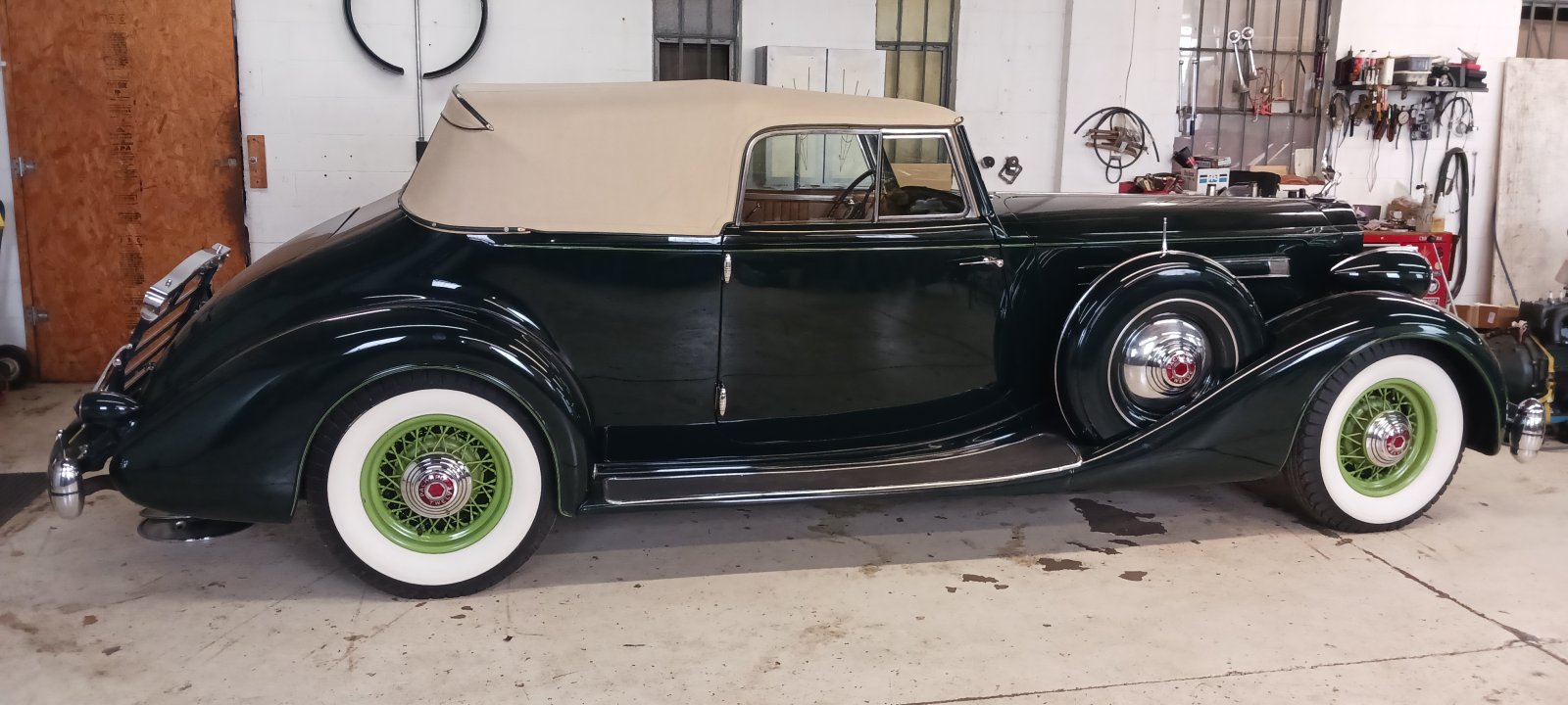

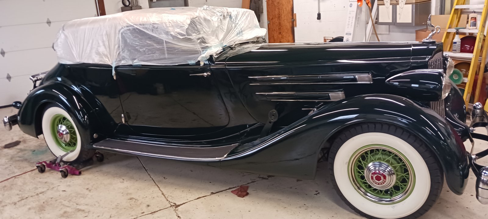

    I had no intentions of removing the blemishes completely, however the reduction was well worth the price of admission. All in this particular repair took about 30-40 min. Yes, there were such spots all over this car and some that will get sanded and paint blending. The car? What else...:rolleyes:
    1935 Packard 1207 Conv Victoria. A cpl before n after of this 12cyl beaut:
    So don't break out the paint stripper and spray gun rt away, see what you can do 1st. The transformation was worth a week's worth of effort. Go for it, and if you have any questions fire away. And yes, this works on old urethane too so no worries.

    Good old Black and Decker polisher! My dad left me his B&D vintage 1/2" drill and its body looked just like your polisher. The thing had enuf torque to tear down a building. Was a man's tool, not for the feint of heart. Solid aluminum body, no stinking plastic, two wire power cord, no sissy ground wire. A short in the wire lit you up!!
