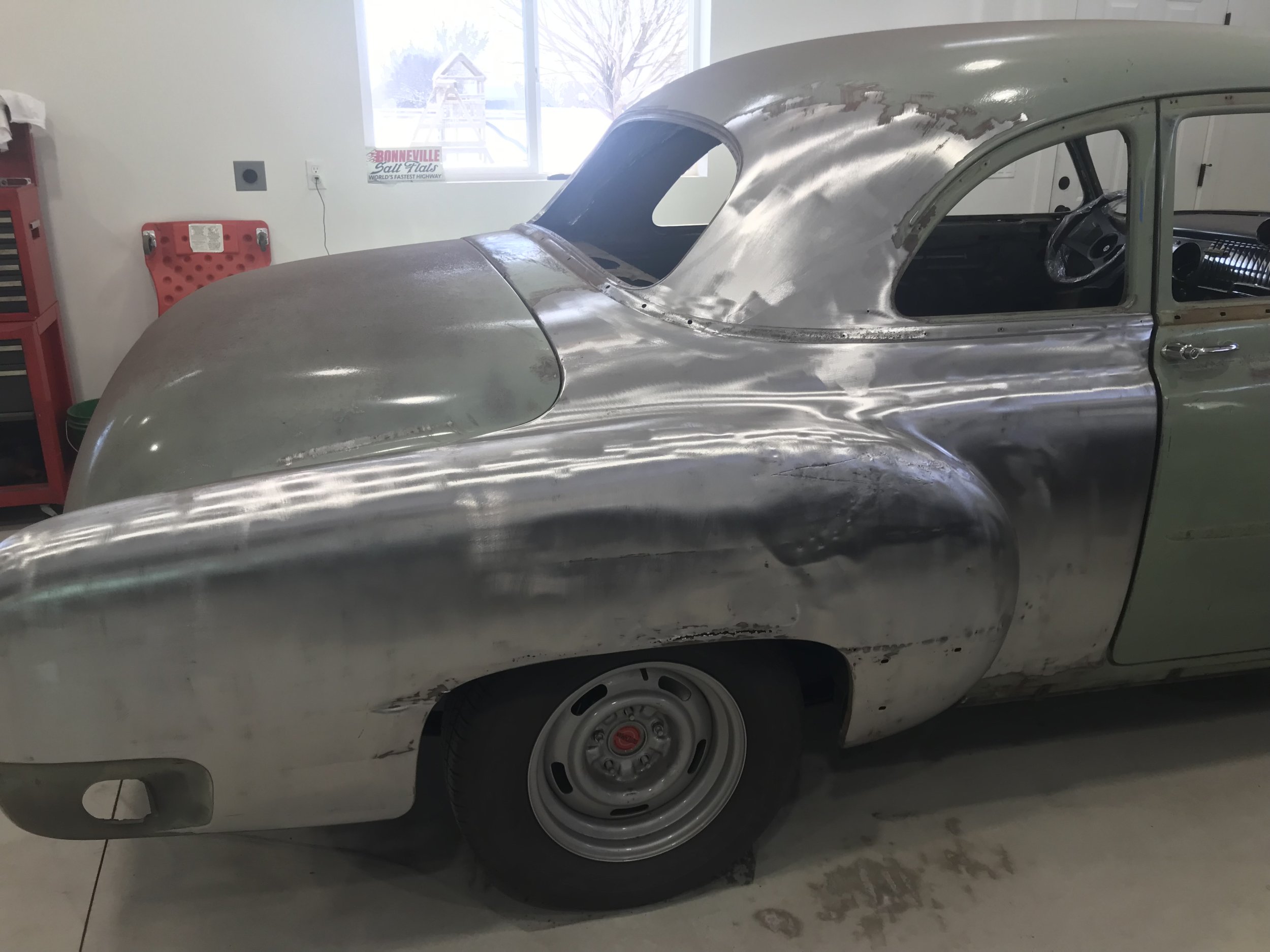

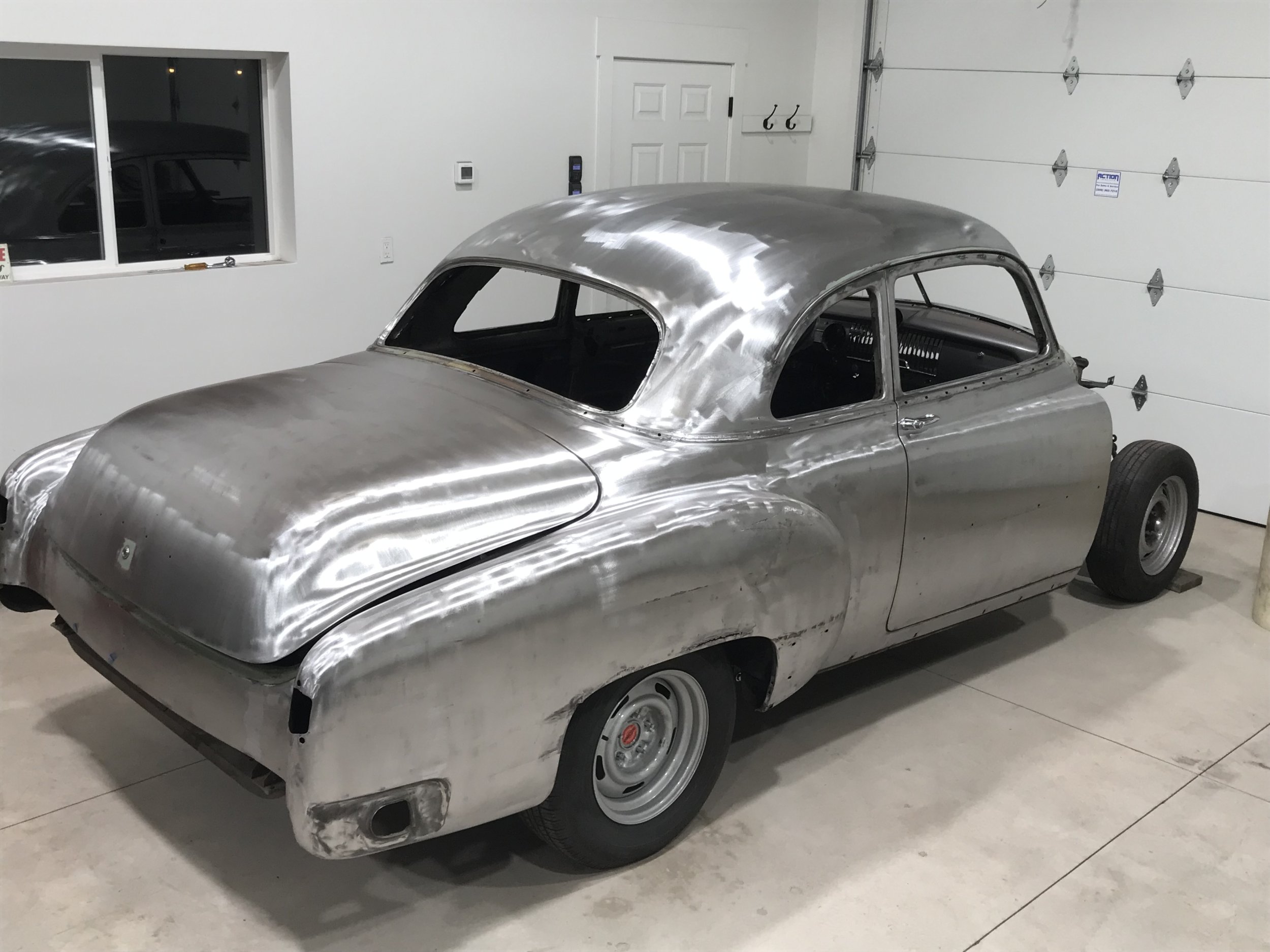

    I stripped this with the HF version of that. It worked great.
    Blues4U and swade41 like this.

    Looks great, Ken
    What should be used to protect the bare metal if it's going to be a while before it gets prmed and painted?
