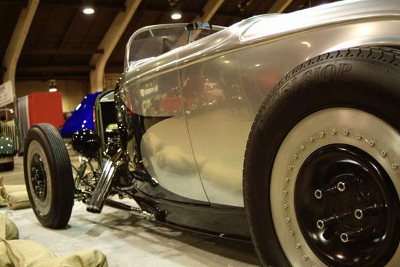

  14. Sorry for the non HAMB friendly car but I think they use the PPG stuff.
    I suppose they can afford it though!
    The picture shows the colour well.

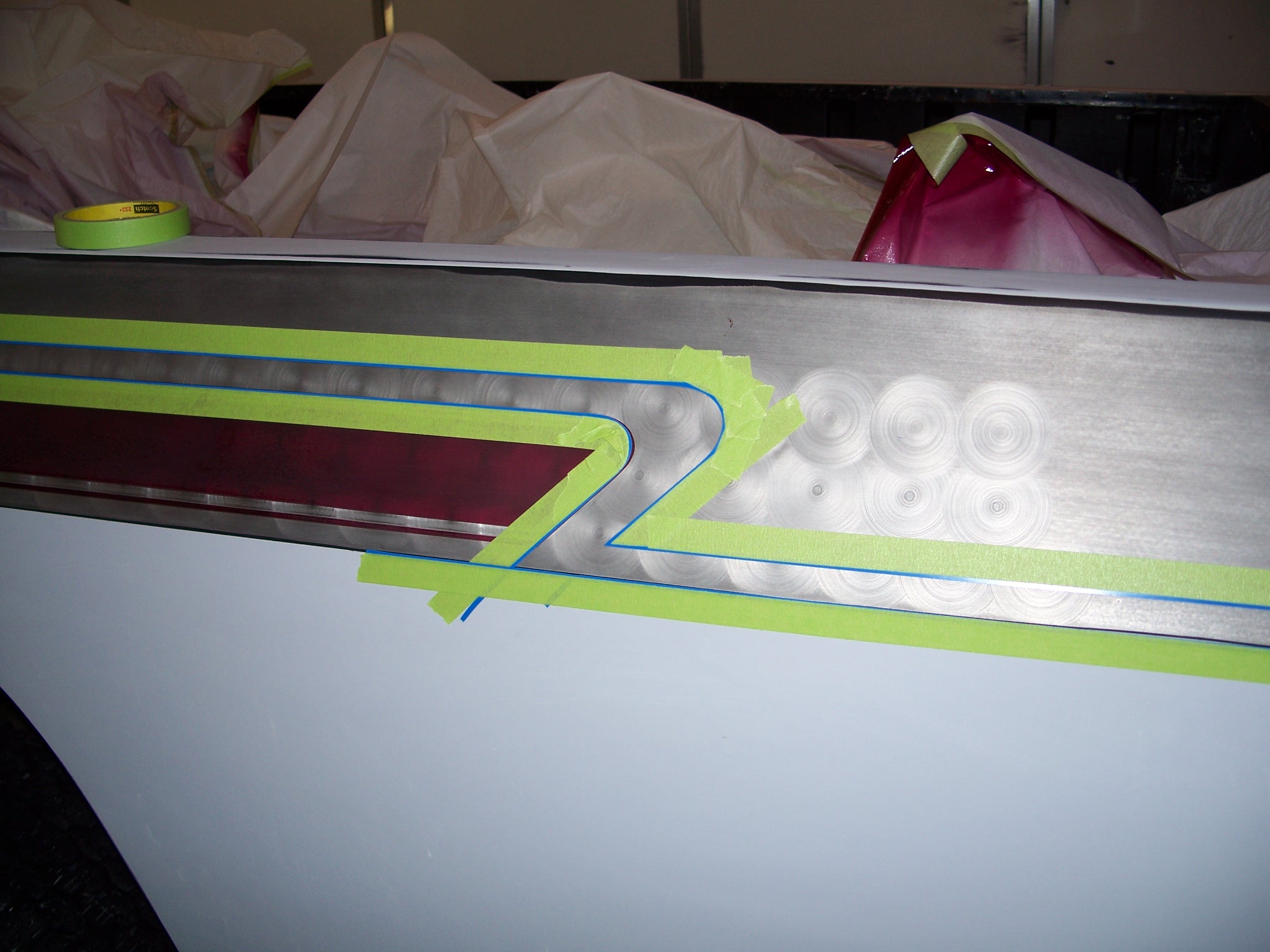

  30. haroldd1963
    Joined: Oct 15, 2007
    Posts: 1,152
    haroldd1963
    from Peru, IL
    Watched an episode of "Overhaulin" where they were doing a 1965 Mustang coupe. Chip Foose did it in green with brushed steel racing stripes. He sprayed silver for the stripes, than took a scotchbrite pad to the stripes before clear coat. Came out really cool. Here's a picture of it.
