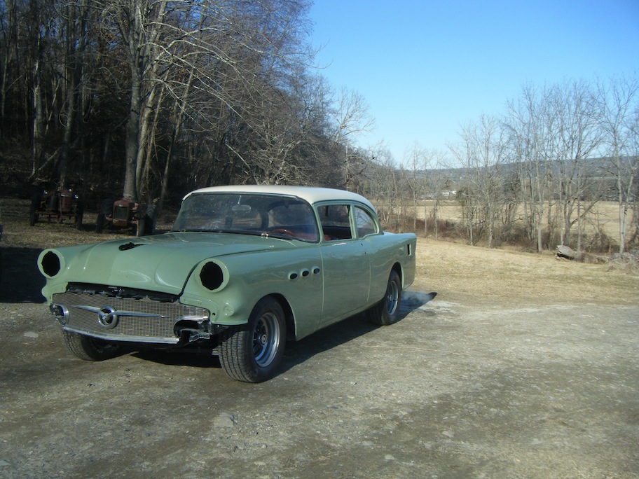

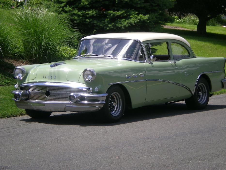

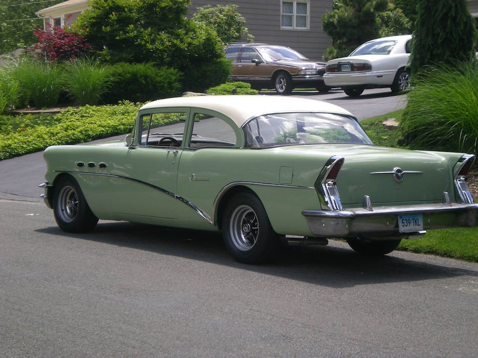

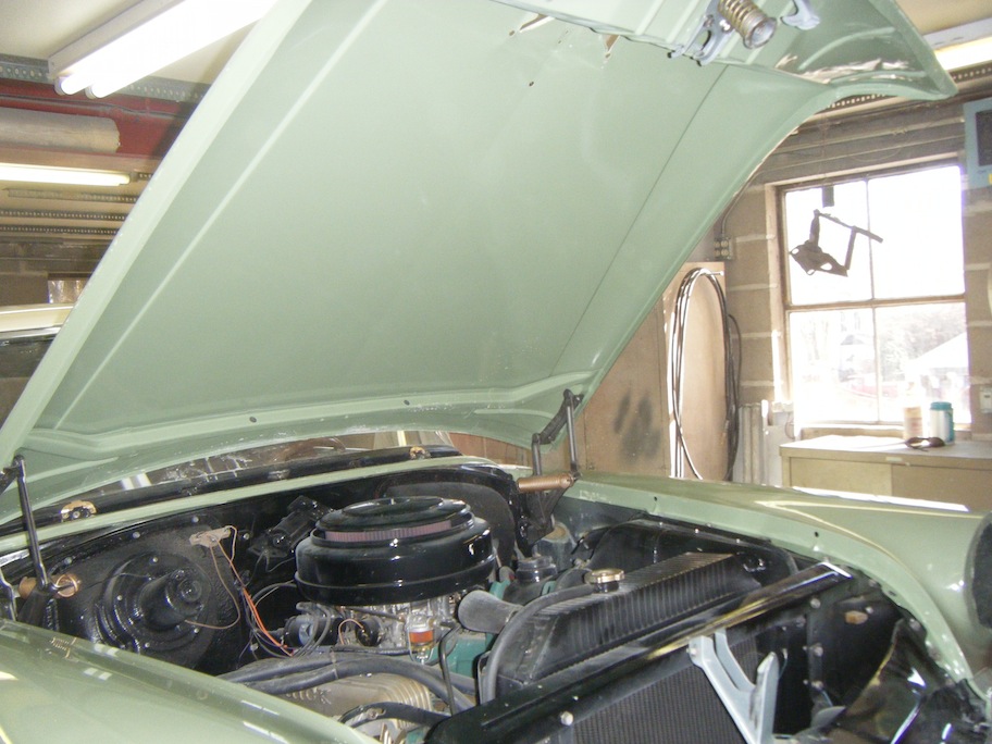

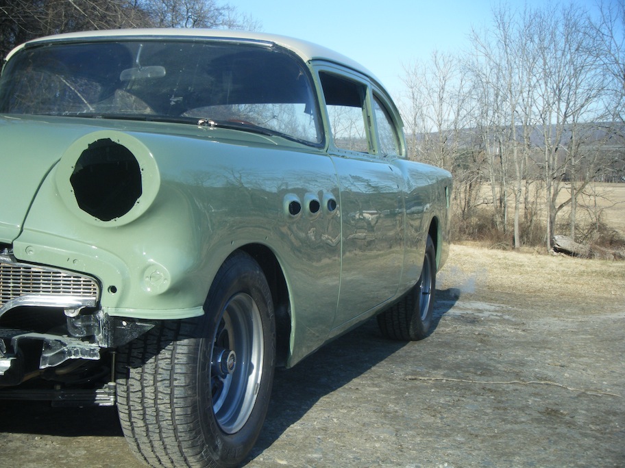

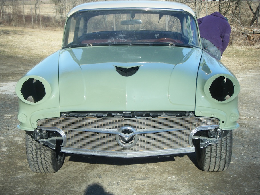

    after a ten year build, Paul brought his '56 buick for body work, primer and paint. Paul had the paint matched to a sample he found, we did the final fit on the body panels, painted the jams, under hood and trunk lid. he will spend the rest of the winter putting chrome on and working on the upholstery.

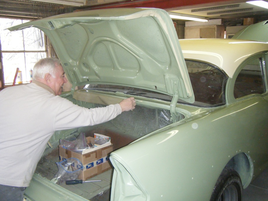

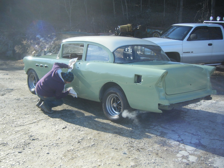

    what i had Paul do, was go to our local benjamin moore house paint supplier and find a color he liked, bought a sample of gloss, rolled it out on a piece sheet metal that was large enough to "see" the color. once he made his choice we sent the sample to my PPG paint supplier and he matched it and made a formula. i bought a small test sample and did a spray out under the trunk lid which Paul approved. if we had to change the color, the test paint would have been used for the first coat so it wouldn't have been wasted.

    paint is PPG dcc, and the custom formula is 914595 main layer, ford kiwi green.
    dmc900 str white-2855.7
    dmc919 yellowlf-822.6
    dmc929 light red-297.2
    dmc908 yellow-297.2
    dmc937 green-274.1
    dmc902 black-205.5

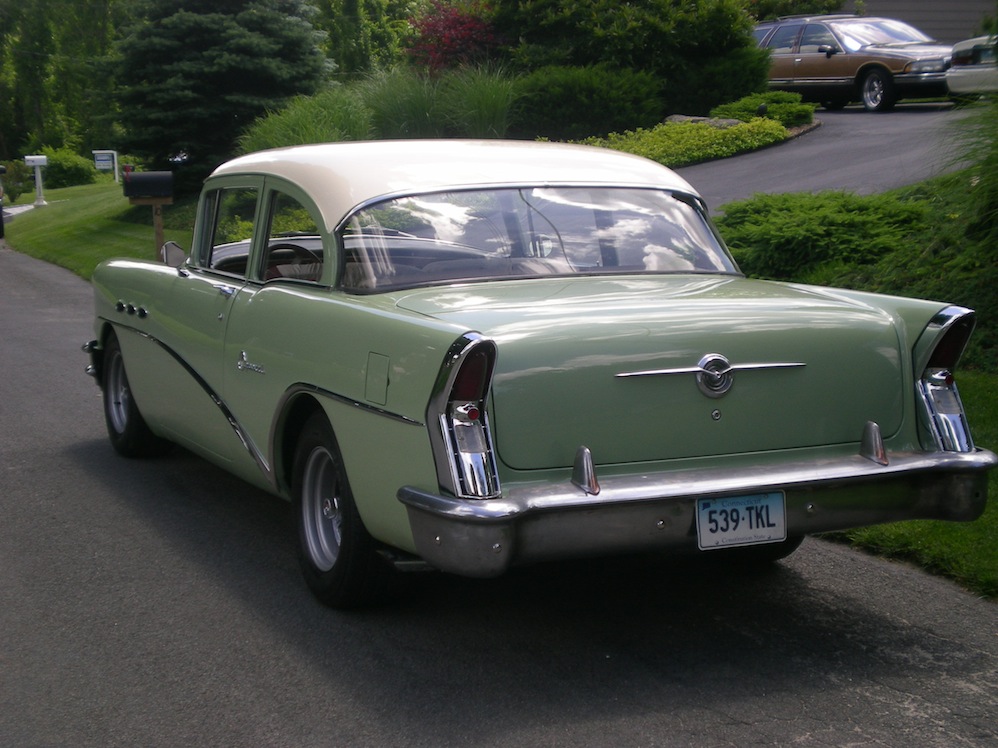

    stock later buick centers 5x5, with 8"x15 outers welded to it. 235-60 x 15 tires.

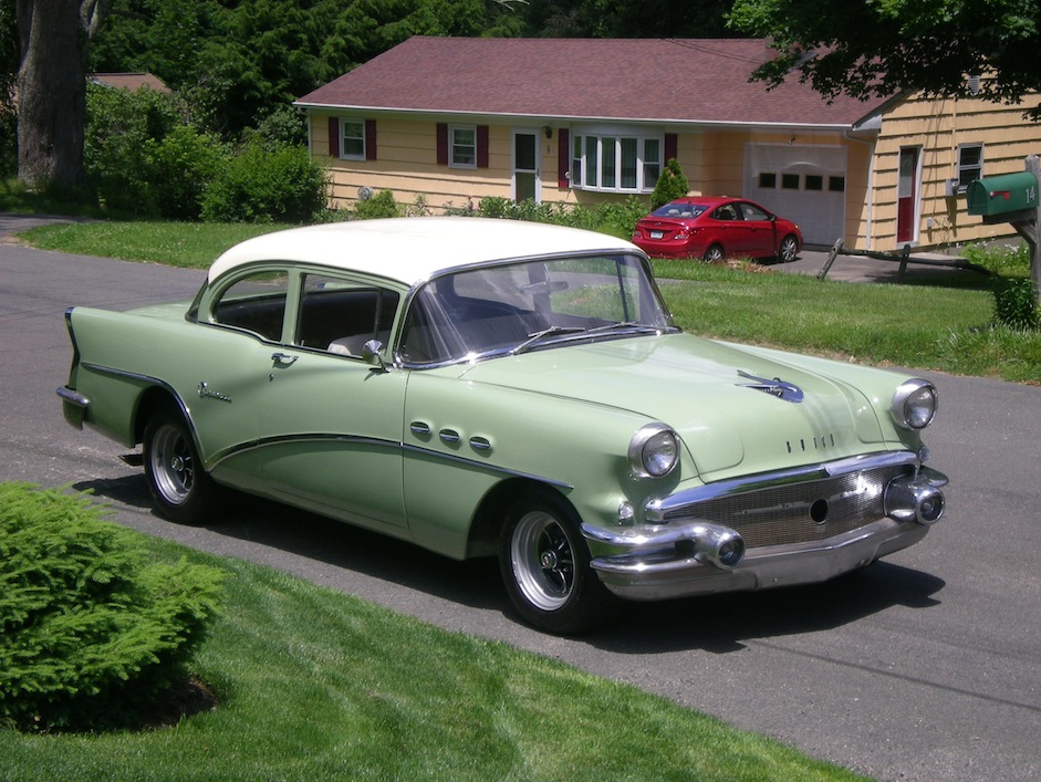

    Paul, has just about finished putting the trim on!
