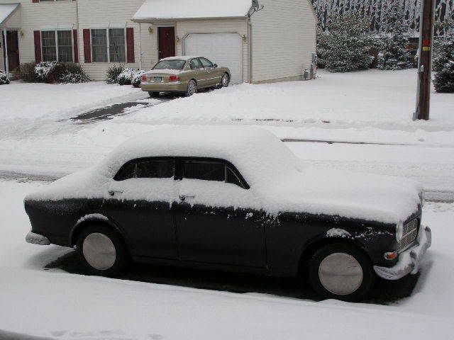

    I painted my daily driver "hot rod" styled Volvo Amazon with semi-gloss black Rust-Oleum , thinned with acetone & sprayed with my siphon-feed gun . I drove it everywhere , it sat outside 365 and it retained the same sheen and didn't chalk-up whatsoever . I'd do it again anytime , just not on something I was planning on repainting someday with "real" car paint .
    Here's the "Suede Swede" after about 3 years of being my work horse ...

    Does this sit outside most of the time? Inside during winter is understandable.

    I sold the car to get my '49 Ford project , but YES , the car sat out 100% of the time . No garage time for that ride !
    Driving in this :
    Results in this , lol !
