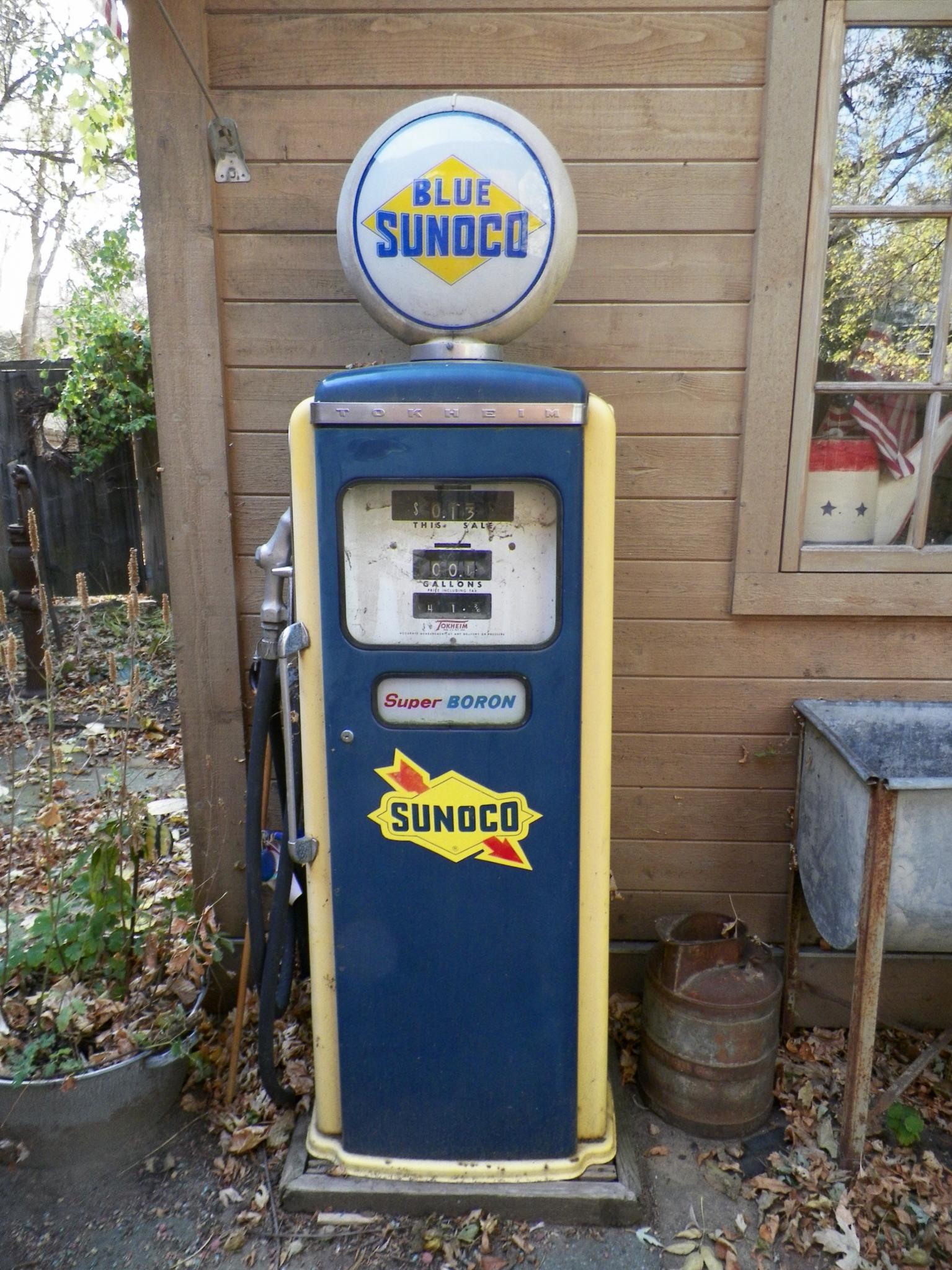

    I haven't painted a car body with Rustoleum, but I did paint the frame with Rustoleum black, and it seems to be holding up pretty good. I also painted this gas pump in '93. The paint is getting a little faded and chalky, but it has been sitting outside for 19 years, and has never been waxed or polished.
