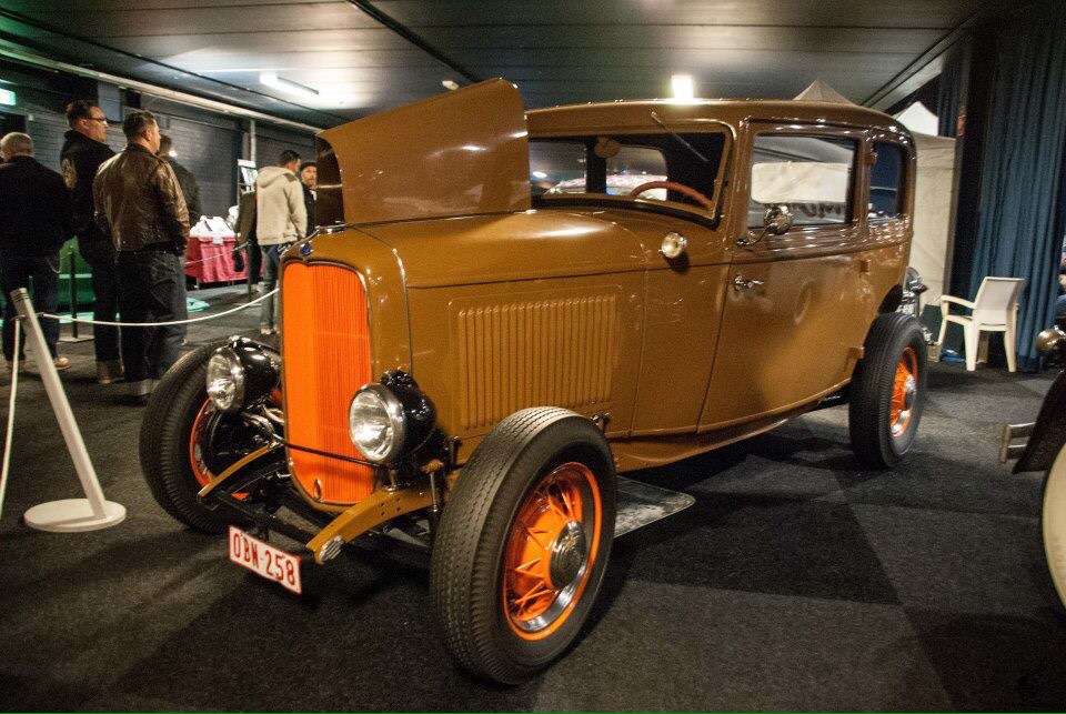

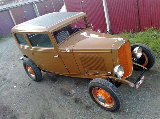

    from Belgium
    my '32 sedan completly done with Rust-Oleum combi color paint, body+ch***is+engine
    NO wet sanding or polished afterwards !
    A Boner and kidcampbell71 like this.

    kidcampbell71
    Nice. You realize you may now be the first SHOW CAR Rustoleum paint post yet ??
    I love this thread. You have a great looking car....especially with the paint choice. Greatness man. She looks great in her show paddock for sure.
