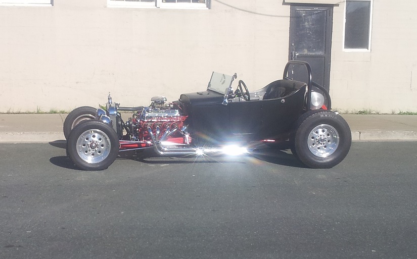

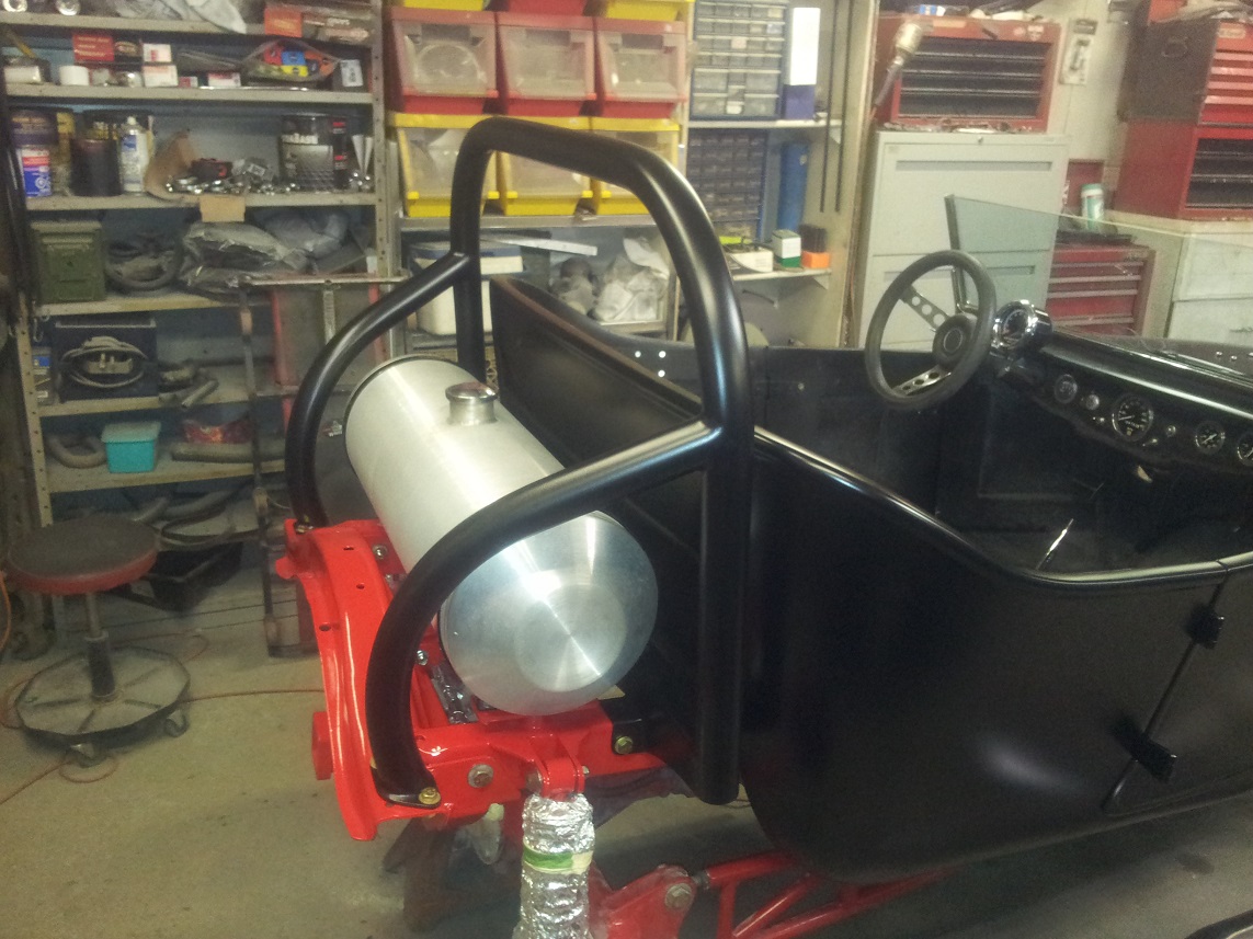

    2014-06-18 18.32.09a.jpg 2014-09-28 10.01.44aa.jpg 10703711_10152770672874766_2512669299518686630_n.jpg
    Sprayed my T Roadster with Rustoleum/Tremclad.
    I like it and will use it again.

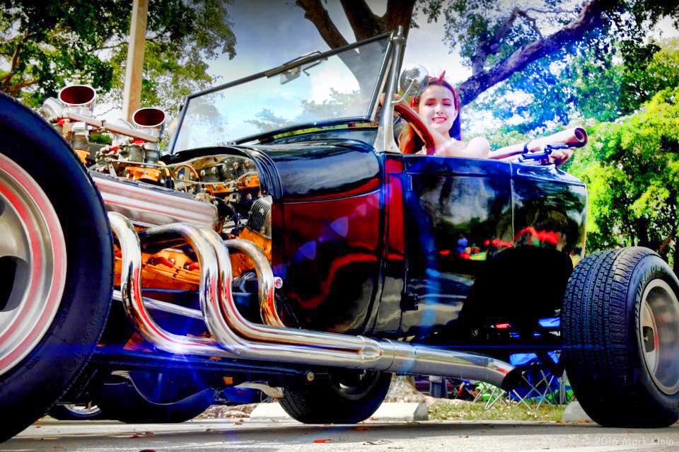

    I used Rustoleum gloss black in 1960,got good look for me,an have just kept on using it each time I painted my hotrod,I still drive. I do use enamel hardner as others have said. Preprep is a lot of getting a good look an I always give it a full week or more before buffing out. At shows most don't beleve me,if they ask what I paint it with! Fact is my rod only takes a qt. + thinner & hardner,. I'm aware its not as hard as two part big $ paints,but I'm a low $ guy,so maybe put more time into making it smooth before the gloss goes on then some do. Frankly I think even if you blow big $$$$ on paint,it still will not look good if it was not smooth before the shiny was sprayed on. MarksPicof My rod.jpg

    Wow! Just about the exact color I have in mind for my tudor. Looks great!

    Nice job on the paint. The money you saved on paint, you should be able to spend more money on cool stuff. Nice job.

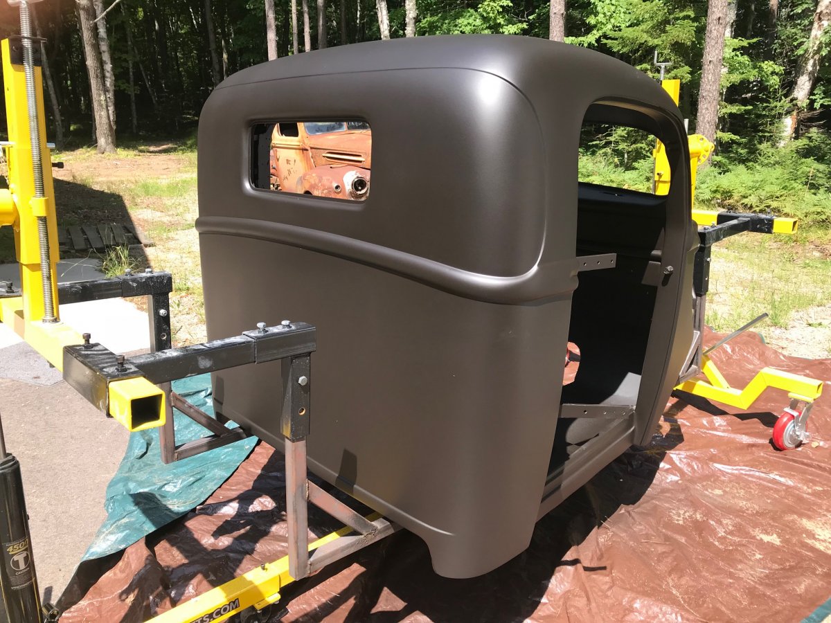

  19. Another rustoleum job. A custom mix of flat brown and flat black. Couldn’t be happier and spent $32 on paint and acetone.

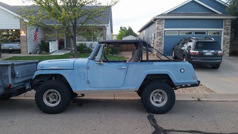

    I did my old Jeepster in Rustoleum a good 10 years ago. You can see right behind the door, where the top protected a strip that didn't fade.

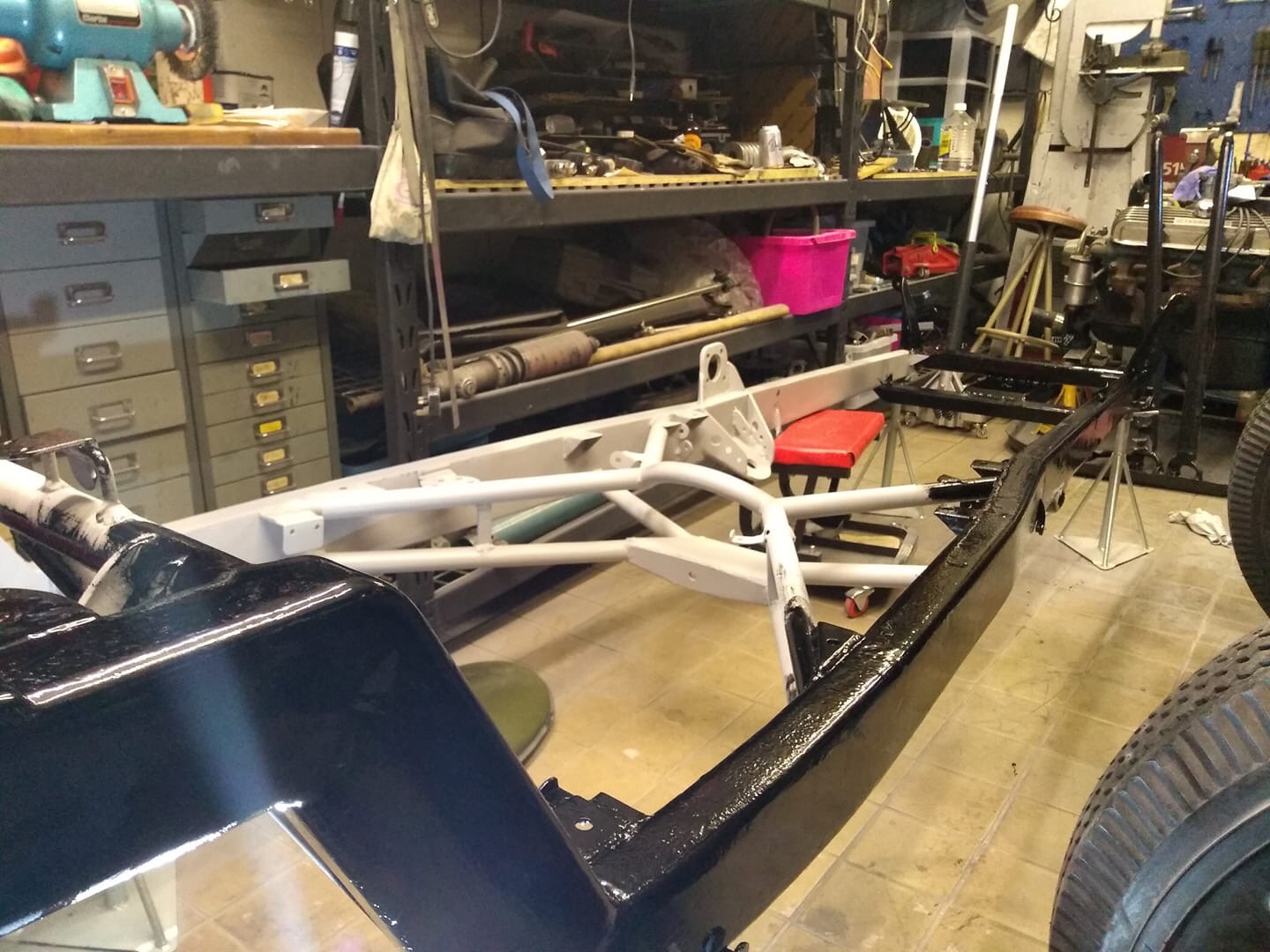

  26. I’m going to use Tekaloid to brush paint the body of my 27. I painted the ch***is with it today[​IMG][​IMG]
