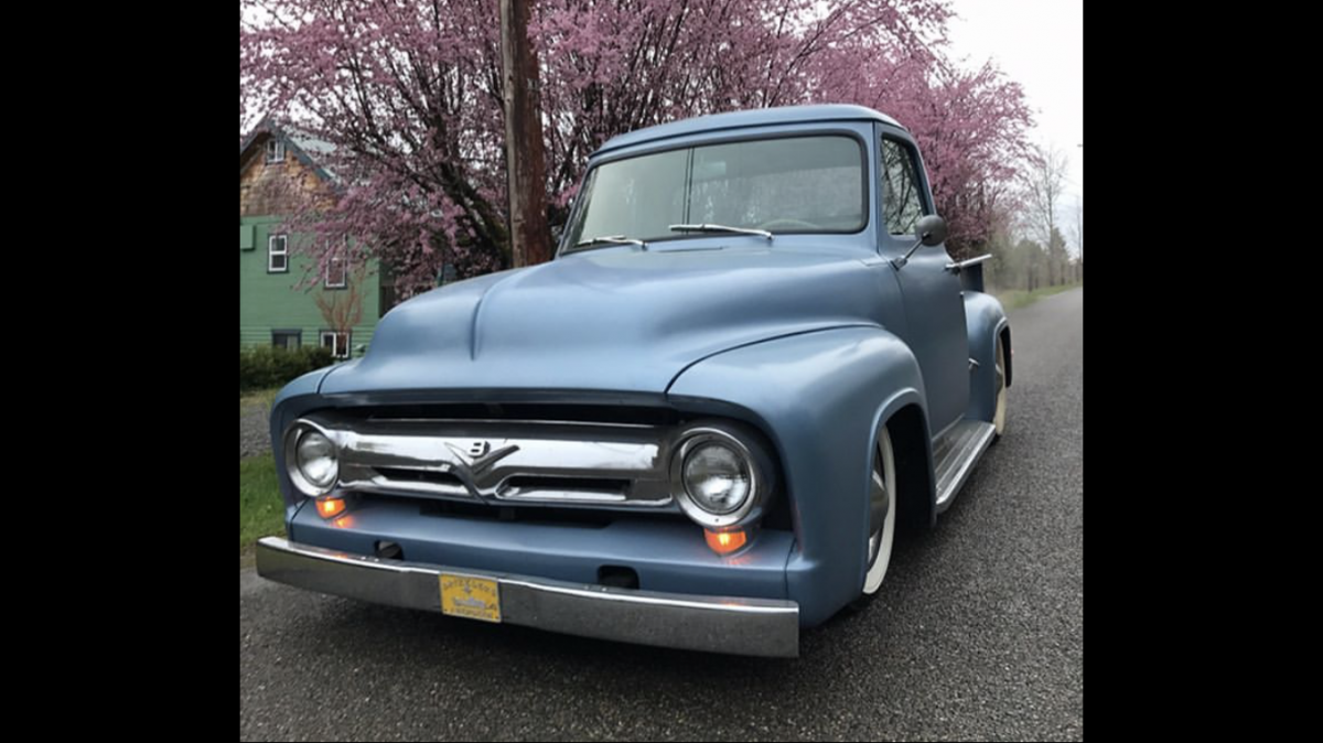

    I painted this pickup with Ace brand rustoleum used Napa Pih 50 hardener thinned with lacquer thinner
    Had a great satin finish which is what I was after 9BC0D5D1-BFE1-4F3F-85CE-98D03668F46A.png

    303BF989-77A4-444B-A12F-957292C89372.png Here’s another Ace brand “ Rustoleum” job
    Custom mix satin finish using NAPA PIH 50 hardener and thinned with lacquer thinner
    Came out great

    I know this is a very old thread, but may I ask what colors you mixed to produce this color? And the same question for the blue one a couple above. I actually joined this site specifically to ask you this
  16. F-head
    Joined: Oct 20, 2007
    Posts: 1,666
    F-head
    The gunmetal gray coupe was Ace brand Rust Stop Satin black and Silver
    Be careful with the silver as it’s really strong
    The Blue 53 pickup was also Ace Rust stop
    3 parts International Blue
    1 part Silver
    1/4 of a part Harbour Blue
    And a dash of yellow to steer it away from purple
    Both cars used PIH 50 hardener and Acme FT220 lacquer thinner
    Used an old siphon gun
    Painted them apart but the parts match pretty well
    Metallic is always risky to paint apart
    Hope this helps
    Bruce
