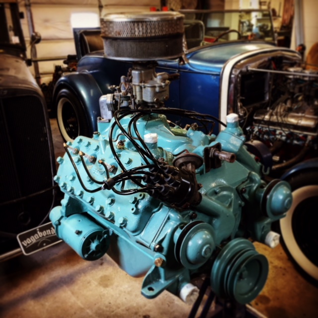

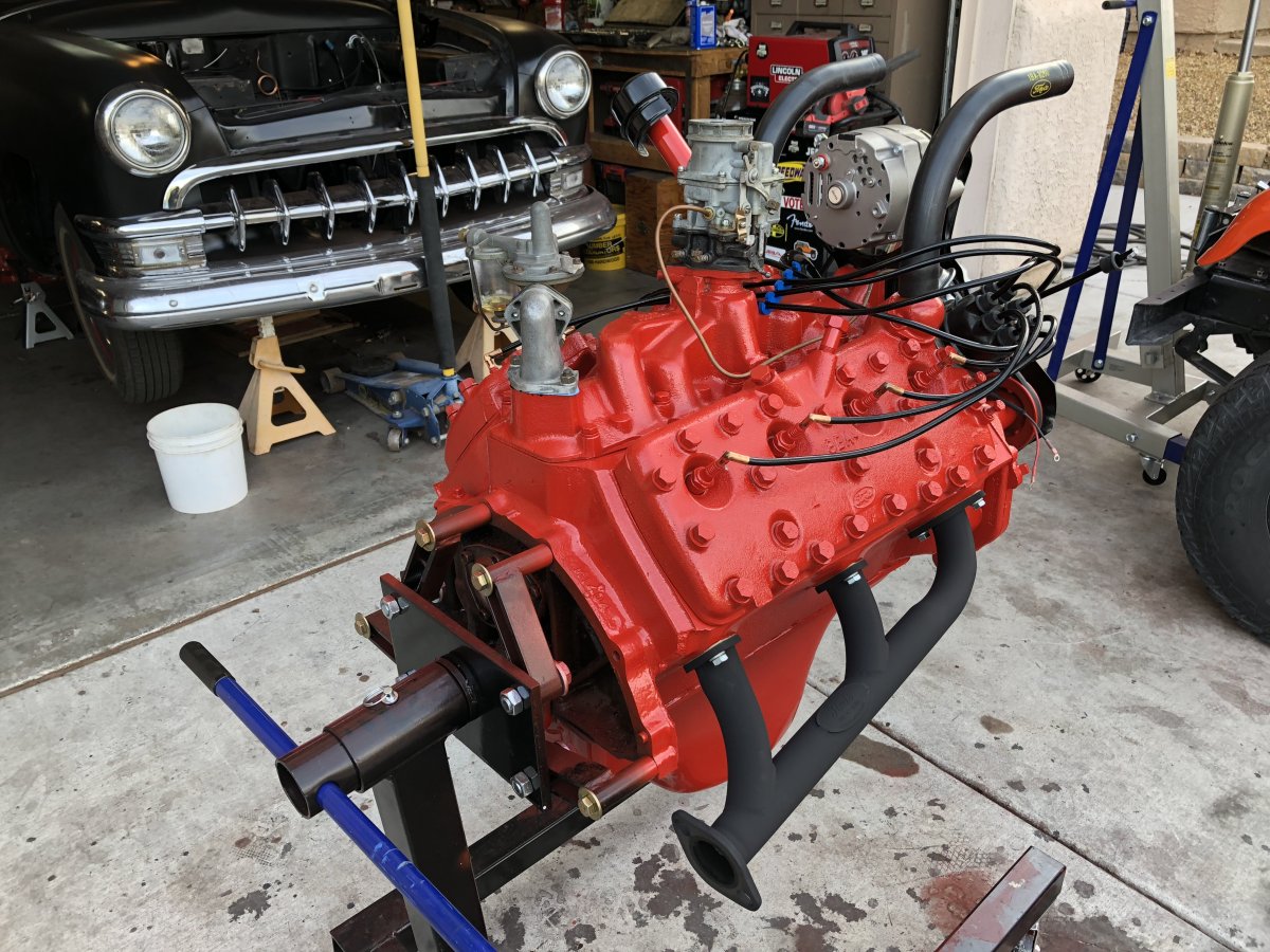

  22. I did this in my driveway - Old Ford Red from O’Reilly. Came out pretty good. 77D744AB-D72A-4DB0-AC29-7427852E1428.jpeg
