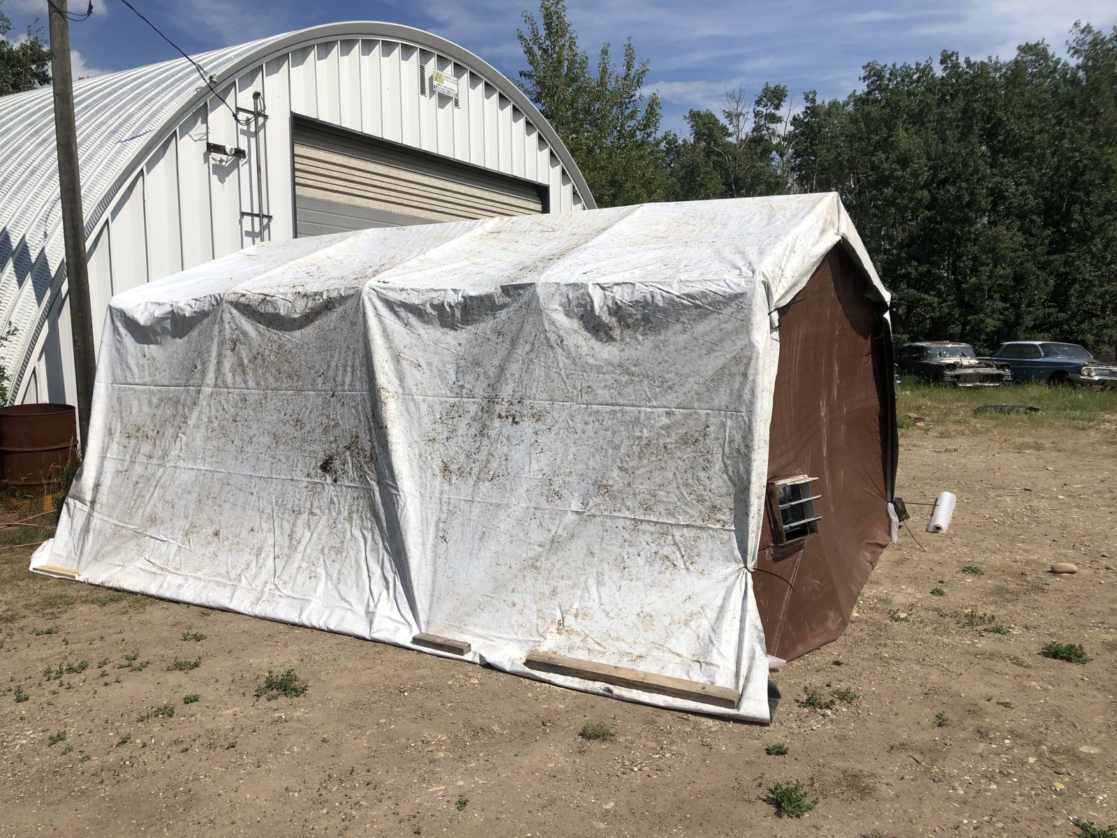

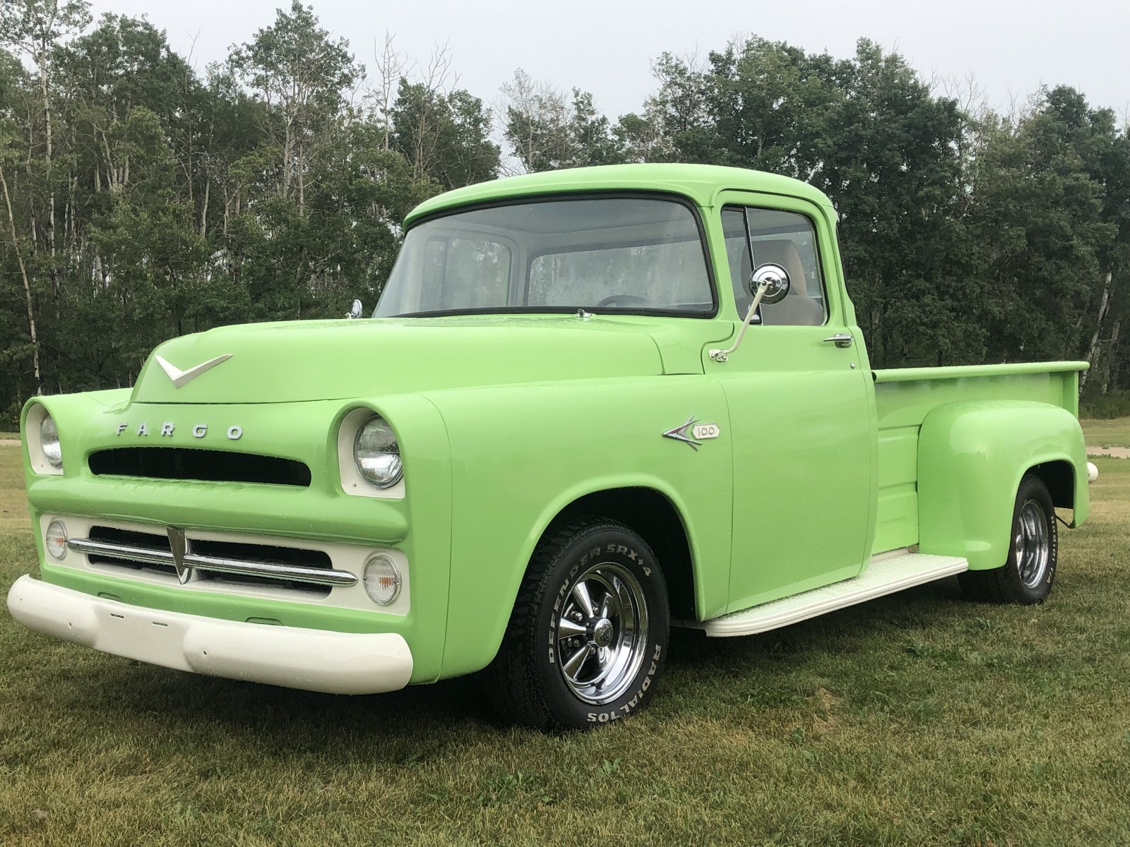

  27. This
    was painted in this
    Don’t be afraid to take a shot at it.
