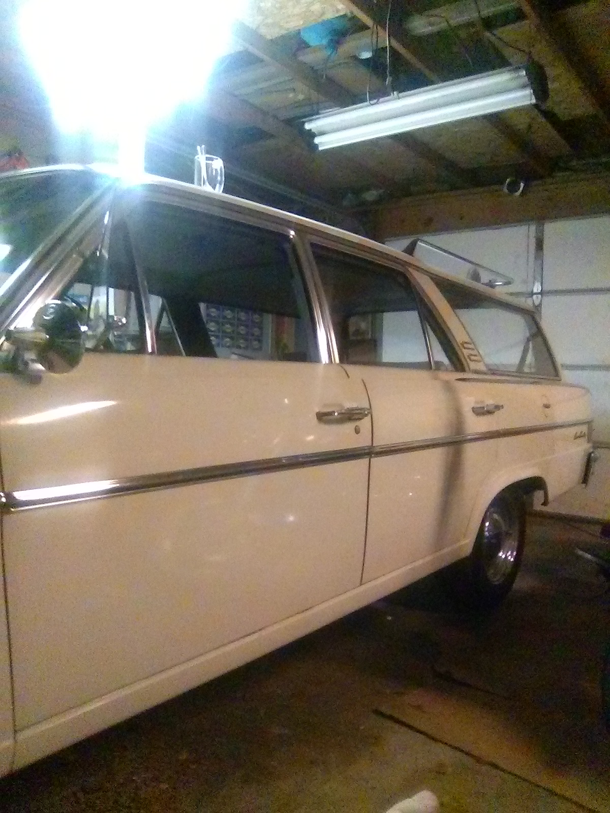

    I painted this car in my garage. Rustoleum Antique White rolled on with high density foam rollers. Buffed it out with harbor freight variable speed buffer and foam pads with 3m compound. Materials cost me a little over a hundred bucks. Not the best way but I could afford it and didn't have to trust someone else with my car or time.
