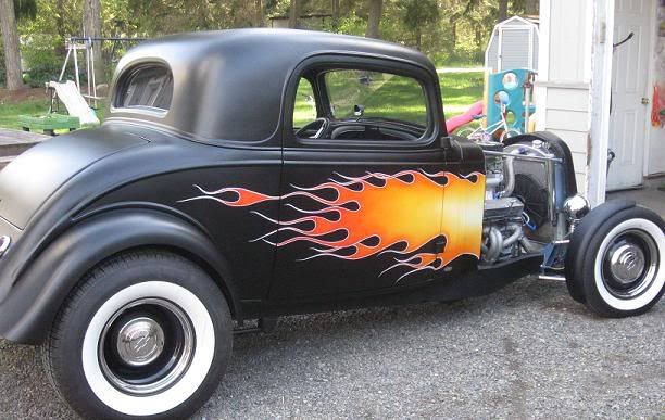

    My first question is what kind of neighbors do you have? I did my 32 outside and was lucky. Live on a dead end street and two of the houses were vacant at the time. As mentioned single stage was best. I used BASF Limco Synthetic Enamel. Favorite time to paint was Sunday mornings around 10am. The bugs werent up yet and the wind was low. They were all sunny days, and as luck would have it, it helped UV Cure the hardender.
    The next car I am starting this month, but I planned ahead. I placed a craigslist ad, and found a local paint shop, about 8 miles from my house, that will let me rent their booth. I am paying by the hour, and the owner felt good enough about me to let me work on sundays by myself and even use his guns. (I am still bringing my own.)
    Plans are to do all the fab on the frame, mabey have the body ready to prime, take it all out and prime it on one sunday, then spend the week sanding it down for paint the following week. No rush, just to do the job right. Having a nice downdraft to use will be a treat.
    Even if you paint outside, its all about the surface prep. Know your gun, I used a TP Tools Paint Turbine and reccomend them. I painted two cars with them. You cant shoot heavy primer with it. I used a 1.8 siphon for the primer, 5 star hotrod primer, and 1.4 siphon for the paint. Follow the instructions. Wait the time you are told to between coats. You can apply a few more without penalty.
    You can paint the car in pieces if you like, but I suggest have the body bolted to the frame final like before you shoot it. Chances of your gaps being off are far less. I will never paint the body not bolted to the frame, especially with open cars.
    Good luck on what you want to do and post pics of your outcome.
