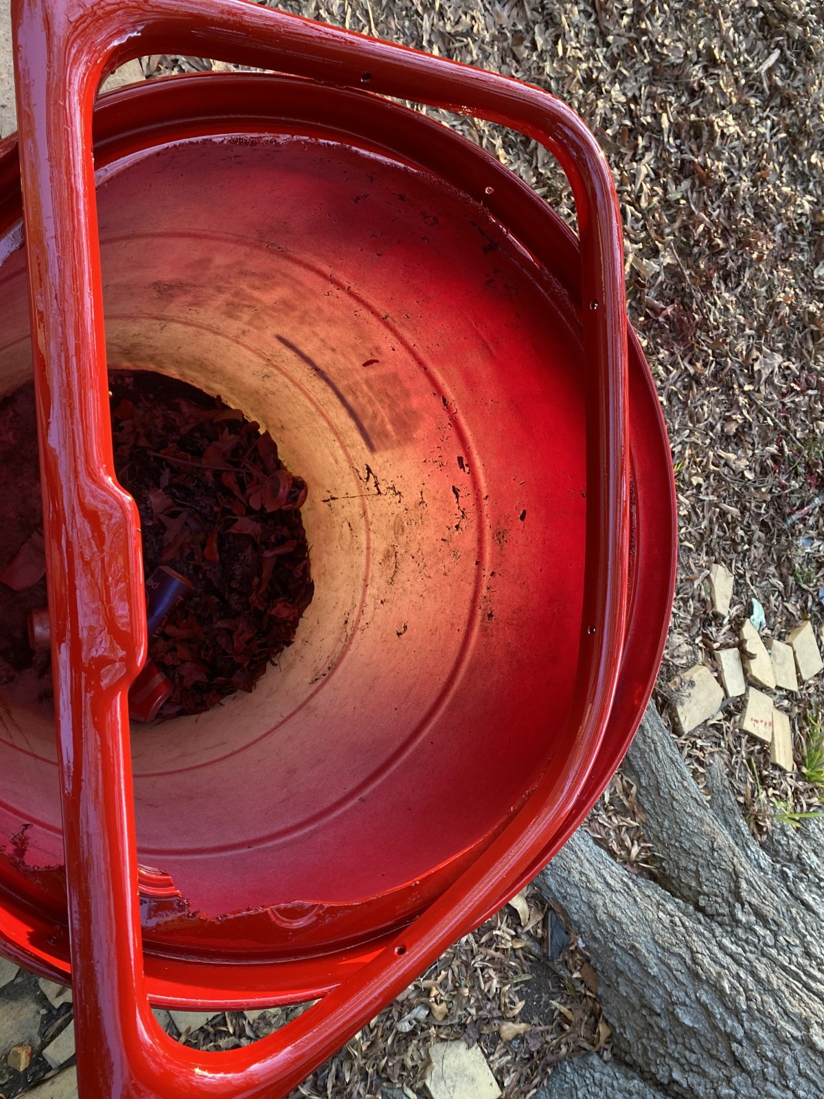

    IMG_2978.jpeg Well here is the first pair. Worked pretty good other than one mosquito that wouldn’t bug off. Two coats later sealed her fate. Lead to one run no matter on underside edge and the window felt will cover it.
    Two down two to go.

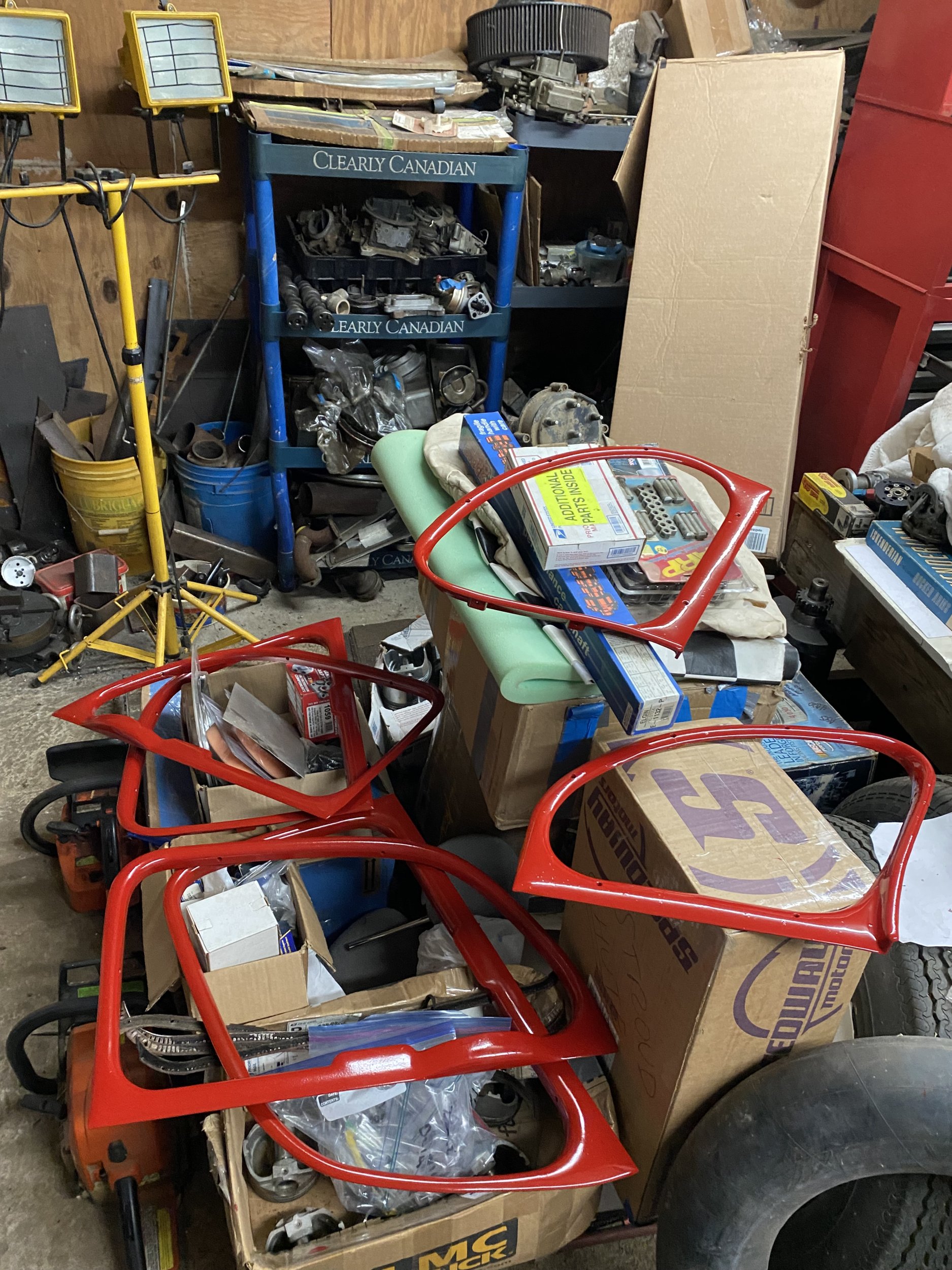

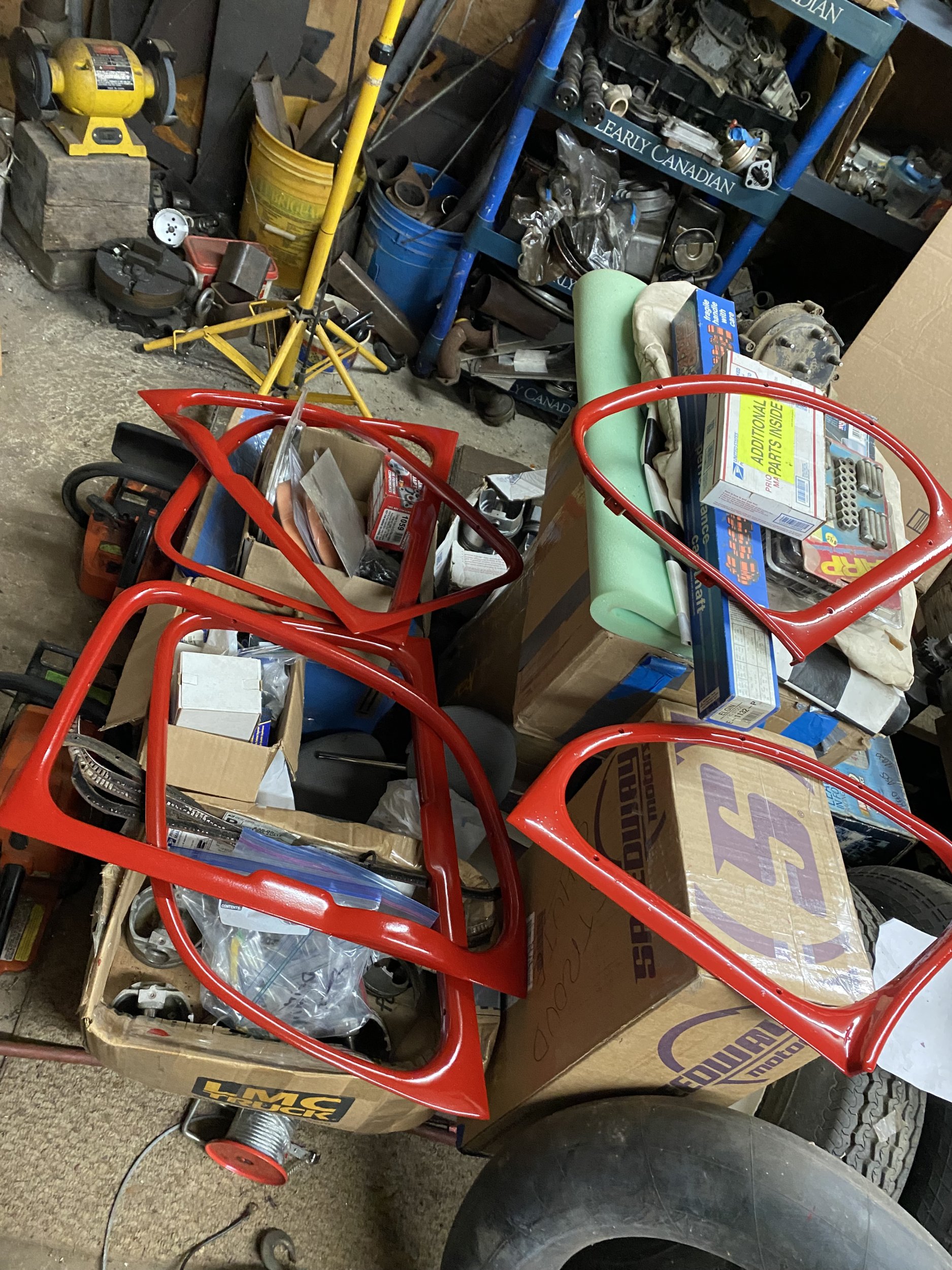

    All painted now. Let them sit a cure. Not perfect but then again nothing else on this car is either. IMG_3003.jpeg IMG_3004.jpeg
