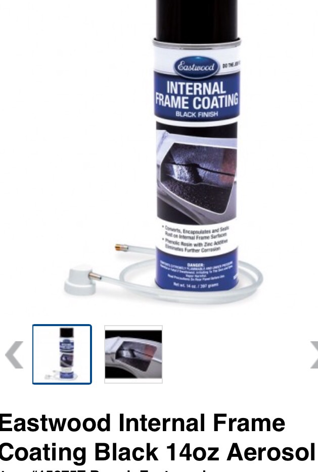

    I like your idea, I've used a 3m matte black coating years ago with the same rocker Schultz sprayer under the roof panel & in the trunk of my long gone to Sweden, Chevy II , on our 53 everywhere all over I used Eastwood internal frame costing it ain't too bad either. Good thread topic. Flux

    That KBS DOES come with a wand for the 17 oz. spray , doesn't it?
