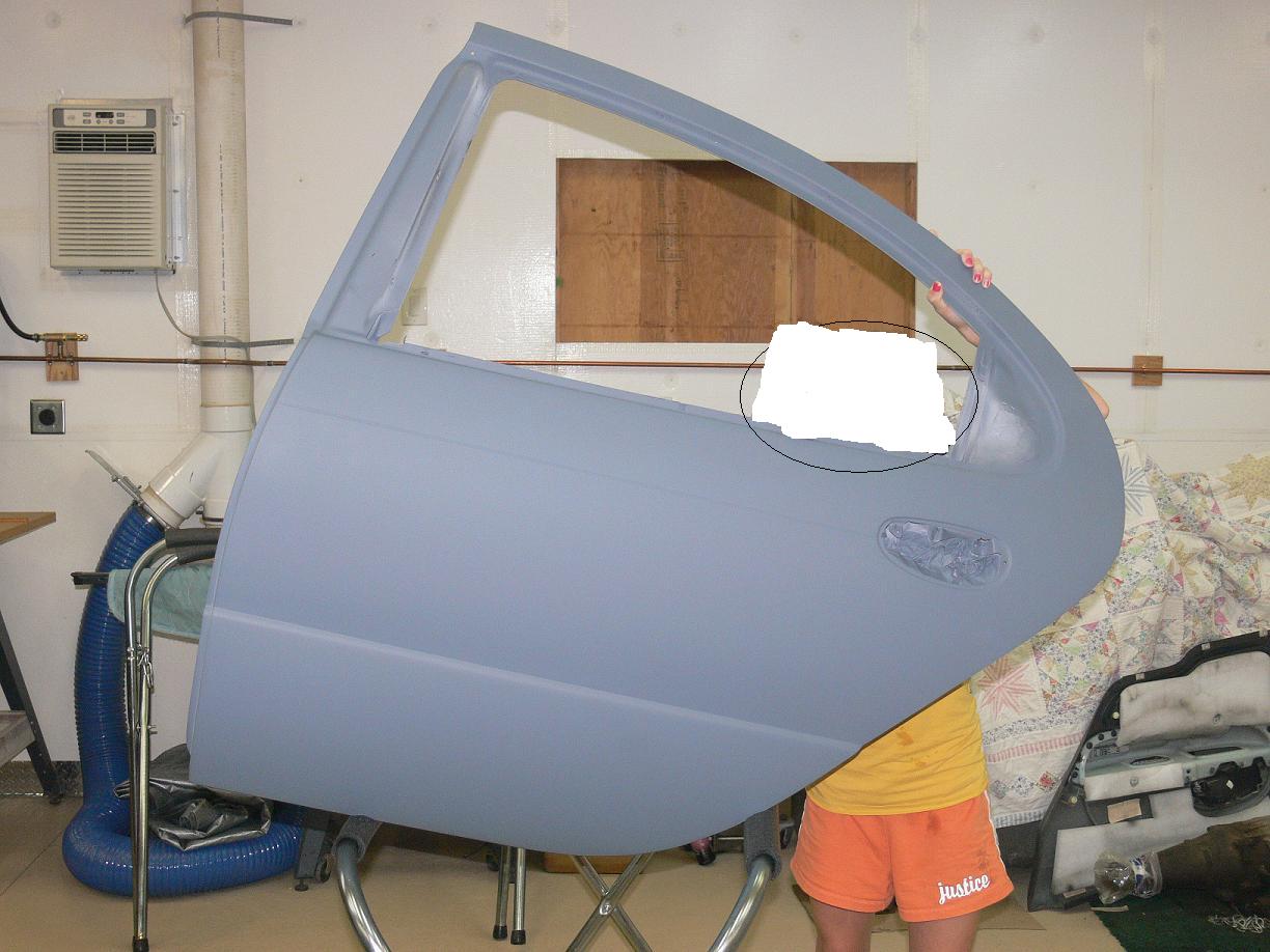

    I know this is an old thread, but I found it a couple of months ago when setting up for painting and it really helped out. I had painted many years ago when a Binks JGA502 and Single Stage Enamels were the way to paint. Old technology in both supplies and tools. Fast forward to HVLP and paints that can kill you dead quick. I had purchased the compressor and the Iwata guns to get me going. Once I read this thread I figured I had to give Jerry (Camarokid) a call. Either he was really full of it or knew his stuff. After talking and eMailing him, I set up a dedicated air line as he described with the Devilbiss high flow couplings and no reg on the gun. The atomization on the paint is incredible! I have another line with the Milton High Flow V couplers and I tested it out to see if there was a difference. There was, so I figured Jerry knew something about painting and so I would keep bugging him until the project was done. The project was a 300M that a friend owned and his wife backed into the door. I told my friend I could get a junkyard door and paint it to match. Let the fun begin.
    The door was rougher than I imagined and I had to start at the very beginning. Many eMails on the process and Jerry told me the right way to do it. As I told him, I’m too old to waste time trying to figure it out – so I asked his advice and he basically walked me through the entire project. I had read horror stories of people seemingly doing everything correct and winding up with a redo because they played junior chemist and mixed the wrong stuff, didn’t wait long enough between steps, used several paint systems on the same project and ran into compatibility issues, getting stripes or mottling in the paint, etc… This is why I took Jerry’s advice and followed his instructions to the letter. It worked out very well.
    I will let the pictures do the talking and you can judge for yourself. I have not painted anything in 20 years and this was basically a novice attempt after being coached by a professional over the internet! And you thought internet dating was rough :)
    The final word is that Jerry did not have to help me or could have stopped at anytime or not thought through what he was telling me just to get me off his back. My opinion is that he knows what he’s doing, can teach it, and had a great deal of patience for putting up with my newbie questions. Is he God’s gift to the Paint world? I don’t know. But what I do know is that he spent a great deal of time helping an individual he never met and stuck it out even when he probably thought I was hopeless.
    Thanks Jerry
    This 300M door is for you…..
