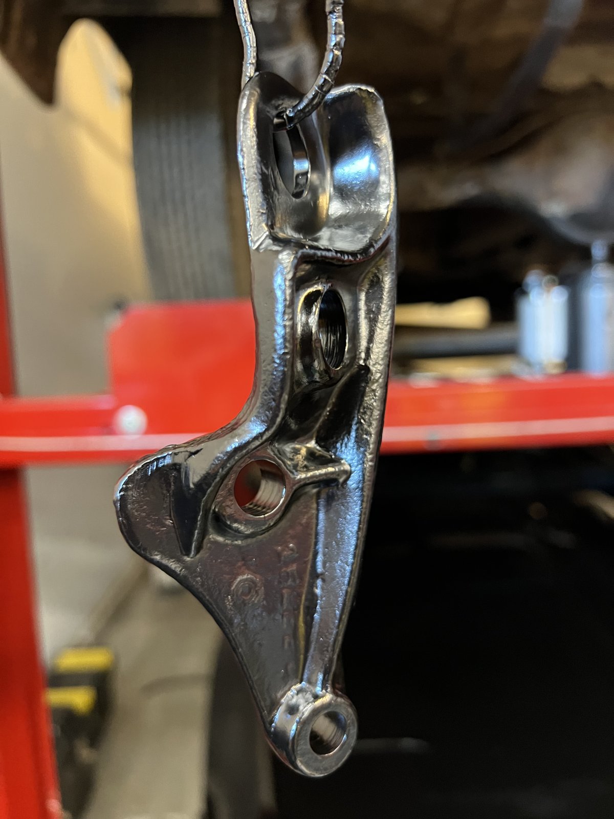

    I go through over 50 cans a year. I lay the parts on cardboard outside. The parts aren`t so small. DSCF0027.JPG
