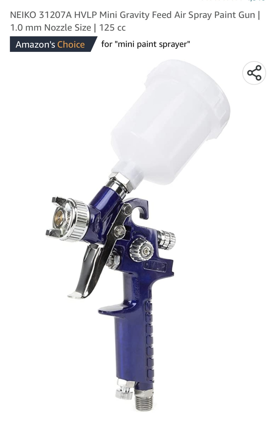

    Those little gravity guns with the 1.0 mm tip have been my most versatile gun for many years. You can use them for small parts up to maybe a fender size. They really save on material and perform well down around 10 psi. I seem to use my 1.0 mm guns more than big ones.
    Packrat and indyjps like this.

    I try to spray everything with a gun. I know everyone is gonna do what they do anyway......
    1) rattle can paint is so regulated for VOC's, it's barely paint anymore. Exceptions: having it loaded at the paint store - but it has no hardener in it. Buying from specialty company- but it's 20 or more a can.
    2) Enamel is very forgiving, Splash of paint splash of thinner couple drips of hardener, it's fine for small jobs.
    2) brushing with thinned paint works well. Good brush, it flows out.
    I brush thinned epoxy primer on any weld areas at the end of the day, it's all going to get sanded again. I'm one guy, not a production shop.
    3) cleaning an HVLP gun is not a big deal. Purple guns, I'll flush with gasoline, then do a final rinse and spray out with proper thinner.
