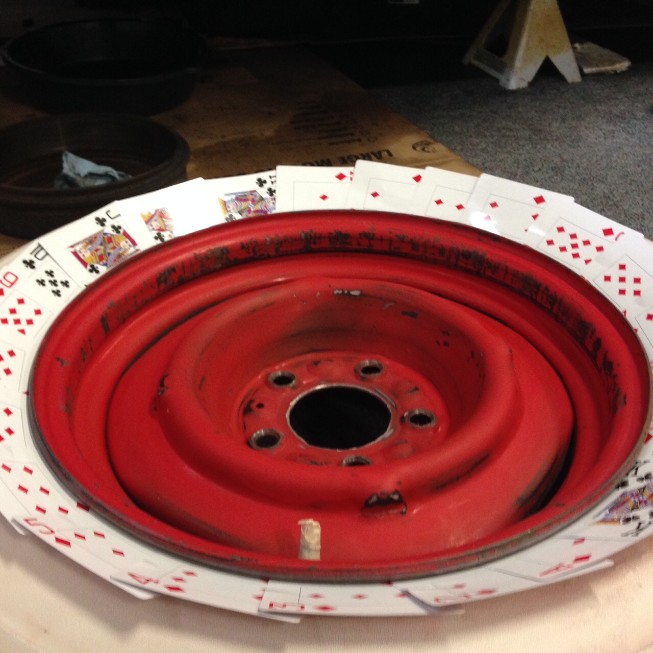

    Is there a crack in the first rim at about 8:45 position ??

    Oh good eye! It seems to be a notch someone must have made into the rim. Why in the world I'm not sure, and when and where. I don't know the history of those steel rims as I got the car with them already.

    That's what happens when some bonehead tried to remove an old tire from the rim without a tire machine or s****s. The steel bead band must be cut to get the tire off and it's almost impossible to get at it with a saw without making a cut like yours. It'll probably be just fine, but if you have occasion to remove the tire be sure to weld it up before putting the tire back on.

    The notched rim thing... someone tried to cut a tire off it with a sawzall. Don't ask me how I know...

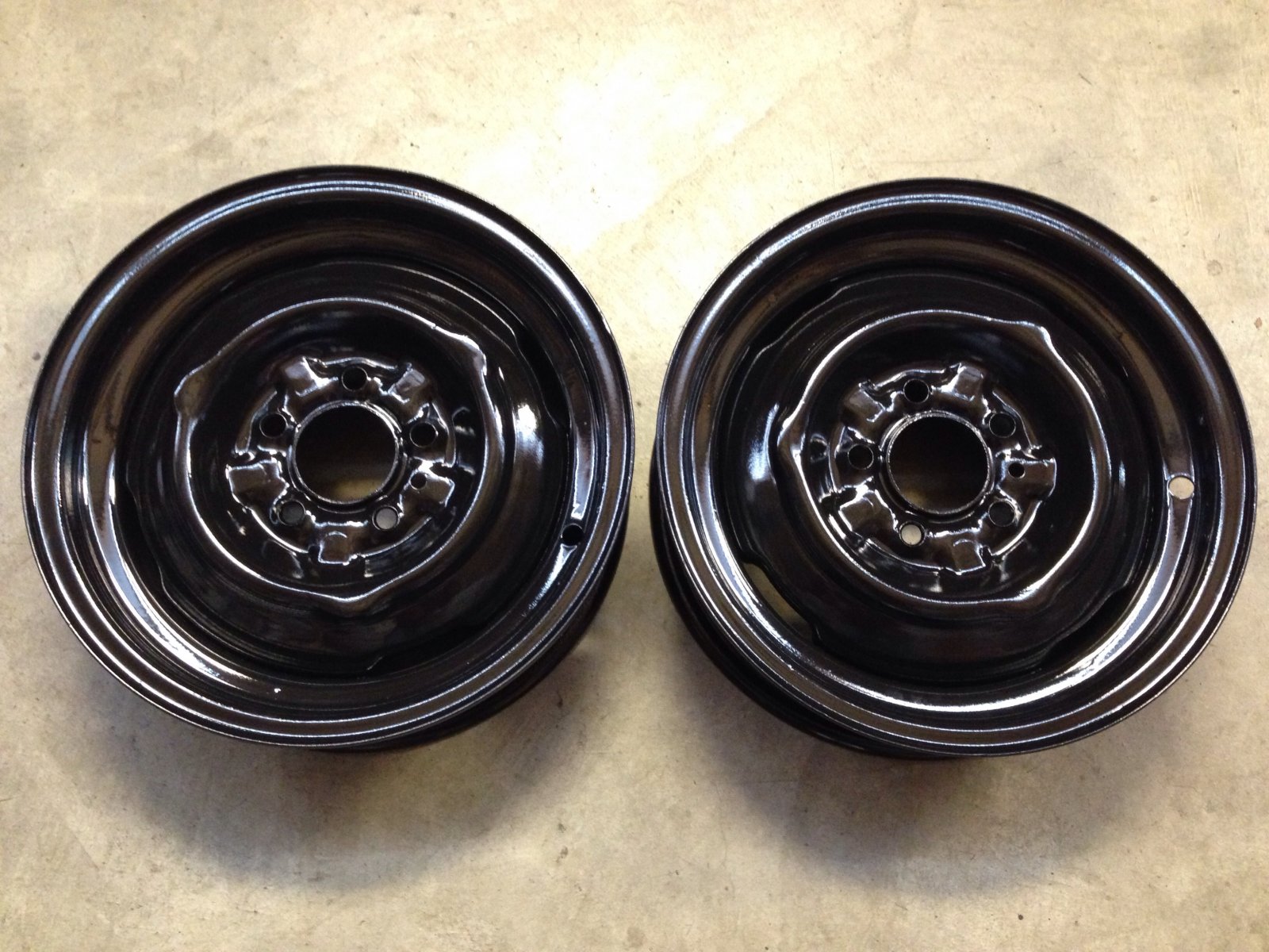

    I've Krylon'd many sets of wheels, just be aware that rattle can paint does't have hardeners in it but they will turn out nice. Not nearly as durable as hardened paint. You can buy rattle cans from an automotive paint store with your chosen color that have a hardener capsule in the end of the can that you burst before starting to paint. Use all of the paint as any leftover will harden in the can. My local paint place charges $24 a can for it. I used 3 cans for 4 wheels which allows multiple coats.
    Here's some of my Krylon wheels. I don't use clear over them as it yellows. A bonus to using rattle-can is you can mask off and paint the wheel weights to blend in. 2011 06 01 tires 1.JPG 2011 08 05 w big.jpg 2011 09 21 1 wheels.JPG 2011 09 21 d.JPG

  26. If I was going to guess I would guess that someone could not break the bead down on a previous tires and used a hack saw to cut the tire off. LOL

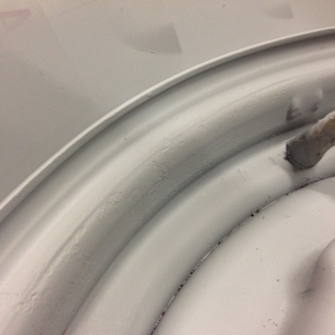

    I made a little progress this weekend. I sanded the rims with 120 grit then did quite a few coats of primer with the Dupli-Color Filler Primer.
    I decided to go with dark metallic burgundy (Duplicolor Bordeaux Red Metallic for Hondas) as I can hide amateur work easier than with a lighter color like gold or copper.
    Does it look like I'm off to an OK start? I'm not sure if I should have sanded or removed the prior red paint to bare metal. I'm about to shoot the color but the close up of the rim shows some of the surface issues. I think it would have been way too much work to get to bare metal. The rims look fine from 5 ft away with my eyes but I'm not sure if this is bad work?
    I was going to shoot the burgundy (a few coats) and then a few coats of clear coat from Duplicolor.
