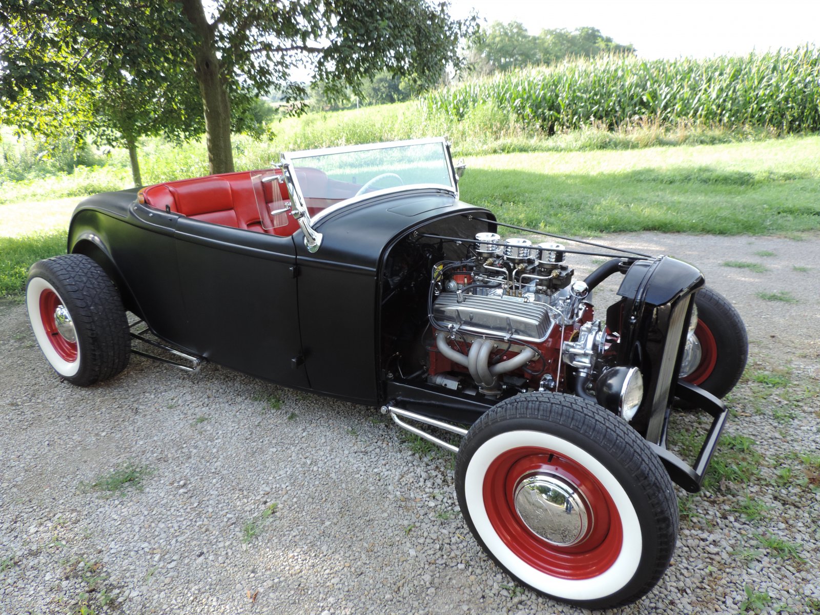

    I have 4 whitewalls on my roadster and one tire is bulging and I just don't want to spend all the money to get 4 matching tires again. Especially when they all have good tread on each tire. Is there such a thing as painting them or black portal walls? Tires like these are not available anymore. DSCN2648.JPG

    almost works on a fully fendered car, - not so much on a hi-boy……..

    Perspective.....it's all about perspective.
    That's what, a 20-30K car? Maybe More?
    I think I could swing $1000 for a new set.
    Some cars it may be appropriate decorate in "Early American Trailer Park". This roadster is not one of them.
    Then there's the safety issue. I'm with Moriarity, bais ply. Whatever you do, new skins all around.

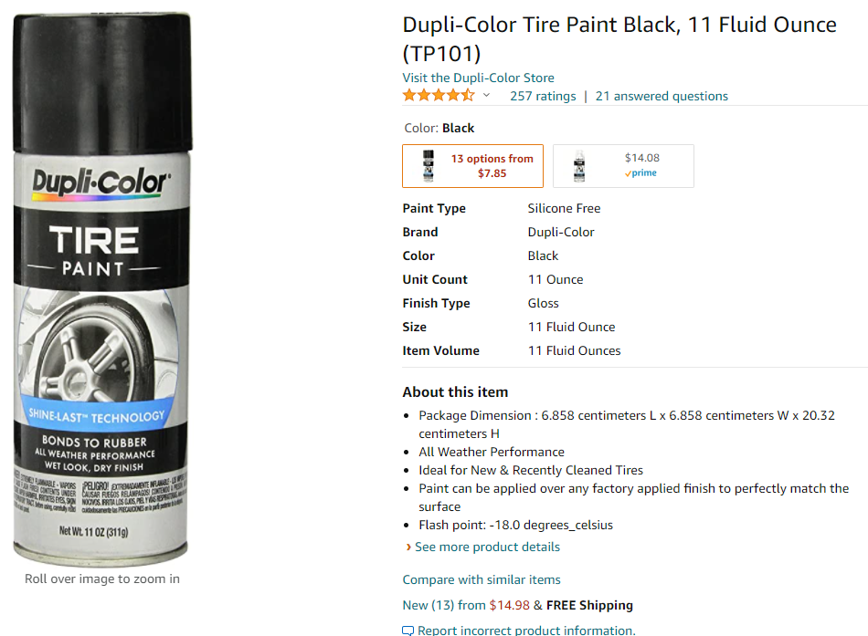

  22. Bandit Billy
    Joined: Sep 16, 2014
    Posts: 15,125
    Bandit Billy
    This is what you use when you have torn up white letters on the POS you are flipping. I have no idea how long it lasts but it is formulated for this purpose.

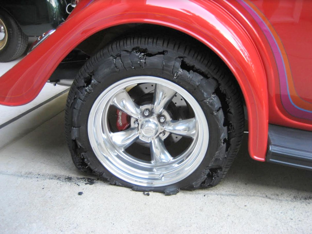

    My friend Doug's '34. Always garage kept, good tread, no checking on sidewalls, etc.
    Fairly low mileage, but more than five years old. Luckily, no damage to him or the car. Screenshot_2019-08-30 flat tire - blakephipps27 gmail com - Gmail (2).jpg
