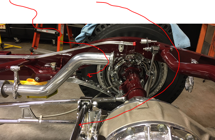

  1. DDDenny
    Posts: 22,151
    Myself and my chassis builder deemed the old standby panhard bar plenty adequate for a coilover car.
    I did need a trunk riser for clearance due to the design and ride height.
    He did suggest adding an anti sway bar if I had issues, I chose to be proactive instead of reactive.

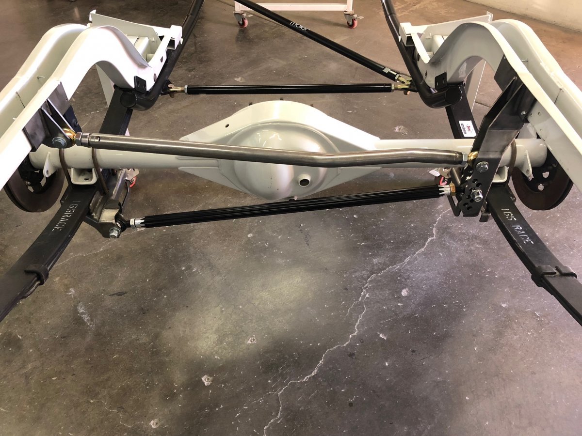

  17. gimpyshotrods
    Joined: May 20, 2009
    Posts: 24,487
    gimpyshotrods
    Adjustable panhard bar, and leaf springs.
    I have this on the back of my Falcon, it not only does not bind, it works very well, and keeps my tires from hitting the wheel houses.
    Roadsir, gnichols, JUNK ROD and 7 others like this.

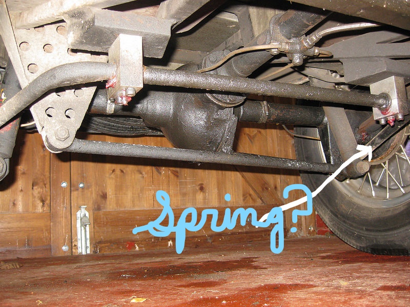

  18. Stueeee
    Joined: Oct 21, 2015
    Posts: 314
    Stueeee
    from Kent, UK
    Yes, quarter elliptic springs on the rear. transverse semi elliptic on the front. My avatar car is a 1932 Austin 7, the UK model that the American Austin was based on, I believe that the later Bantam had semi elliptics on the rear.
    As the Panhard bars are quite long on my car, and are parallel to the axle when the car is loaded, any sideways movement of the axles with suspension travel hasn't been noticeable on the road (or race circuit in the past)
    HOTRODPRIMER likes this.

  22. HOTRODPRIMER
    Joined: Jan 3, 2003
    Posts: 64,646
    HOTRODPRIMER
    This is what I want to do. HRP
    Montana1 likes this.

    I have never seen this done before quite like this. It's a great big Jacob's Ladder -- a large version of the small ladder used on current sprint cars. Nice job.
