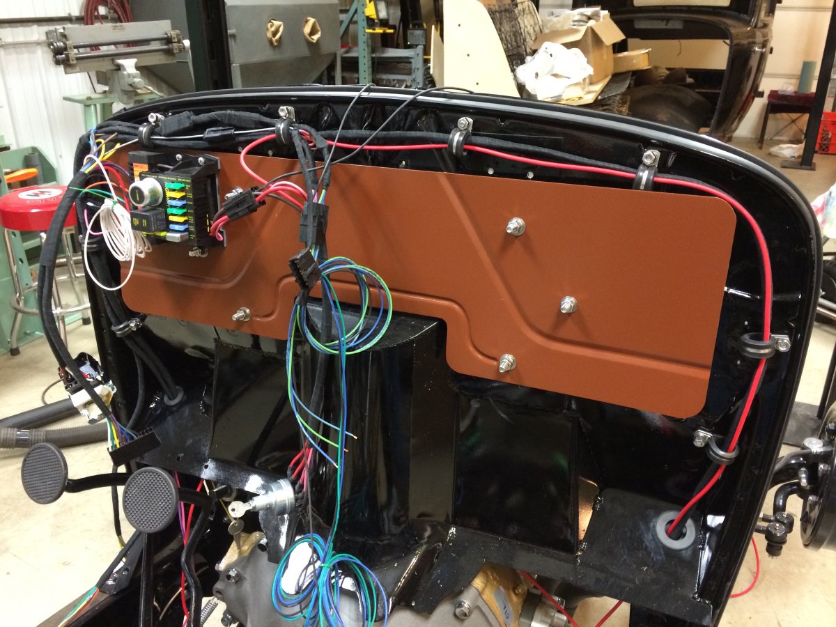

    My roadster has pretty basic electrical needs so the actual fuse panel is very small, I made the mounting panel bigger than I needed for future add-ons, glad I did as I decided to mount the MSD box on it. I used a large bakelite coated wing screw for quick servicing.
    The small black unit in the lower right is a master fuse. There are a few specialty automotive wiring suppliers on the internet that carry some handy components like the master fuse and junction/ground pods, but its been quite a while and I forget their names.

    Here a panel I made. I used original firewall holes to mount it. Spaced it back so I could insulate behind it.
    I also welded bolt to the ch***is before I painted it. I used this as a star point ground for the starter, battery, a 10 gauge ground to an aluminum block under the dash. A little overkill but that how I usually think.......

    I thought ahead and welded a bracket to the dash that my fold down fuse panel bolts to. That aint a hell of a lot of help now but I suppose panel adhesive, the good stuff that auto body shops use, would work. I sure appreciate the fold down feature, handy when you have to work on it, invisible the rest of the time.
    Make sure you make the panel large enough to hold the fuse panel and all of the relays you are using. You sure are building a nice RPU!
