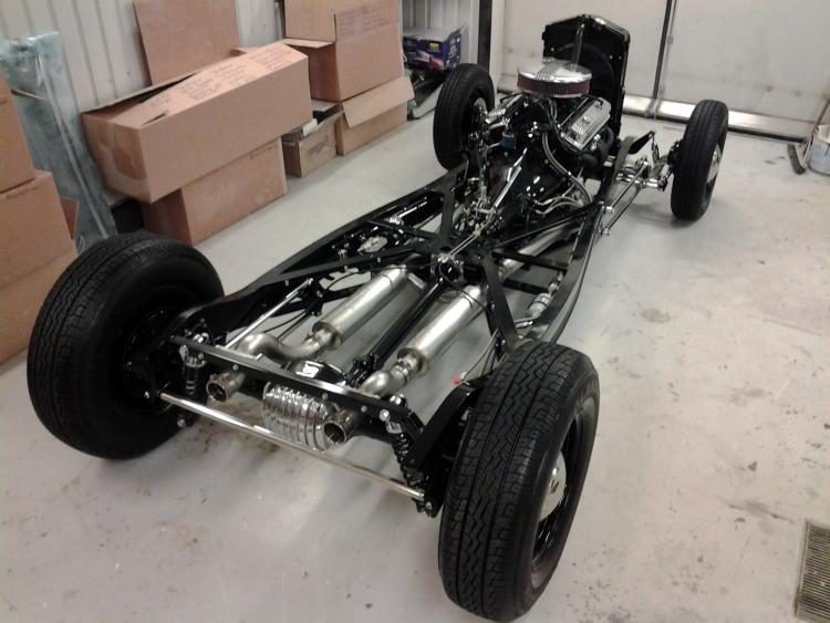

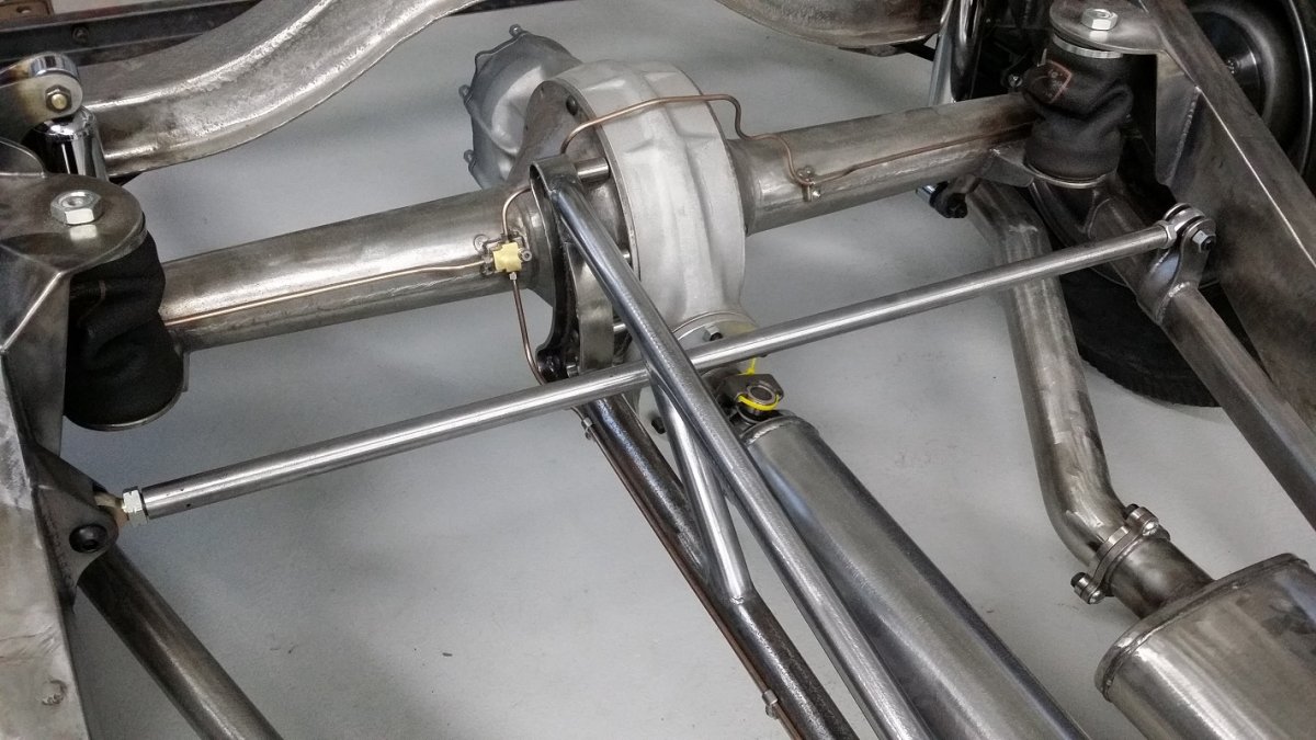

    Check, and check! Bit of extra work to find the sweet spot where there is clearance thru' full suspension travel, but on a low car running skirts the least sideways movement the better.

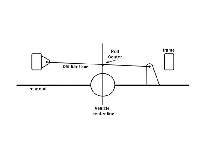

    The reason the pitman should be as low as possible is to lower the rear roll center.
    Pictures show better than words: :cool:
