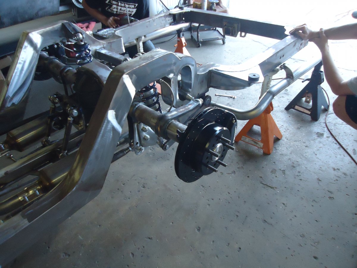

  9. McDeuce
    Joined: Sep 16, 2008
    Posts: 262
    McDeuce
    from Wisconsin
    IMG_0229.JPG Our panhard bar in our Roadster

    As nice as that looks, you may as well run a straight bar across.

    You can not see from the picture angle, but the sway bar is in the way on both side. It was build that way to clear and because it looks cool

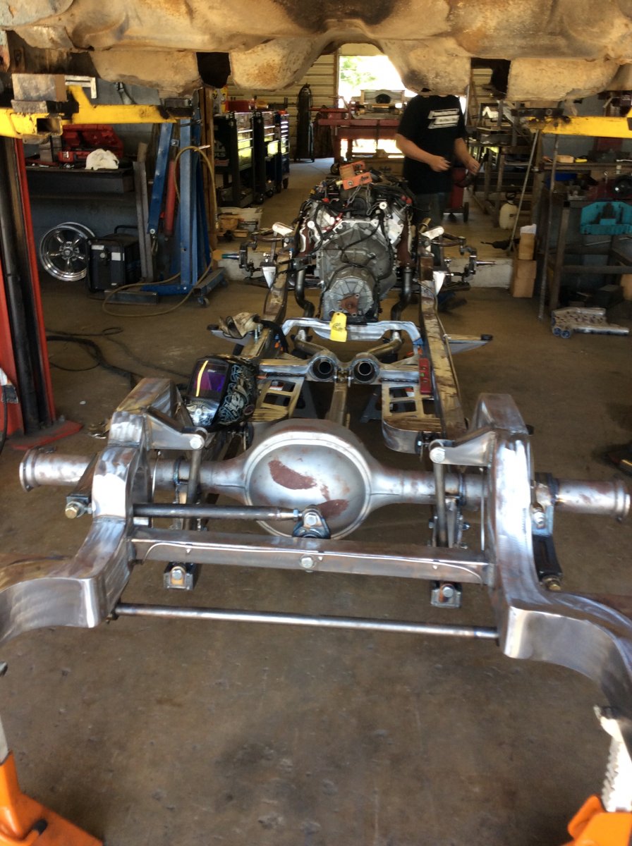

    Atch.
    Yes, Panhard as long as possible & way lower than anybody puts them on Hot Rods.
    You've seen my car handle at Mokan ( or heard about it ), but here is a pic of what is under it.

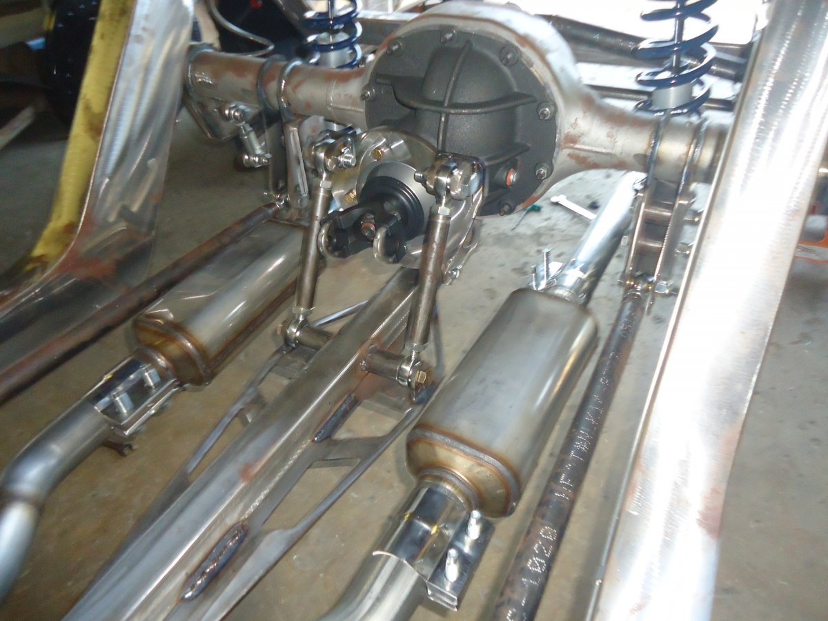

    As far as the Mumford Link, Its cool but not ideal in a lot of ways.
    I needed something for the sideways location of a DeDion rear axle in a ( very much Off Topic) racecar with a mid engine and a Hewland transaxle.
    This is what I came up with ( just a mockup at this stage ).
    Its based on a Mumford, but I think it will give me some advantages over that.
    Its totally unproven at this point, but on the off chance that it works, I claim the name Mac Gillavry Link. :)
    Ned Ludd and Tudor like this.

    That's a great looking setup, but the 2 bolt mounting would give me agita because the forces of the panhard bar will put those bolts in sheer. I'd feel better with a 3 bolt flange. Nice fab work through

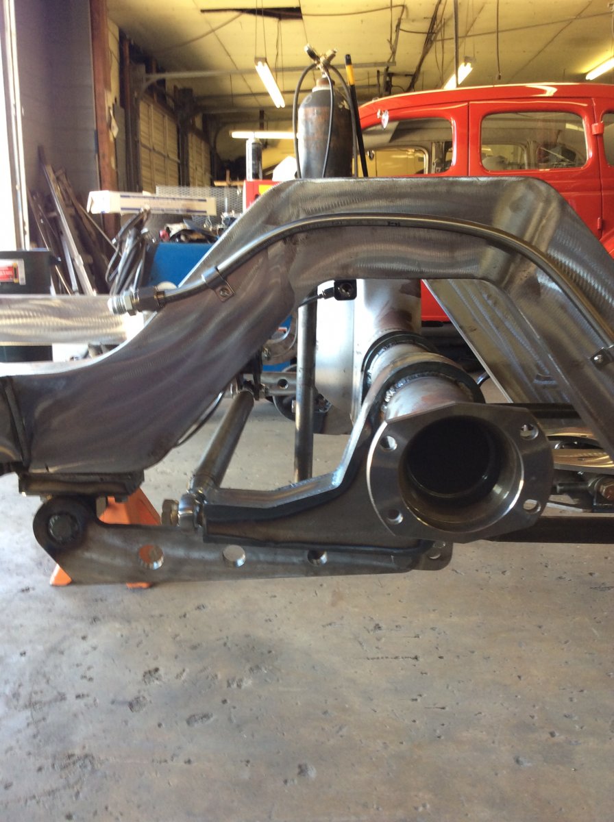

    Using a watts on new ch***is for my wife's 59 Chevy 2 Door wagon . Please over look OT engine. Blue

    Frame looks like scratch build, whew! Lotta work/planning, nice job..Wife must be good to you!
