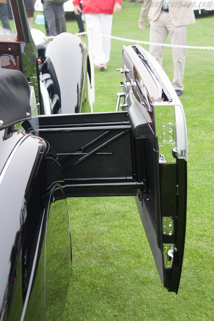

  28. Not exactly what I thought the linkage would look like. Just half a 4 bar laying on its side. LOL Might be cool to use the older Caddy trunk latch idea, that reaches out and pulls the latch closed electrically.

  30. ken bogren
    Joined: Jul 6, 2010
    Posts: 1,057
    ken bogren
    Is that one of the cars from the start of the thread? I wonder if the door is fully open or left out that far just for the photo? Interesting structure to the hinge, the diagonals must be to keep the door from sagging hwen open, right?
