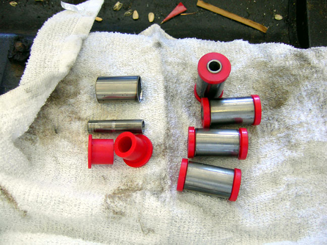

    What about some urethane bushes like these:
    Muffy Bennett likes this.

    I can imagine soft bushes deforming over time and messing your door gaps up.
    When I look at the steel tubular hinge structures I'm reminded of bicycle headsets, where the fork goes through the frame. Those are cheap, easily available and use ball bearings.
