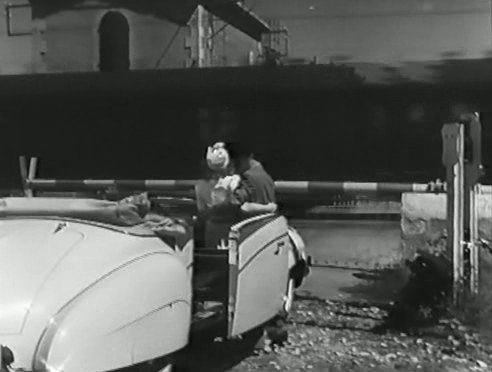

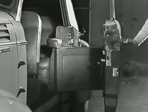

    I'm amazed at what the internet has done for research. These stills are from a movie made in 1941 featuring the Graham. rivers41embus57.jpeg rivers41embus19.jpeg
    mgtstumpy and Okie Pete like this.

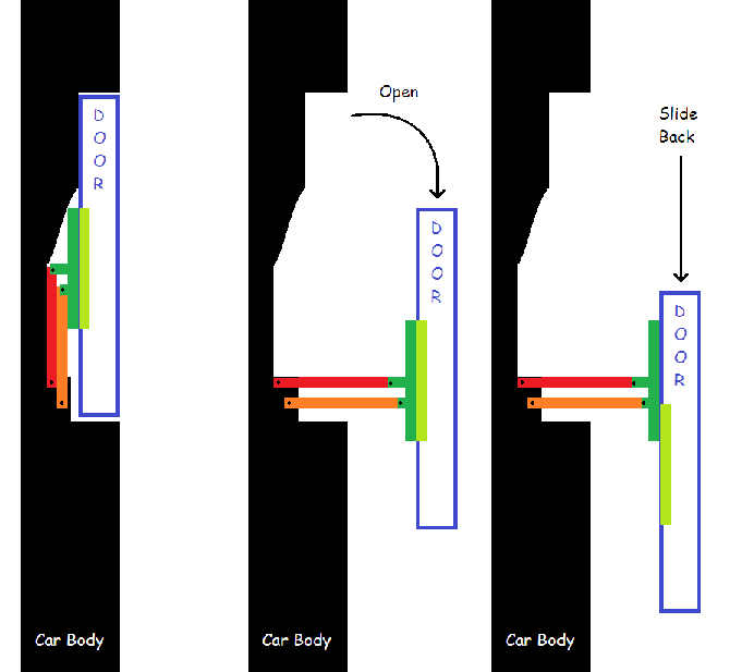

    What if, in addition to the pantograph hinges, you also attached the door to some drawer slides - so that it could slide back along the body a little?

  23. wsdad
    Joined: Dec 31, 2005
    Posts: 1,257
    wsdad
    Or, instead of the sliding door, you could put a spring-loaded hinge on the door so that once the door opened as far as it could on the pantograph hinges, a person could then swing the door open a few more inches at the front.
    Sorry, don't have time to draw this one out. I have to go to work.
    Don't get me wrong. I think the pantograph hinges are cool enough by themselves. And, I don't know if what I'm suggesting is possible, a good idea, or even cool. You just got my wheels turning so I thought I'd share. Thanks for letting me build vicariously through yours until I can do it myself one day...

    After thinking about the sliding pantograph door a little more, I think I just duplicated a minivan door. I still like the pantograph - spring - hinge or BMW hood idea.
