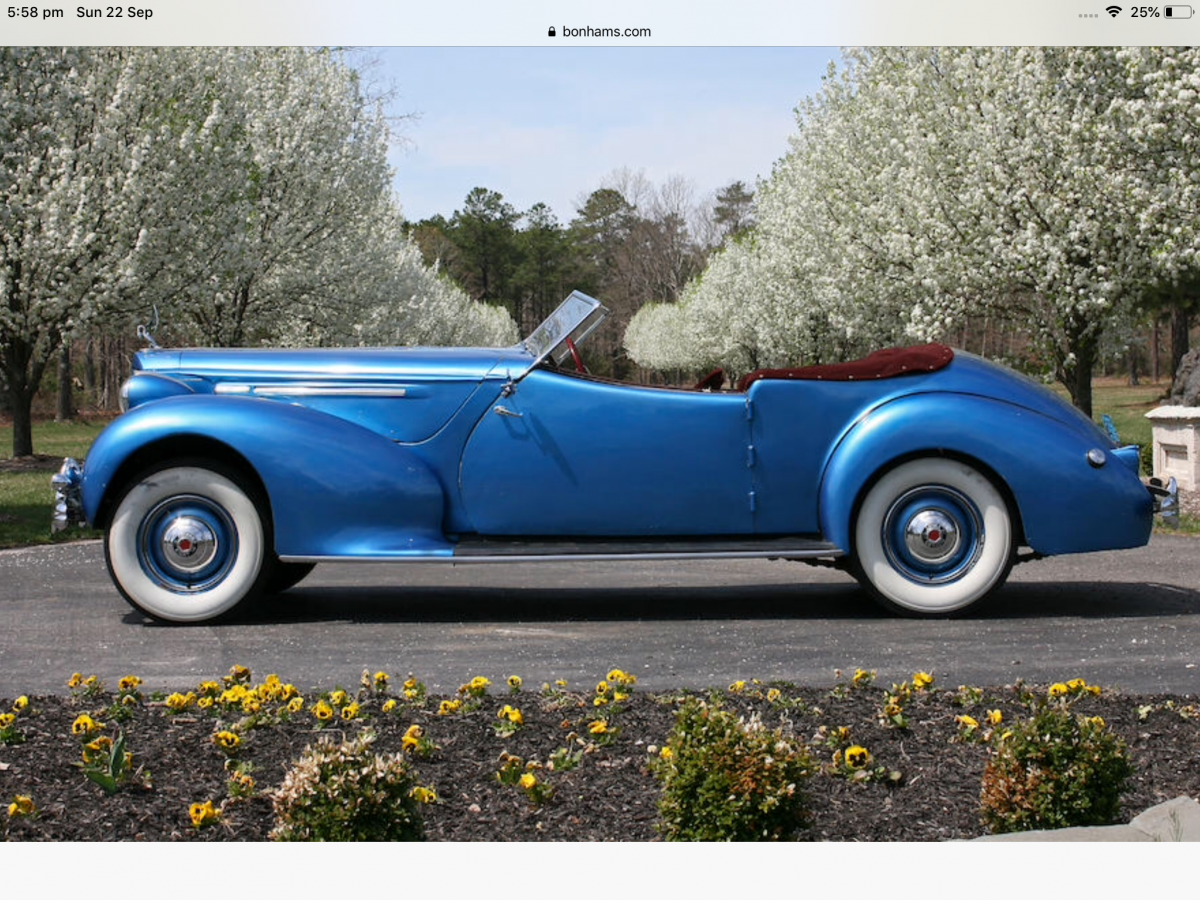

    I haven't checked in on this thread in awhile.meanwhile,I stumbled on these images by Jan Stroman.1938 Buick with Nordberg body.Supposedly the mechanism was patented by James young. 12510237_10206526289850901_279589189902046731_n.jpg 12417597_10206527367037830_7908906322584548969_n.jpg

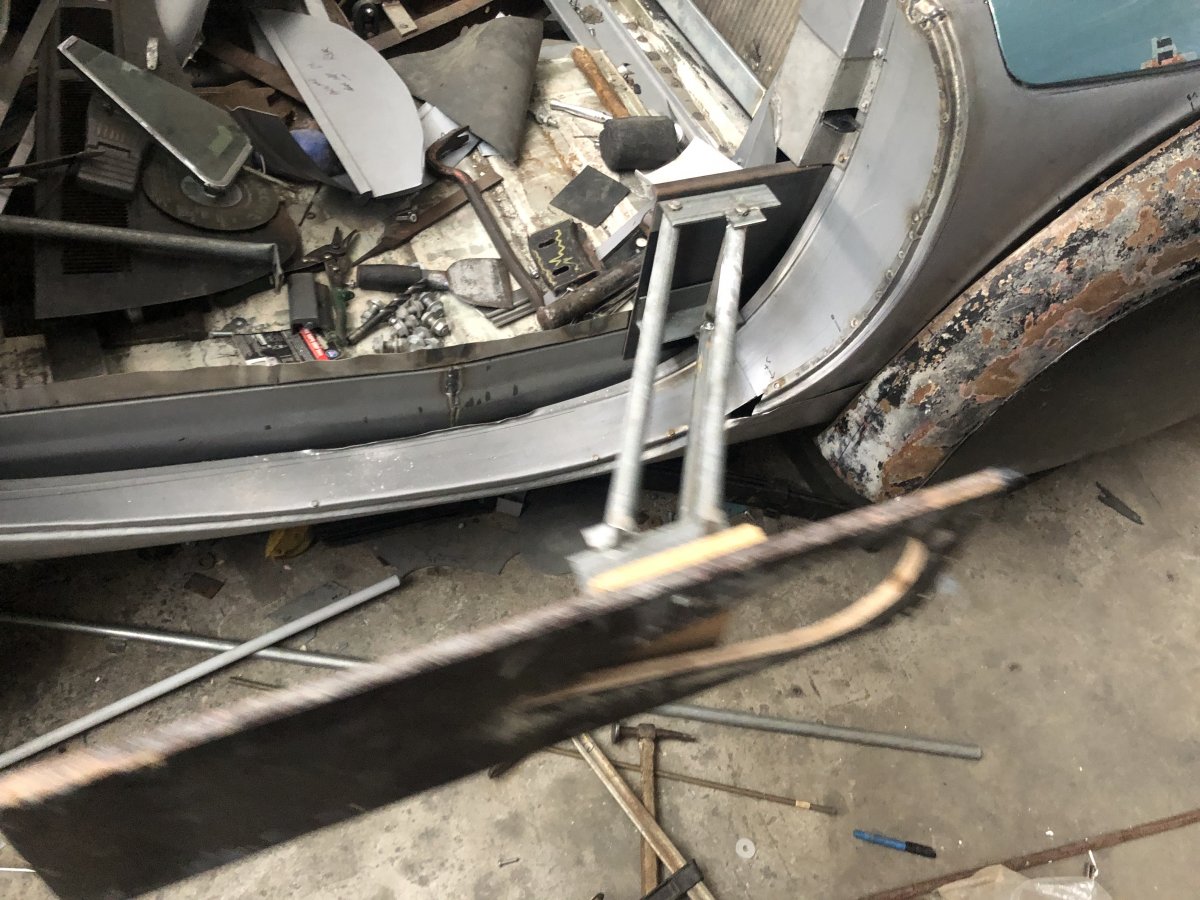

    Well the pantograph doors never eventuated on the 39 Cadillac but the itch hasn’t gone away.
    Since my divorce and the ensuing inability to touch my Cadillacs for 3 years whilst the property settlement went through the Courts and financial turmoil that it brought about, I played with the boattail project and built up a parts pile, which was cheaper than a the****** and better therapy, for another Model A roadster. It kept me sane over a very difficult time.

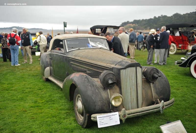

    So a few weeks ago I answered an ad for a dilapidated 39 Packard 120 sedan. Despite the $2000 asking price, which I didn’t have I asked if he’d separate the box for $500. The answer was no..... so I left it. ( I have a fully rebuilt 39 Packard engine scored for $200. It was planned for the boattail.
    Then I got a text saying the box was mine.... so long as I took the rest of the car.
    It’s rugged. The body is stuffed. But the ch***is is good and the radiator, cowl, guards and trinkets are all retrievable. So suddenly I started the idea of a custom Darrinesque body.
    The first lament of original Darrin owners is that the doors swing down and great care is needed not to hit the curb with the doors when alighting. So I guess you can see where this is going.
    I’m working on on a mate’s 260z in his heavy steel fabrication shop where they make buckets for end loaders and tractors. I showed John the hinge design. “piece of piss” was his reply... that’s Aussie slang for easy to do. So I’m gonna line John up to laser cut the bracketry and cowl support and B pillar supports and once I section the 2BF8FB20-A4EF-4191-92EA-AAA9082EF6AD.jpeg g 6D90F0F3-F5CA-4E09-85E7-7534D6D1C027.jpeg support and cowl 3 inches I’ll be away.
    Taking on another project is madness, but after the past 4 years of madness that I’ve endured, I know I have to do it.

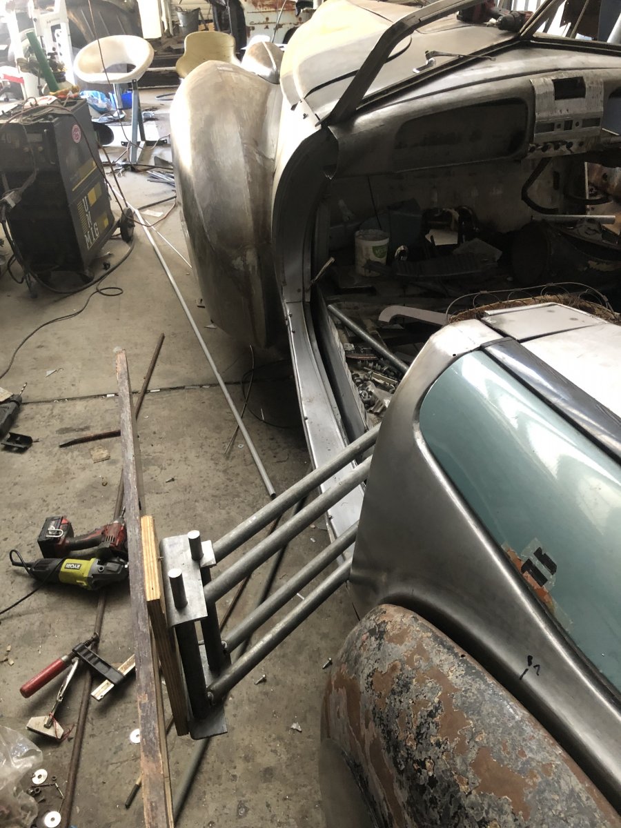

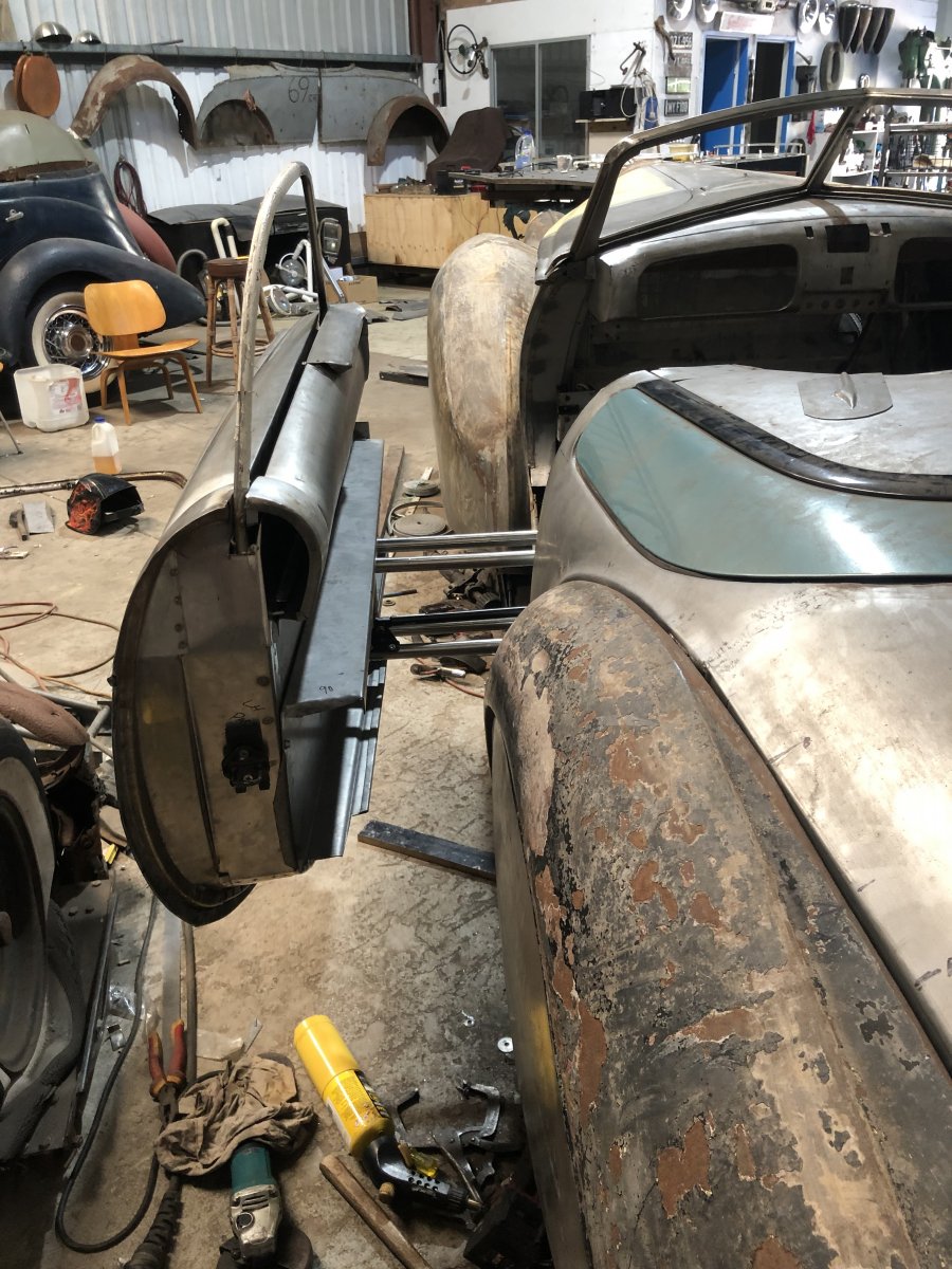

    10000832-6930-4622-8B19-32CCC30DDF6B.jpeg C9468FA7-7695-4AA6-9984-104F7E4ED103.jpeg 5CC50FC0-5178-474C-994C-E236A59FFA74.jpeg CC16319D-0D36-49C2-8B92-FE64376A0879.jpeg 50CA5DF6-08E6-4C58-BCFD-2C1A34C47540.jpeg They said it couldn’t ... or shouldn’t be done.

    I knew you had to...if it was the last thing before you die, you were going to do pantograph doors on something!;)
    Sure looks like it will work, you've been busy (no text messages?)
    Will window gl*** fit all the way down?

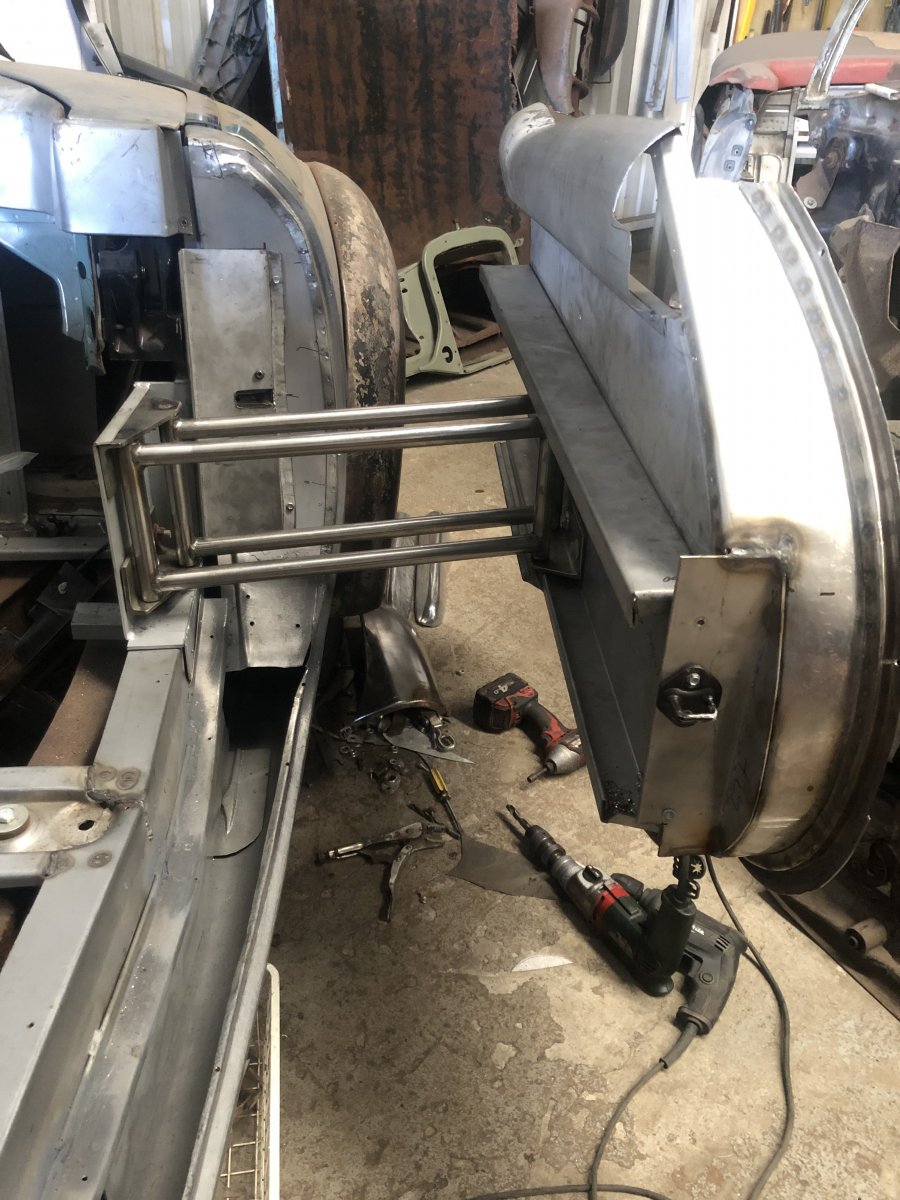

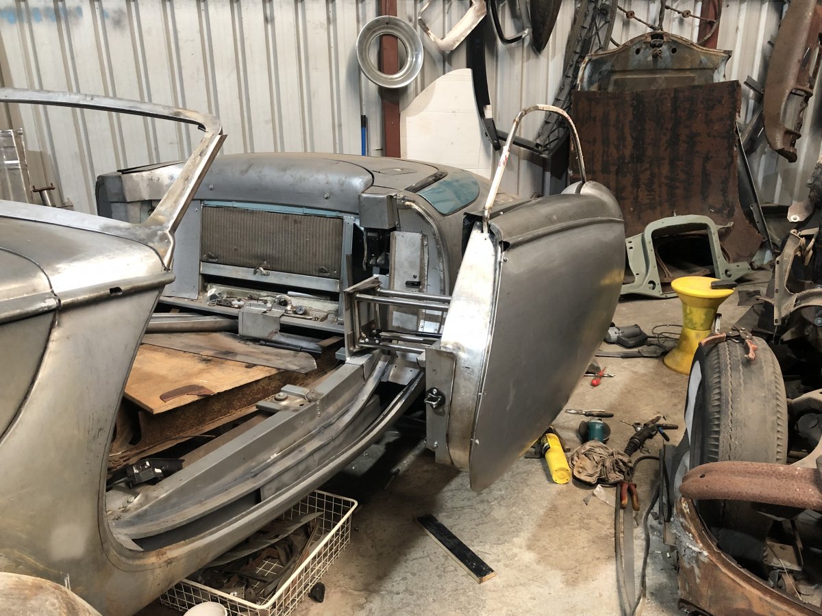

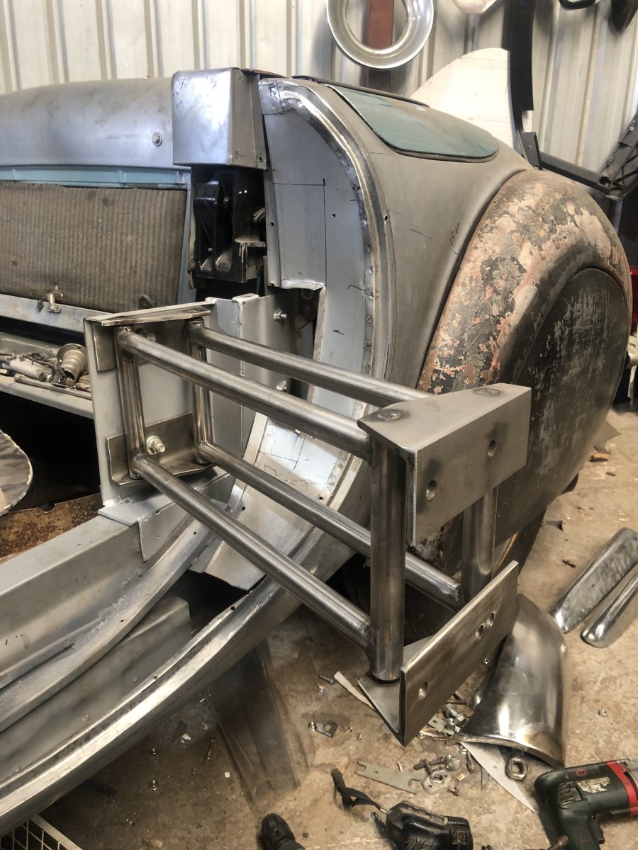

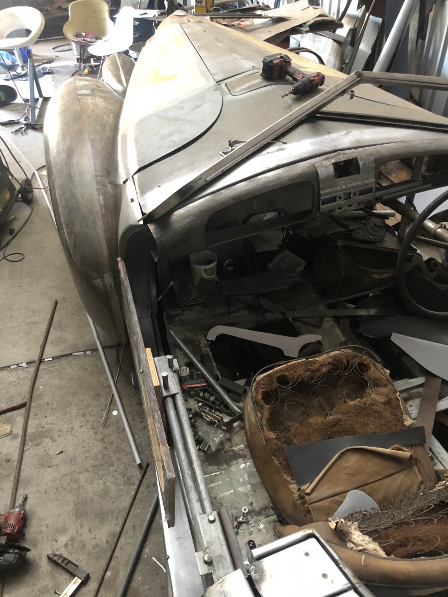

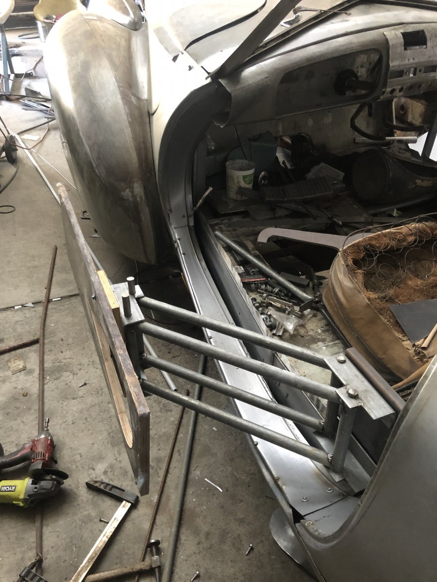

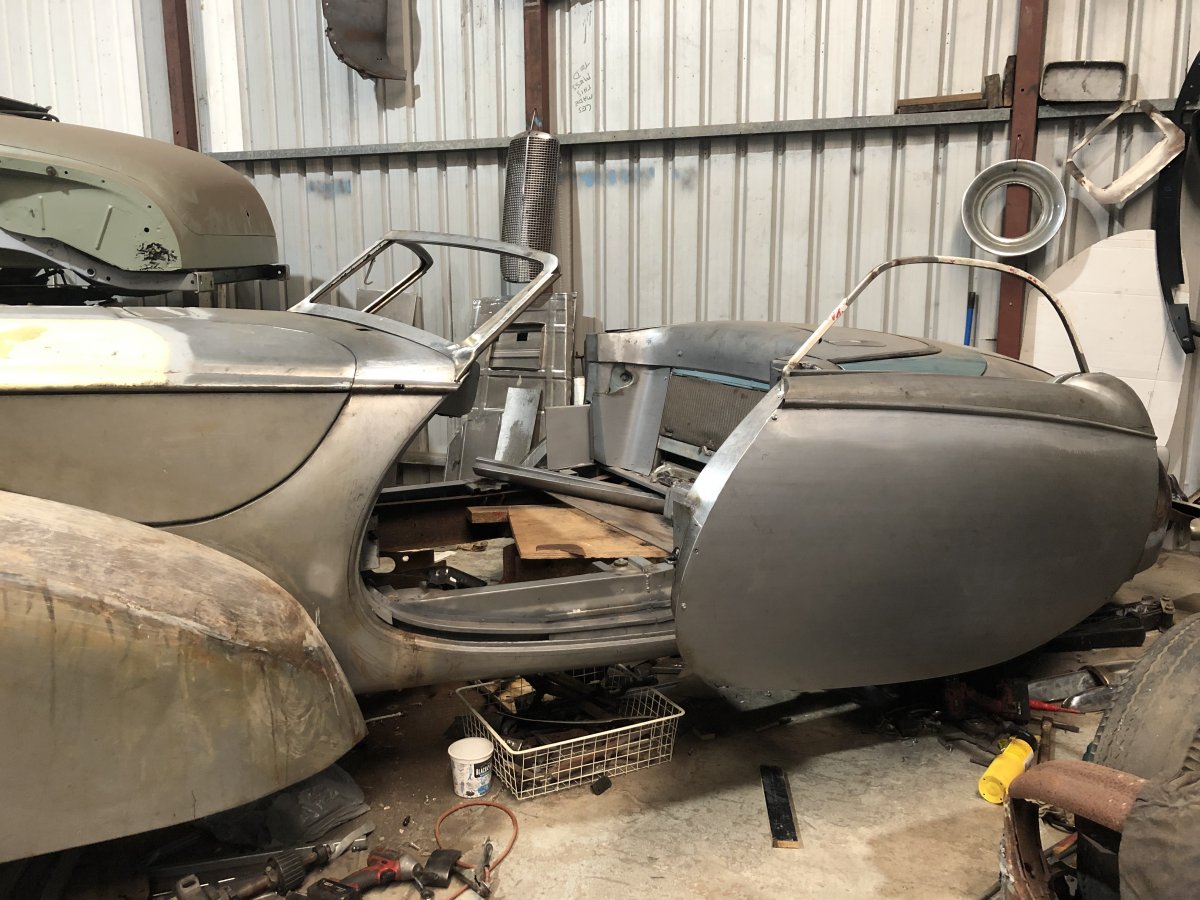

    75F096B3-1750-4B9E-8AAB-B504B5C7F922.jpeg 9996AAFE-5A08-400A-B378-C2A4A32D5AA0.jpeg B1AC5EF3-475F-47B3-BEFE-E97B4241B8BD.jpeg 94FA49FB-C693-420F-83EC-B0B9C8EACE6F.jpeg 4E623959-9E9D-4BF6-AC8E-2011CD883776.jpeg Door is skinned and fully operational now. The pantograph hinge allows for a oval shaped door which wouldn’t be conceivable with traditional hinges. The locks placed at either end provide a positive positioning and location of the door and allow easy adjustment. The long door ( over 4 1/2 foot long ) is effortlessly supported throughout it’ travel . 84675527-11FC-4C04-B2D6-14EDE9613D61.jpeg A70BFF40-5C31-467B-9254-E7C033D73748.jpeg

    Wow, really impressed with the engineering on this..

    Just came across your thread and I must say you sure made that look easy. Your car and all the hand made components could keep me entertained for a long while. Well done sir!

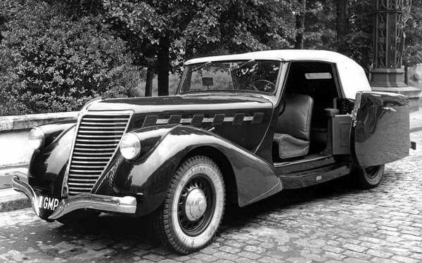

    CadMad

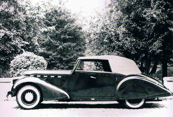

    F4029494-AC57-47D7-9979-928AAF388A0A.jpeg Found another pic today previously unknown to me . 1939 Renault. I’m ***uming it must also be Saoutchik as they held the patent and the armrest detail looks similar to the 1938 Graham

    Two other views from the same shoot:
    With general König in 1944:
    I've seen the car listed as a 1937, 1938 and 1939, but the GMP is part of a 1937 British registration. The seven digit number in the 1944 pic is a French military number.
